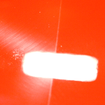

What does "marring" mean and what does it look like? I was polishing my car yesterday and on the last panel my polish got sticky and acted like glue. is that marring? if not what is it?

Micro-marring is a haze that appears on your paint when you use aggressive polish or aggressive pads. Or when you mix an aggressive polish with a light pad, or a light polish with a heavy pad (I found this out the hard way... Hehehe)

Gamedog did a good job describing how a common way micro-marring occurs, but mis-matching the aggressiveness of the polish or pad. Essentially what it looks like is mini swirls that are on the surface. Here's an example of what the marring looked like after I used a purple foamed wool pad with a rotary buffer (I tweaked the exposure to help amplify the marring):
You can see to the left of the line there is marring from using a very aggressive pad. The right of the line was after using a finishing polish to remove them.
