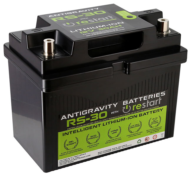

I was hoping to make it through one more winter with the original battery, but I had to leave the car outside overnight at work the other day when it dropped below zero degrees. It almost started up last night, but ultimately needed a jump start as it was probably frozen solid. This morning I put it on my trickle charger I had left over from my M3 and now the battery seems ok. I will probably hook it up to the trickle charger again later this week as we are supposed to have a couple evenings of sub zero temps.
Antigravity is supposed to be releasing a new ultra light lithium ion battery better suited to cold WI winters this year. Hopefully, I can make this one last that long.

You could look into the shorai LFX36L3-BS12. I've been rocking that one daily for a little over a year with no issues. When its below freezing I do have to turn the headlights on for a few minutes to warm the battery tho.
