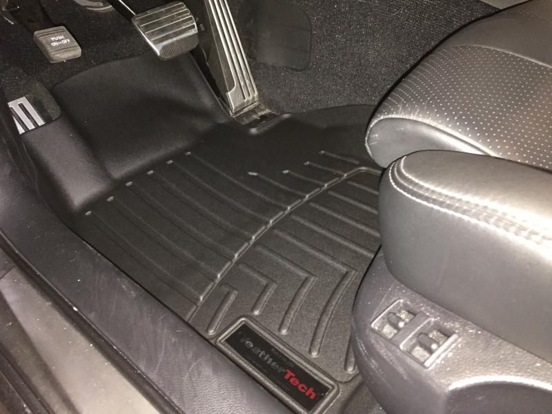

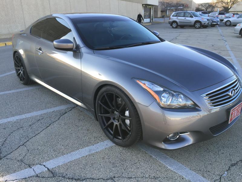

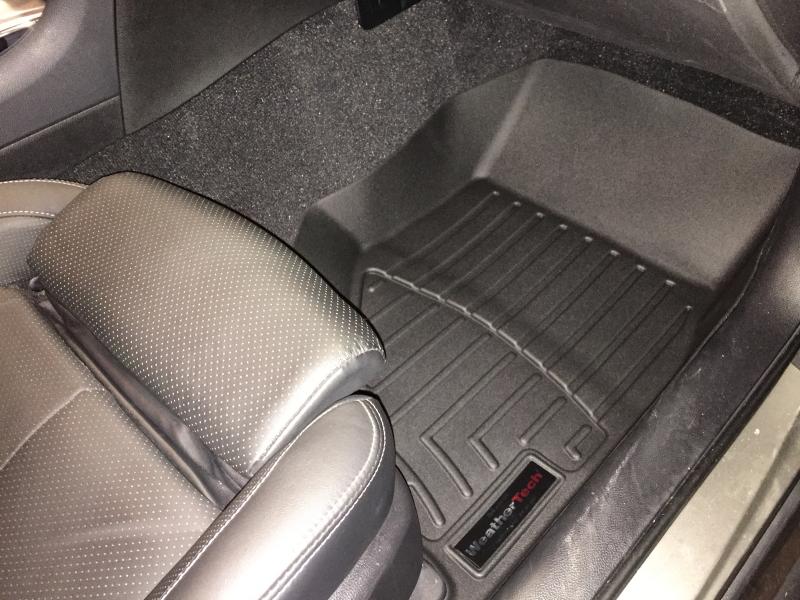

I had some time to get my Forgestar CF10 Wheels installed. I went with Continental DWS tires and had my car aligned at Touge Factory. Also, I put in some WeatherTech floor mats.

Nice updates
Like the look of your new shoes, what wheel & tire specs are you running?

I went with a setup I don't really see much of around here. I didn't really want a square setup appearance wise, but I wanted to run the same size tire all around for snow performance, AWD performance, etc. I am not a big fan of running 10.5" wheels up front either.
Forgestar CF10 Rotary Forged Monoblock - Matte Black
Front: 20x9 +28 Semi Concave
Rear: 20x10.5 +35 Deep Concave
Continental DWS 255/35/R20 all around
I don't have any rubbing with this setup (no bracket trimming) and I feel like it fills the wheel wells nicely without being over aggressive and requiring trimming, poking, or excessive camber. The AWD system is happy and the car handles great in the snow with the DWS tires all in the same size. I also didn't want to run super wide tires since I plan to run these wheels year round. Continental DWS tires are light, only 26 lbs in this size, and the wheels are light as well. After removing the stock wheels and tires, along with spacers, acceleration feels slightly better and definitely not worse with the 20" setup.
I would recommend this for the AWD guys looking to run wheels/tires year round. I am running factory alignment specs.

Interesting setup, I'm curious how different your rolling diameters would be front to back, backs should be a bit smaller but how much
As long as your AWD isn't lighting up should be good to go

My research before purchasing this setup suggests that the rolling diameter should be a 0% or negligable variance. This is due to the fact that the tires rolling diameter is determined by steel belts which do not necessarily change size when put on a different width wheel. I specifically went this route because it appears to be a great middle ground for us AWD guys that want the staggered look with good snow traction and comfort knowing the AWD system will not be compromised. I have driven a few hundred miles and everything is business as usual, no AWD light at all.
Here is one of the resources I used that goes into a little more depth if you, or anyone else is interested.
Tire Rolling Diameter and Stretching Info - StanceWorks
