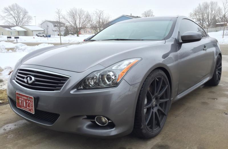

Thanks!

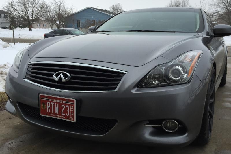

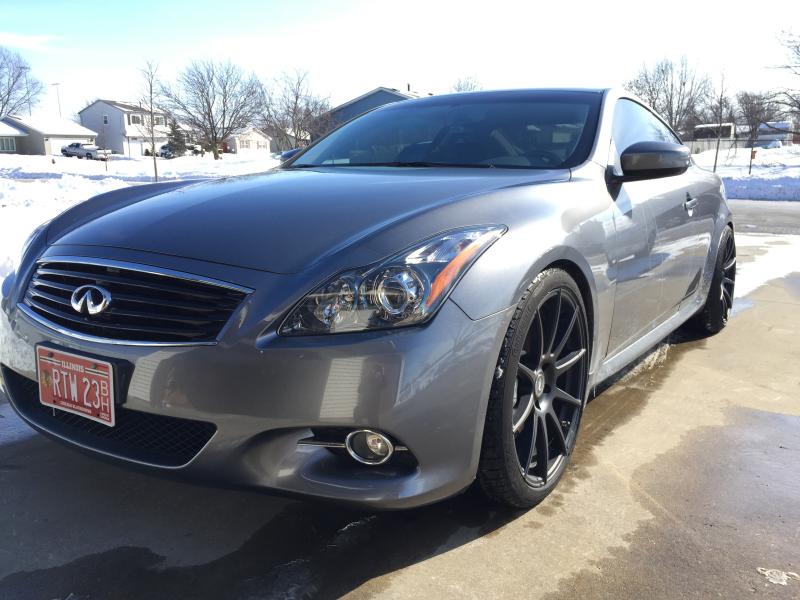

Here are some more pictures of the grille (and the rest of the car of course).

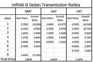

4) Performance wise, hunting down 3.692 final drive VLSD out of a 2008 5AT Sport or 3.9 or going big and going with 3.9 FD (believe the vert sport MT has them, rare as a unicorn and you can get them out of Pro-4x models and there's a few threads about the swaps). The easiest and straight swap is the 5AT VLSD. You already have VLSD, being a sport, but moving from 3.357 > 3.692 , you will feel and notice a significant amount of gain in torque and speed off the line. Much more bang for the buck than almost any bolt on considering to really get full potential out of those, you also need a tune. You can find a nice example of a differential around $400 shipped, which is a steal compared to what it usually cost other makes of performance cars to start messing with FD and ratios or to source a diff. Lot's of threads on here about the in's and outs of the swap-- but you might have read up on this subj matter beforehand, so I apologize if that's the case.

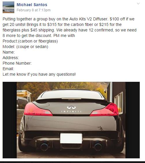

Contact https://www.facebook.com/santos.music as soon as you can, invoices have been already sent out to the people involved (had nearly 32 people at last count) and once they are all sent out today, the special rate is over (unless you can organize another 20 people). Here was the initial post, it was for whatever reason taken down by a mod in the Infiniti G37S public group (no one knows why as it made no one money, wasn't a vendor post, etc...but oh well)

That is a sweet deal on the diffuser, too bad I like the V1 better.

Yeah I used to be on the fence about the diffuser, but I now want the v2. Too bad I think I missed the GB; wish I had known about it sooner.

I like the style of the V2, except the mesh. I don't see the mesh fitting in with any other part of my car.

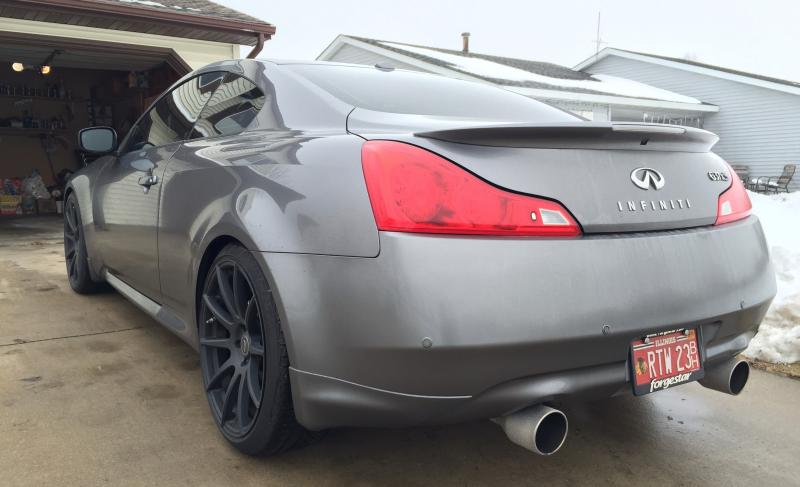

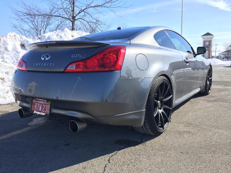

I wanted to try and make my setup a bit more aggressive, so I added 15mm Project Kics bolt on spacers to the rear wheels. This makes the rear 20x10.5 +20

That 15mm made a difference! Looks good!
