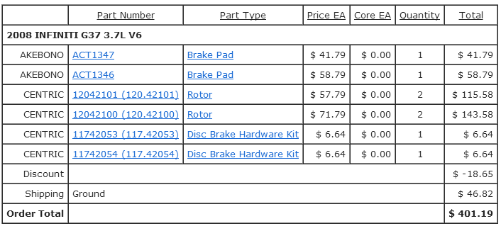

I wanted to have an OEM braking feel and definitely NO squealing so I went the safe route. I got centric premium blanks, Akebono Pro ACT pads, and Centric Hardware. Here is my receipt:
I can't stand the Stoptech drilled and slotted design where the rust ring covers some of the drill holes and slots, so that wasn't even an option for me. Even if you paint it black I still think it looks sloppy and poorly designed. I also feel like the OEM rotors are plagued with warping, so I didn't go that route either. I went with the Akebono Pro ACT over OEM because the OEM pads do not come with shims, you have to buy the OEM hardware at about $50 an axle, plus the Pro ACT are a performance upgrade and come with shims molded to the pad. Honestly, with the setup I bought, its like OEM+. I could easily brake hard enough to trigger ABS if I wanted to and I haven't heard a peep from them yet, even though you would expect to hear a little noise when they are new. You 100% NEED to buy shorter banjo bolts to use your stock brake lines. I couldn't find anything on this forum that made it clear what was needed, so here is what I bought (you need to buy 4 sets):
Technafit Banjo Bolt w/ Washers for Akebono / Brembo Caliper - Nissan performance parts
So basically I paid:
$900 - calipers (new)
$400 - rotors, pads, hardware
$25 - shorter banjo bolts
$1325 for the parts

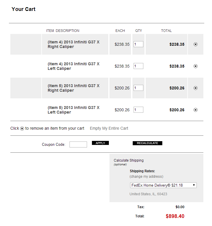

Here is InfinitiPartsUSA price for the calipers:
Here' the list of part #s if you want to cross shop a few sites, this would be awesome if you could get a nice price and find one of those 20% discounts floating around on a couple sites. BTW, some of the parts #s have been updates but it should show you which ones.
Akebono Big Brake Kit Part Numbers
The only 20% off coupon code I have ever seen was for accessory parts. I have inquired about that discount with a few websites and it was a no go on the Akebono BBK for every one. That would be silly cheap for the calipers, I would be tempted to buy a second set at that price, lol.

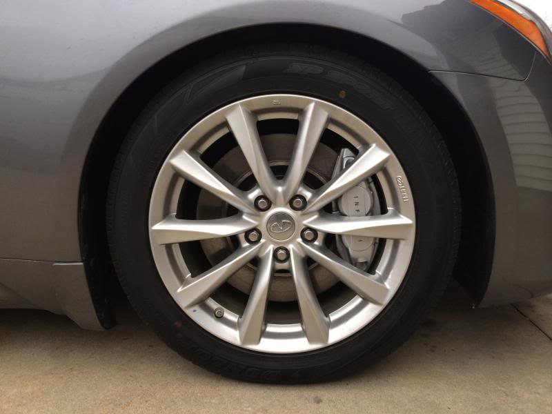

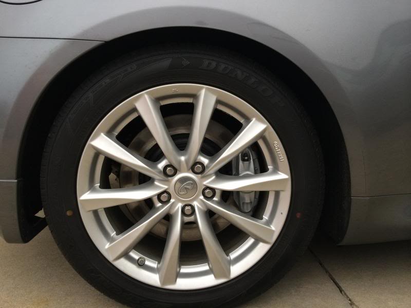

Yay! My drop is even @ 27" all around.
Front:
Rear:
Note to any observant members: Yes, I know I didn't have to label front and rear but I have learned in life that you can never be too clear, lol.

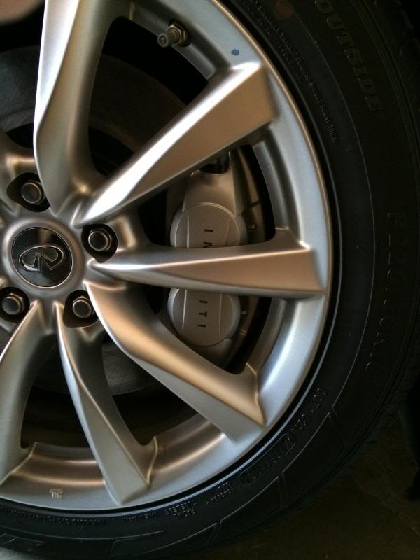

Thanks! The Akebono BBK is very tight with my 18" stock wheels, but I think people would be happy to know that they fit without spacers. You don't even need to grind down the caliper!!!

The CV1 wheels are one of my favorite, definitely a wheel I am considering. The braking power is not night and day difference with the Akebono, there is just much more control and stability. Don't get me wrong, these brakes will stop the car much quicker than any of your passengers would be comfortable with, but there is much more gained in pedal control and feel opposed to all out stopping power. Good luck with the Koni/Swift setup, let me know how it turns out!
