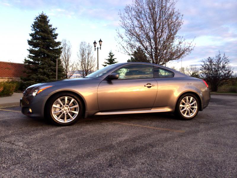

BTW, car's looking great Ryne, you weren't kidding about those calipers being quite snug w/ those 18s, but the overall look is
