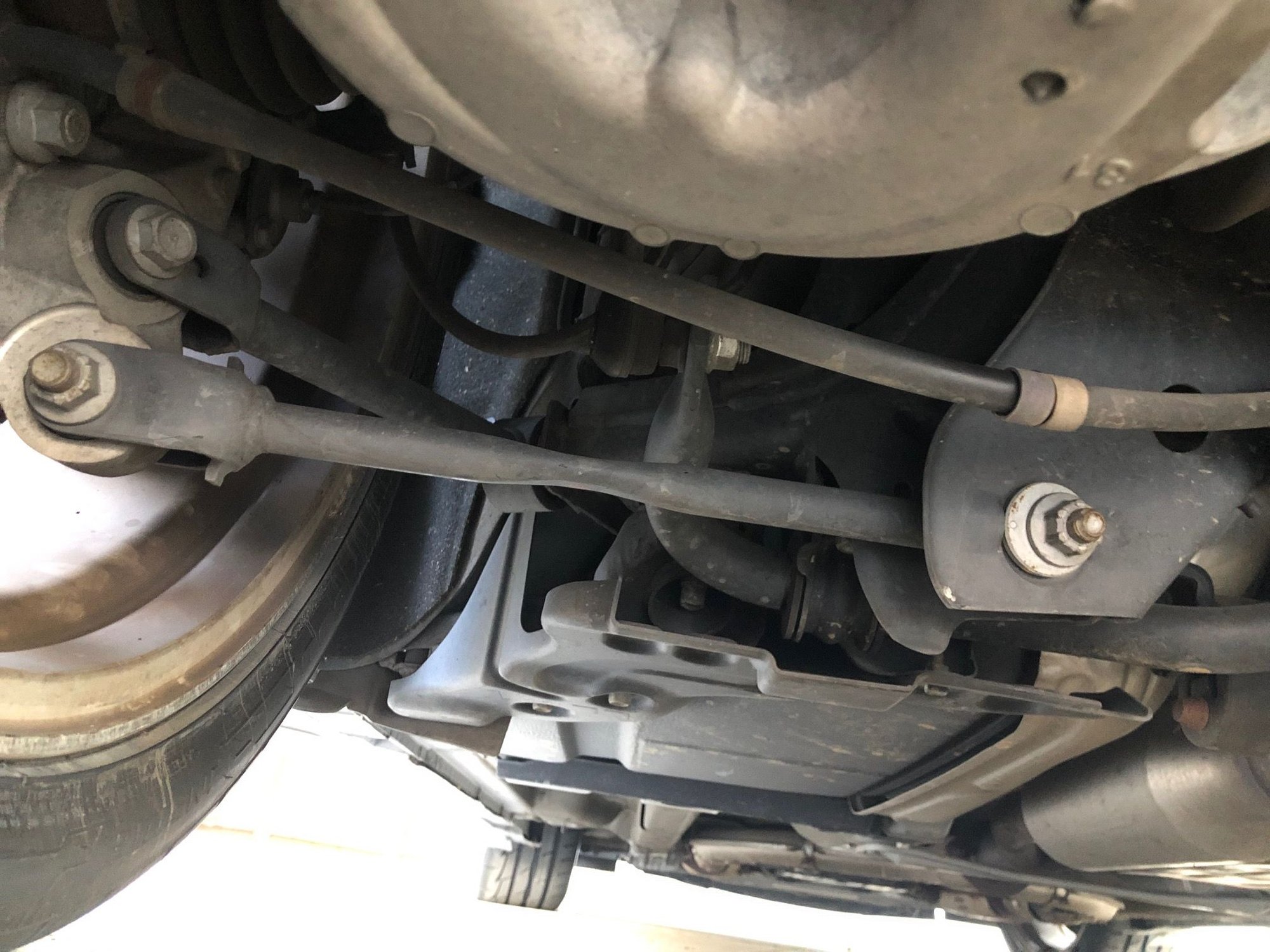

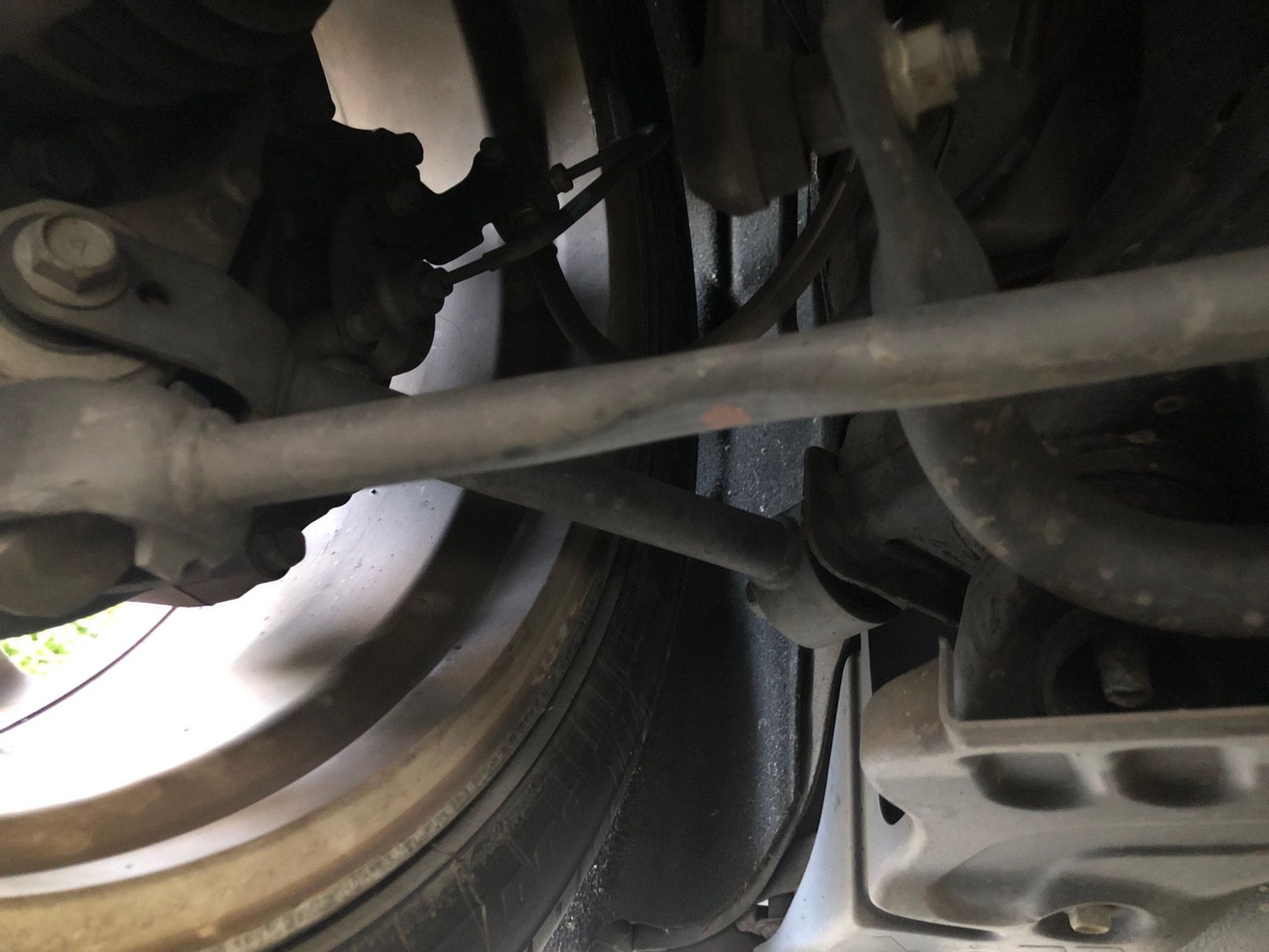

The rear toe arm has one end that slides in a slot to adjust toe. When the Tech adjusts toe, he will unbolt at the slotted end, move that end into proper position then tighten the bolt. Your car's arm is at the end of the slot. The slot can be widened a bit to increase adjustment range.
Your rear thrust angle is perfect but it could use another half-degree or so of toe-in for stability. Until the toe bar slot is widened, the Tech can't fix it. Your front toe-in could be reduced so your tires will last longer.

Thanks. Hey I had to take this pictures and run them by you before I talk to the tech. Do these arms have the capability to widen the slot?

Having never adjusted the rear suspension myself, I am not going to answer that question. There are plenty of guys who have, you'll have to await them.
What slot?

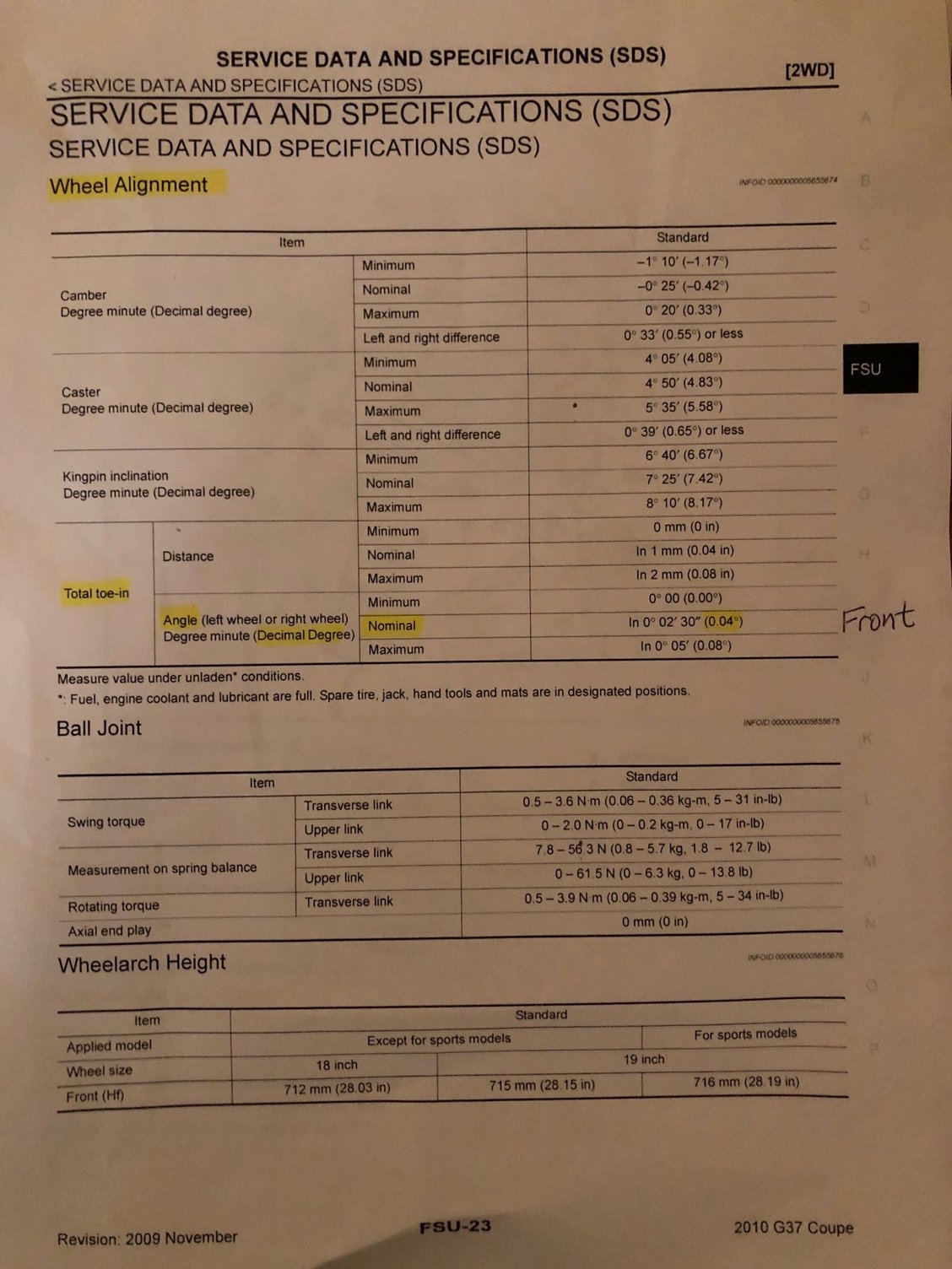

Total Toe as per specs in the front now.
From 0.11 to 0.04 degrees total toe in the front now. Not sure it's subliminal but steering wheel felt a bit smoother. I think the "spc toe bolt template.pdf" attachment points to the "slot" being talked about earlier. In my case I'd have to purchase the camber link and toe bolt to bring the rear within specs since total toe rear adjustment has been maxed out.
