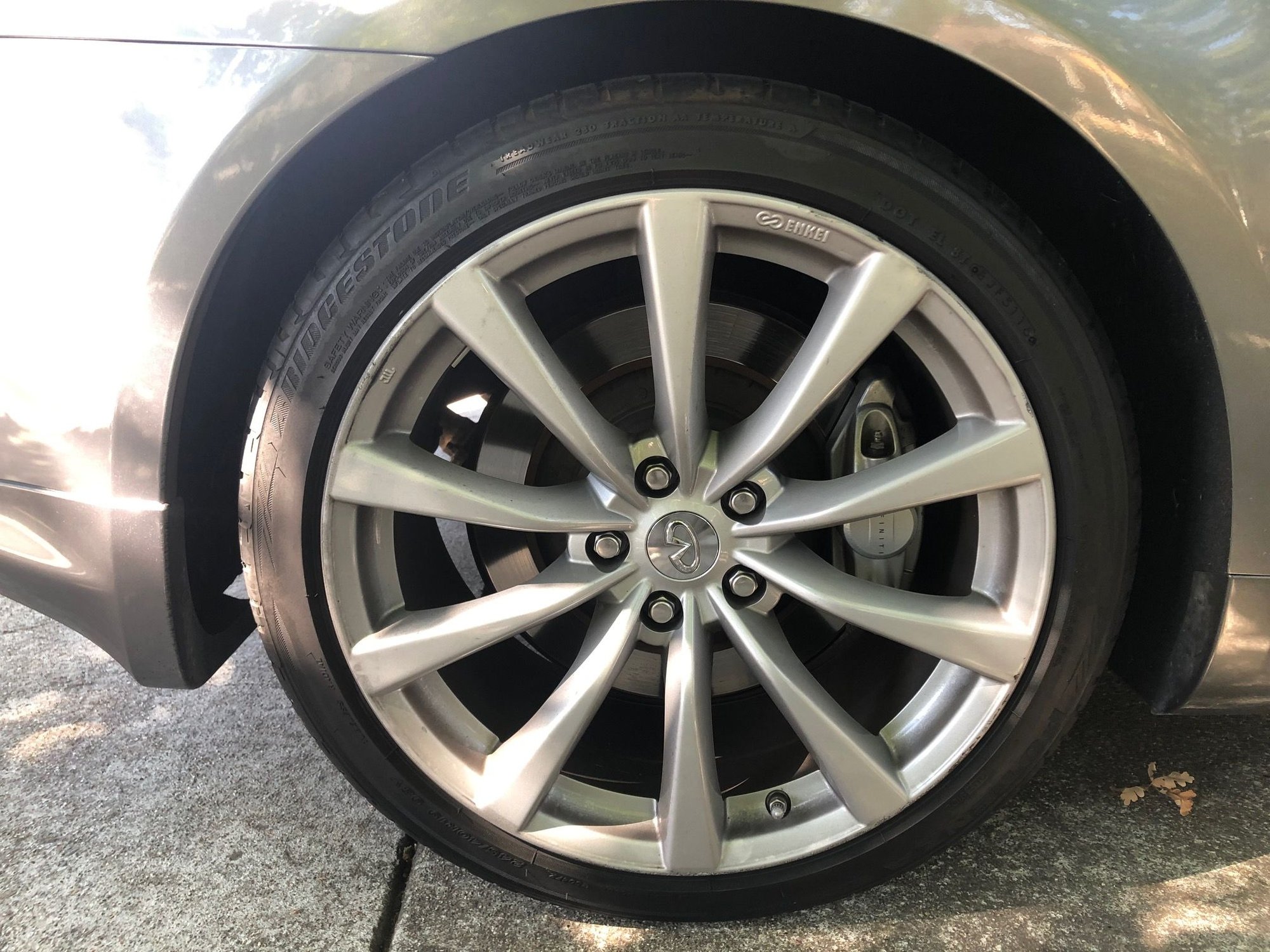

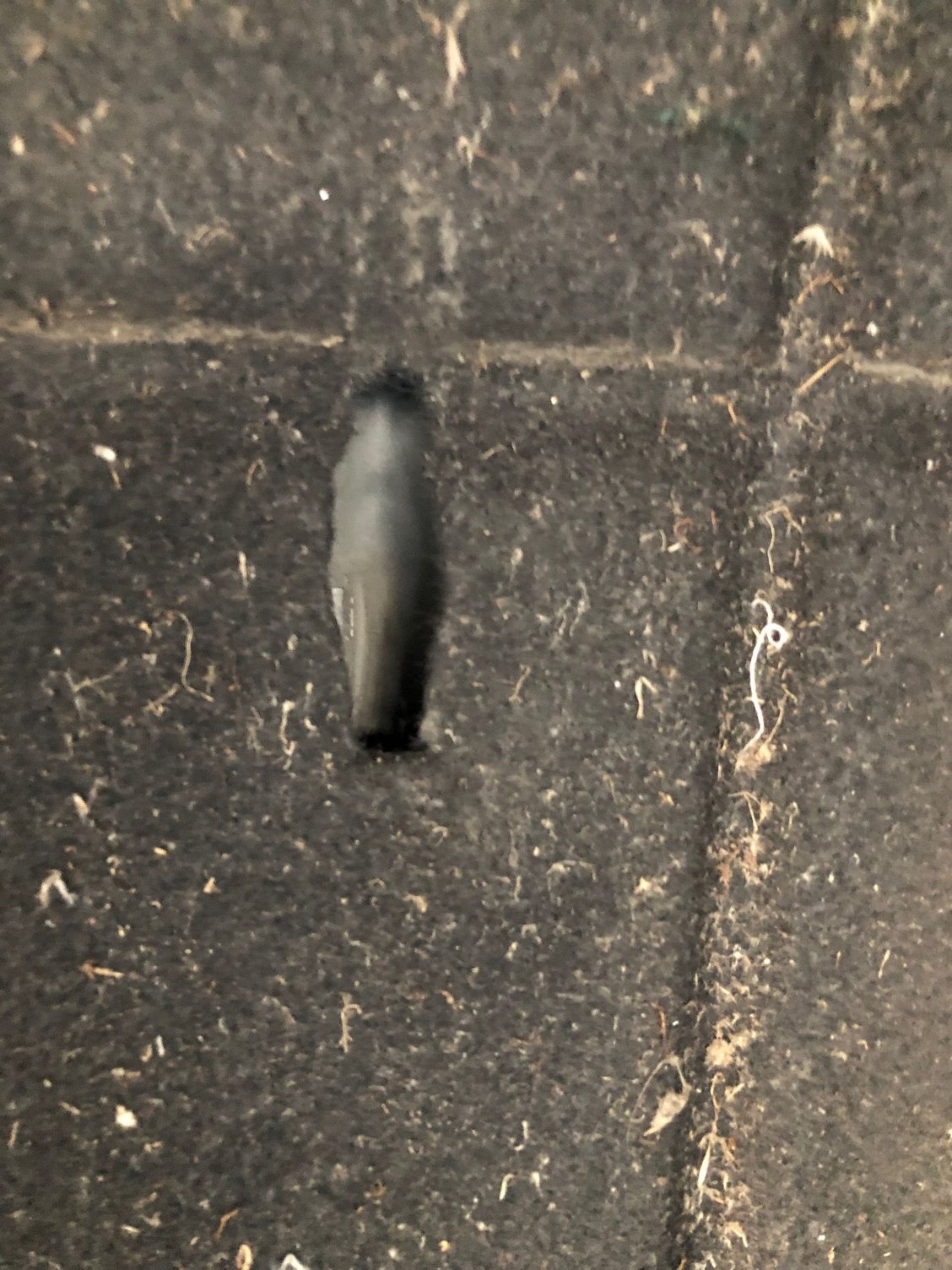

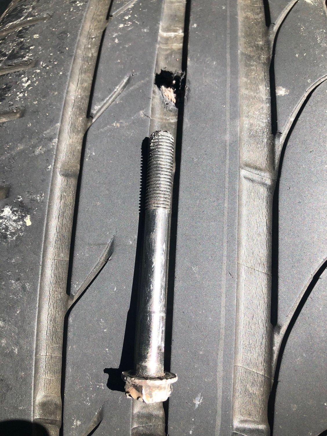

After having my first flat (rear left) and noticing tire thread I'm looking for new tires and brake rotors/pads. Further examination of wheel well showed I went over a pretty good size bolt that got stuck on wheel well liner, loud bang alright. Also noticed a shine on the shock pictured here. Is this from the tire rubbing?
Previous owner had Bridgestone Potenza S-04PP's 225/45 R19 in the front and 245/40 R19 in the rear. Pricing in my area with Firestone has these tires out the door installed for $1,043.73.
Tires/sizes worth considering? I've been reading a bit here about installing other tire sizes/cam kits etc. My car is stock and I would consider modifying here and there.

Bolt recovered from wheel well liner, next to tire damage.
Liner damage where I recovered bolt from.

Rear Tire.
Front tire.

You can go wider on tires with those wheels. Tires rubbing rear dampers is not unknown. Look in Tech/Suspension and Brakes for brake ideas.

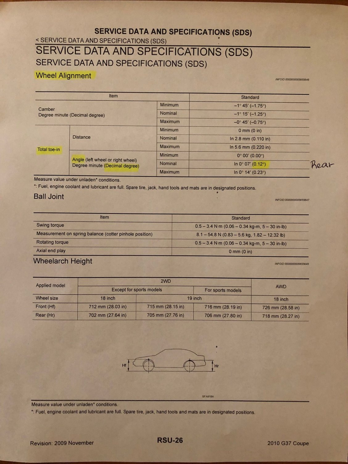

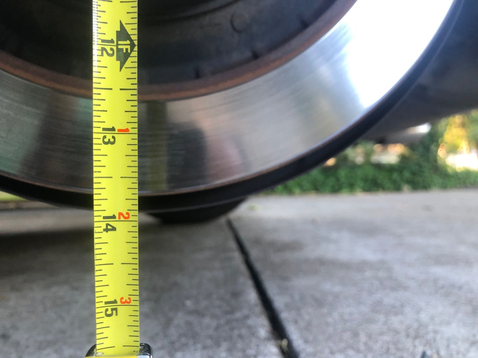

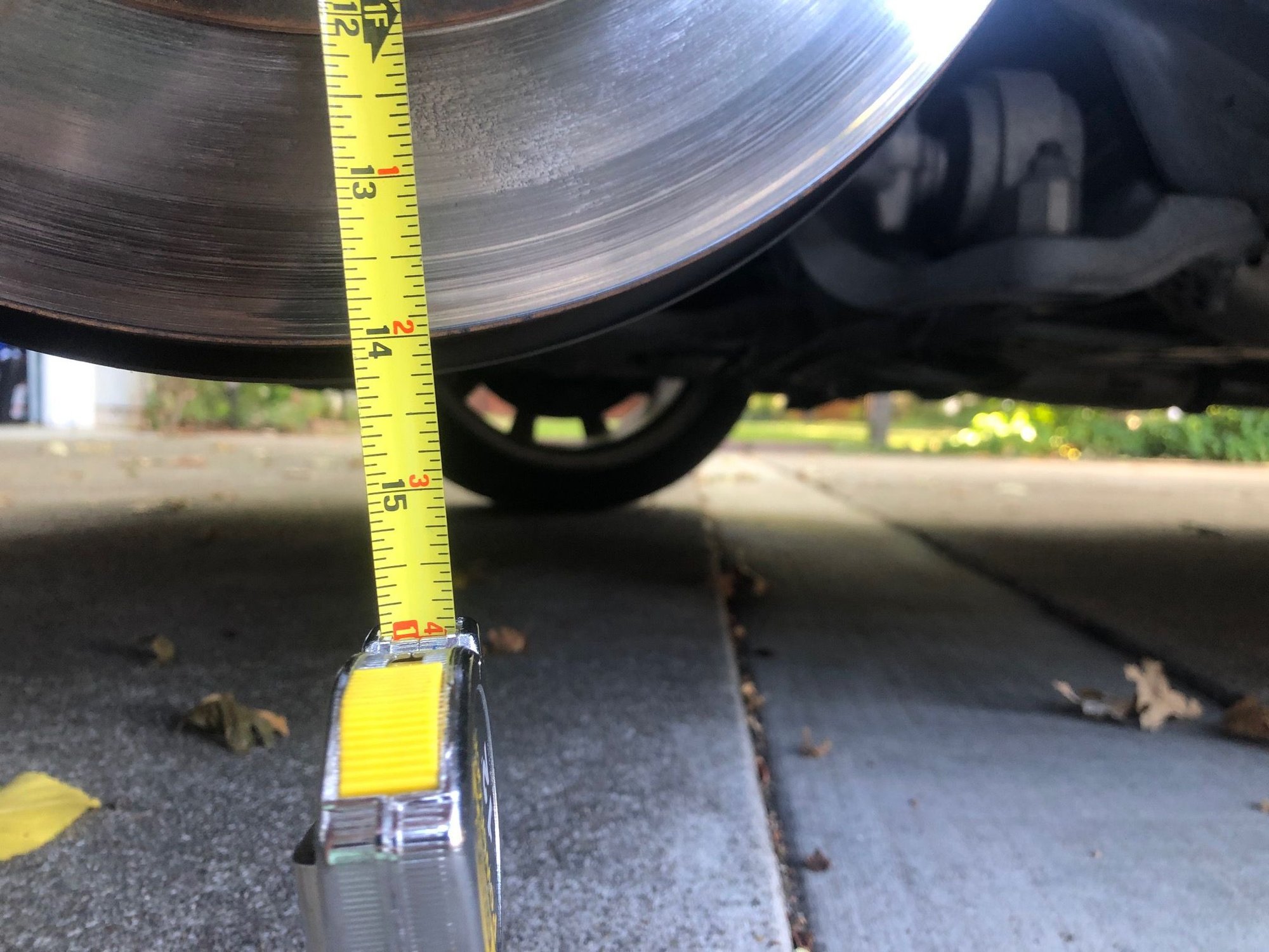

Thanks, I'll look to confirm. See attached specs. "P" for Sport package has the front rotor at 14.0 X 1.3 and rear rotor at 13.8 X 0.8. I'm going to pull wheels tomorrow and measure to confirm. I imagine 3rd party rotors should be as close to original if not exact same. I was looking at matching Stoptech with Hawks pads as they would seem to work well for intended driving but again want to confirm these measurements and keep options open.

Front. 14"
Rear 13.8".

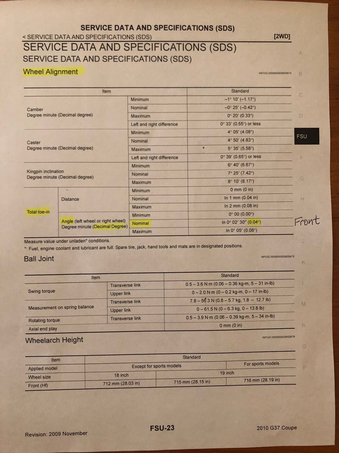

Thanks. I watched this video to better understand camber, caster and toe,
For the rear wheels, he showed me and said he maxed out the adjustment for rear left toe and brought it from 0.11 to -0.01. He also mentioned the only way to bring that rear left toe to 0 now would be to purchase a rod that allows for further adjustment.
At 4:13 this video says "the toe in has a very low angle", as an example they use 0.05 (perhaps standard on most cars?). Then he says, "each car will have an optimum set of wheel angle (in reference to toe) decided by the car manufacturer. I was curious to know manufacturer toe in specs so I looked at the manual and found these specs attached under "front suspension" and "rear suspension".
It seems nominal, min. and max. front total toe-in should be 0.04, 0.00 and 0.08 degrees respectively.
And nominal. min. and max. rear total toe-in should be 0.12, 0.00 and 0.23 degrees respectively.
If I was to go by these specs I would probably ask him to adjust front left and right toe in to 0.02 for a total toe of 0.04 and definitely try adjusting the rear.
I'm curious if these nominal manufacturer specs may be driven more by safety vs tire wear or perhaps both.

If you need the toe arms to get rear toe-in, that's what you have to do. You could tell the tech that widening the slot is a tried-and-true procedure on Z34/V36 platforms and that would get you within spec at minimum cost.
The uninformed driver likes the car to steer straight (zero rear thrust angle) and steer itself straight a little (front toe-in). The nominal values achieve both with as little tire wear as is reasonable as determined by the factory.
If you like a little more engagement with your car, zero toe in front is very livable. You want a little toe-in at the rear for stability. The car steers easier and is more eager to change direction at the slight cost of paying a little more attention to lane keeping. And tires last longer.

On the Wheel Alignment sheet above it states Thrust Angle was 0.08 before and 0.00 after.
I inquired about the alignment equipment being used, hunter, and he said that's what dealers use and that it was very good. It looks that way.
I find it interesting that according to this vehicle manufacturer specs the Maximum Total front toe-in angle in decimal degrees is 0.08 yet the Wheel Alignment sheet shows 0.11 with 0.00 angle of steer ahead all on green.
