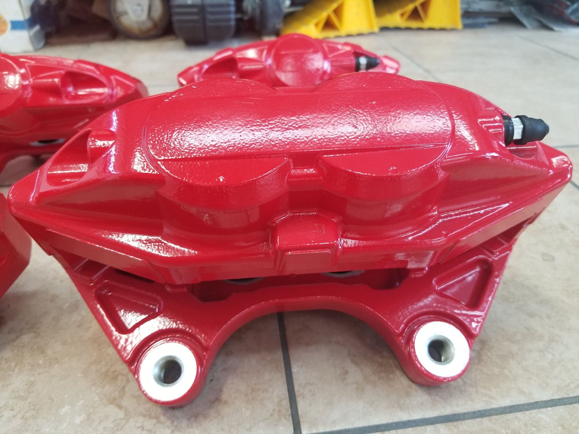

Well received my "Power Stop" calipers, and finish look like shiet compared to another members Powerstops.... Bought them from Rock Auto. Noticed it came from "return center". I guess somebody already returned them back.
Bought another set from Amazon we will see how powder coating will compare to Rock Auto stock.

That's about what to expect since they are powdercoated remans, they will be bead blasted then painted, so that finish is about on par w/ what I've seen.
Preparation, blasting is not that bad. Problem is quality of powder coating(orange peal). Bad operator, uneven coverage, damp conditions or too much charge in powder....

Having done some powder coating, a pebbly surface means low temperature or too short a bake time. This assumes good surface prep...
This could be too... many variables... Anyways. This is half *** job. It would not pass my quality inspection

Would be interesting to see what the calipers surface condition was prior to the painting, some of those remans can be pretty rough once they get bead blasted. Understood regarding the orange peel, but that paint will reflect the surface prep too.
