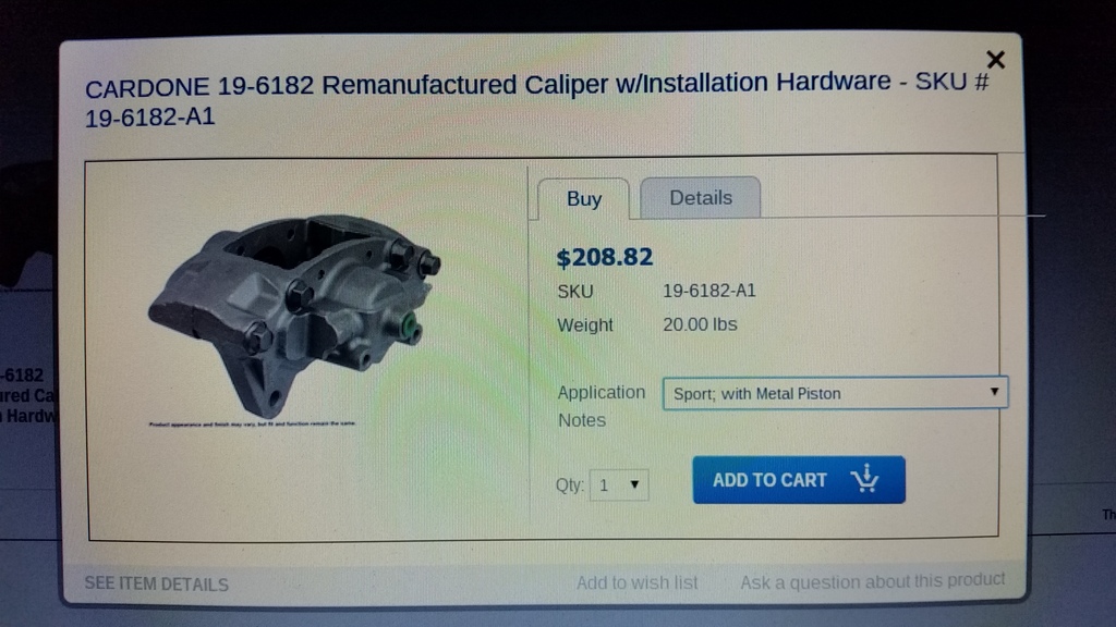

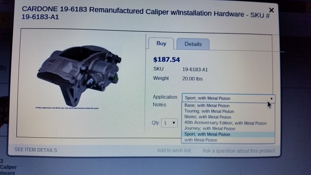

am i on the right path here? it looks like ultrarev.com has them in stock. im a bit confused. i have a 08 sedan xs, should i pick the drop box option "sport with metal piston" in order to ensure that i will get the right calipers?

Actually don't get those. Go back to my first post and look at the part below my update in red. You can get brand new calipers from DiscountInfinitiParts.com for around the same price and they'll have the brand new factory silver finish w/ Infiniti graphics w/ no worry of blemishes that can occur w/ remanufactured parts.
If you need further help after looking at that let me know.
Brad
