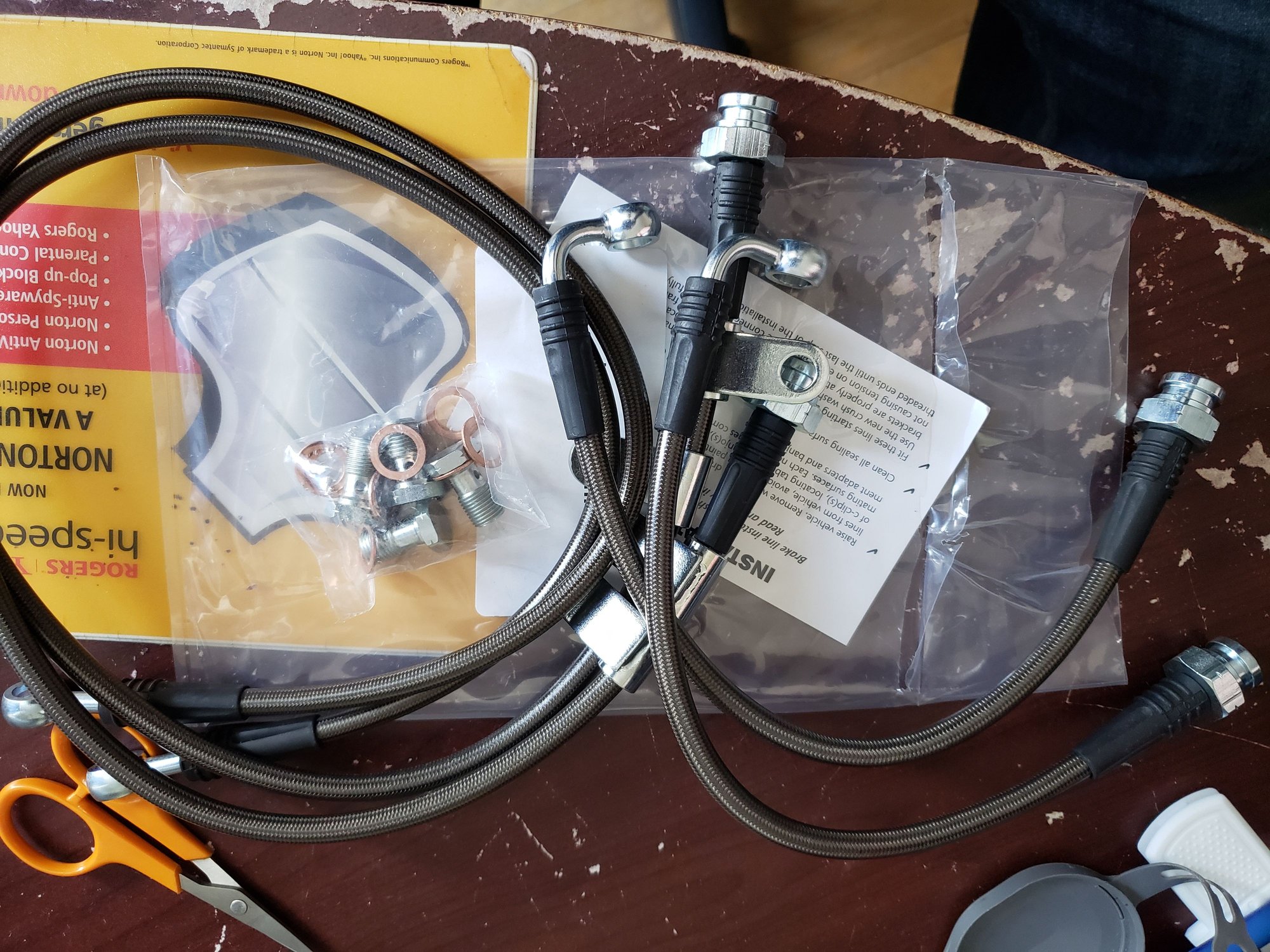

I received those brakes line today and that was fast shipping
Now in this picture am I suppose to get those shims circle in red with the Springs circle in black or do I have to order them separately?
tks
tks
You'll get it depending on what you ordered for pads and calipers. ive got an extra set laying around. Pm me your address
