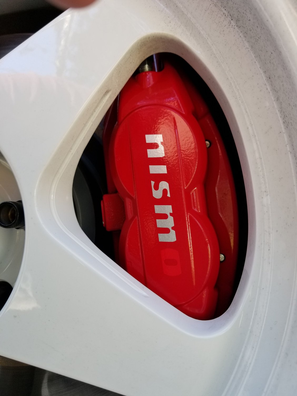

Some inspiration for you guys. My brakes have performed flawlessly since install.

Hows the rust on the rotors? (I assume the ferrite virus is pervasive in the PNW). Would you recommend a spray job before install?
Old May 31, 2019 | 06:06 PM
  #206
PNW_IPL's Avatar
PNW_IPL
Joined: Mar 2016
Posts: 3,050
Likes: 547
Definitely spray or splurge and get the E coat. My rears look like crap already.
