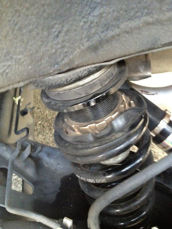

As for the "Chattering," you need to make sure the locking rings are tighten correctly on the REAR STRUTS (not the springs) make sure the vehicle is on some sort of pressure so you can tighten the rear locking on the struts

I believe he's referring to the BC locking ring on the rear strut, and making sure the ring is tight (so it doesn't loosen, back out, and then make noise).

As for my experience, I have a shop in Orlando with several lifts, (2 post, 4 post) The chattering was very annoying..
Short version
I installed these coil overs perfectly, without any issues, not a single chatter. Ended up selling my wheels and installed new wheels (lifting the entire car off= releasing the tension on the rear struts, possibly releasing the rear locking)
As I drove on a brick road, the chattering begun, and drove me nuts. The next day took the car to the shop, placed it up on my lift without tension on the rear struts...not one chatter...placed it on my other lift with tension on the rear struts heard the chattering noise and started isolating it to the locking mechanism.
Moral of the story, whenever I lifted the vehicle off the ground it released the tension on the locking mechanism on the strut...so I tightened them up, and it hasn't chattered since. Also if you were to call BC (btw BC is located in Orlando and Ive done business with them, so i know this as a fact) and ask them about the chattering. They would usually state "you need to lift this rear, by the pumpkin and tighten the locking mechanism on the rear struts." Like I stated.

I have not seen any pictures of the coilover rears in this thread. Can those with issues post them up? Maybe some have a simple install orientation issue.
Alright, let me ask this simple question. Everyone here says its the right rear (passenger side rear). Well since the rear left isn't making noise, have you tried moving the shock left to right and right to left? Both are identical top to bottom. If you have a faulty right it should become a faulty left. If you still have a faulty right, then it isn't your shock.
Have you assured that all lock rings are tight? If it is loose, the shock can rattle in the lower mount generating noise through the top hats. Same for the spring locks.
