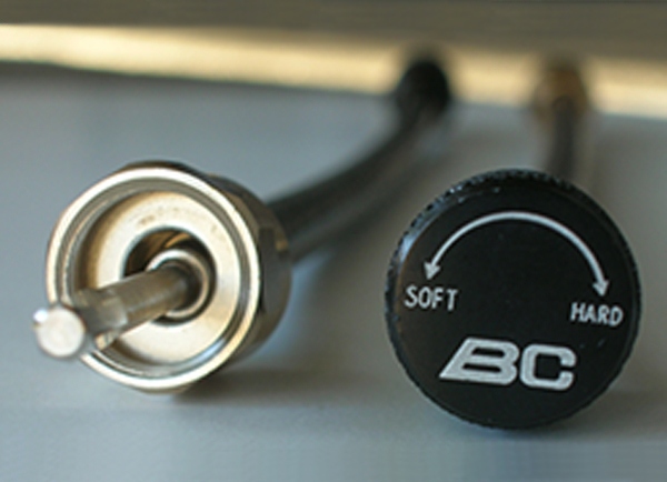

oh boy... stock settings are set to the hardest settings i believe which is 0 for both front and rears which might explain your harsh ride
they are 30 way adjustable and you can get to the fronts in the engine bay but the rears depend on if you have the version where the dampening may be located at the top of the strut in which case you have to kinda take em off if the extenders wernt installed
"0" would be the softest, not the hardest. "30" would be the hardest. I think I'm at 23 or 25 or so, and I wish they'd still be more stiff. I think it has more to do with the progressive spring rate than the dampening though.
As for the rears, if the adjustment **** is on the outside/top of the strut, which it should be, then simply put a floor jack under the pumpkin and raise the car until the rear wheels are off the floor. You should have enough room to stick your arm up there and reach the ****.
ANMVQ, the **** in your engine bay to make adjustments should look like this (it's a picture of an old extender, but the **** looks exactly the same):
