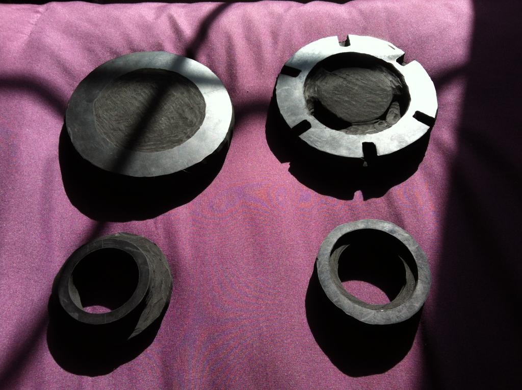

Allow me to chime in, I have AMR Engineering coilovers that are pretty similar to BC and they make a lot of noise, especially if I am driving on low speeds on uneven road (rear right being most prominent). I always thought it was the spring playing around so I installed rubber isolators which I have made myself. In the pic below you can see the thick 1" rubber isolator that replaced the aftermarket top hat, below that is another 1" rubber with that sits between the spring and the height adjuster (1/2" rubber between the spring and the height adjuster). I was hoping this would make the noise disappear but it didn't. It is really frustrating not being able to fix this. I am leaning towards the shocks being the culprit.
Very interesting.... your bottom fix was what I was aiming for..... now you have me thinking that I may be barking up the wrong tree? I hadn't even thought of the shock.... hmmm.... I mean I had made sure the top 17mm nut was tight, so I obviously removed the whole shock and it all looked/felt fine.... then re-installed it. On my car, the sound "seems" to eminate from the spring when I tug on it. I need to keep an open mind on this. Thanks.
But... did the noise you experienced sound kinda like a "creaking" noise? "dull" rattle? Did adding the rubber change anything???
Thanks for "chiming" in..... gotta look at all aspects of this.

So far I don't hear any "creaking" noise but the rattling noise is still there (as if I have something loose in my trunk). I too thought it was the spring as you can make a similar noise by moving it around. I can't make the noise with the rubber installed.
