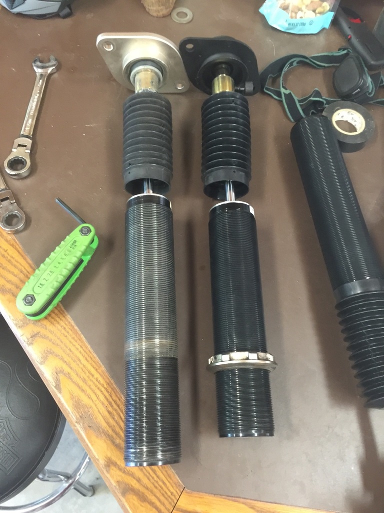

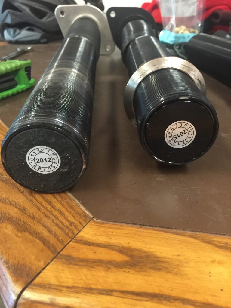

Got my replacement BC coilover rear shocks installed over the weekend. I've only done about a 1-2 mile test drive, but so far the right rear clunk is gone. The car is MUCH quieter now and way better to drive. I've got the rear set to the number 10 setting from full soft.
The new shocks utilize stock rear top hats. I ordered new KYB top hats off of Rockauto. The newer shock bodies themselves are also MUCH shorter:
I'll update more once I get to drive the car more.
