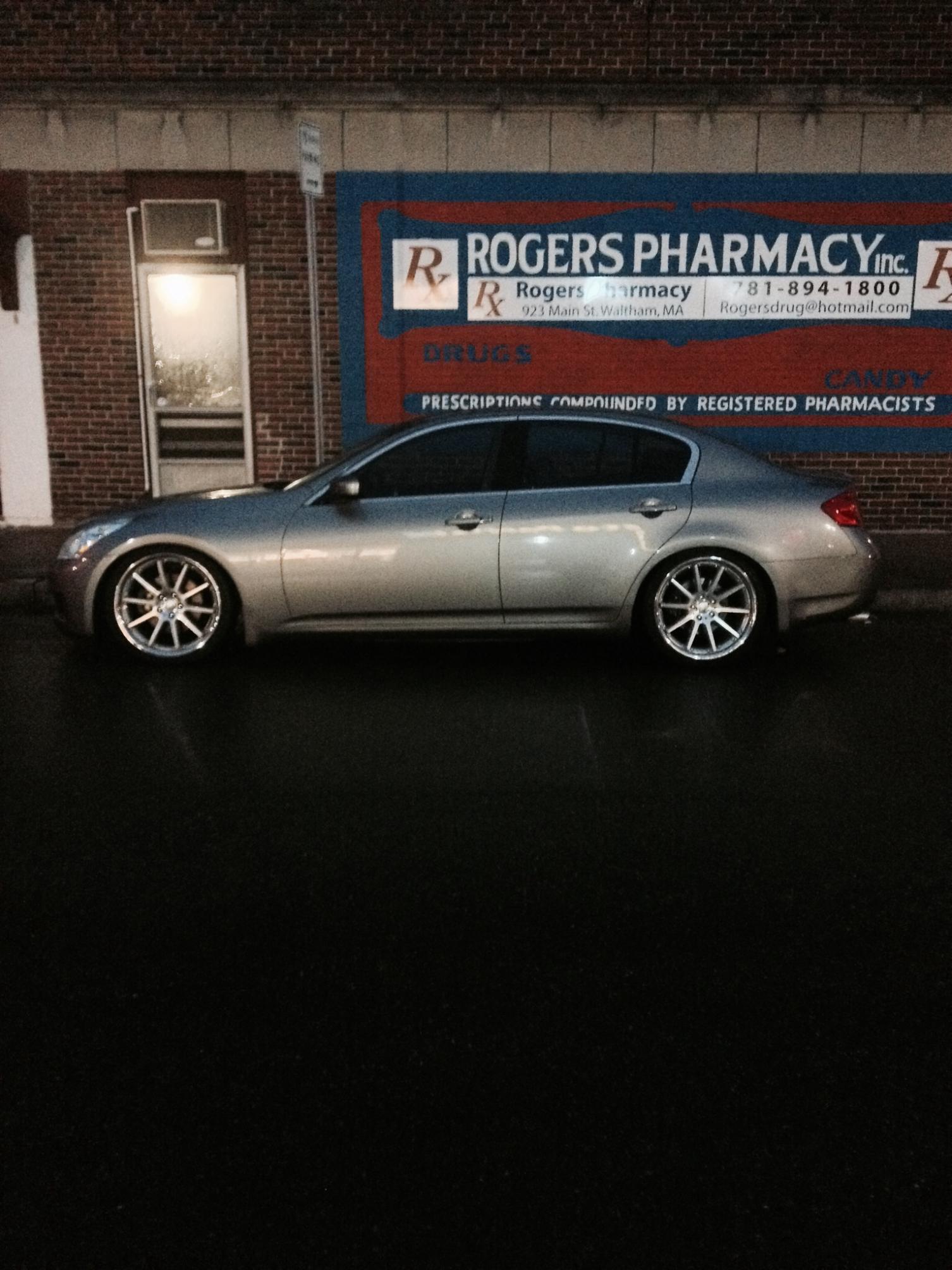

So i didn't even get home before the knocking and clacking started , seriously
Guess the new one don't have any updated parts . The car looks GREAT But rides like :/

whats your dampening set at?

I have to ask tomorrow but he said something about he left they at the stock settings
Is that something I can change ?

oh boy... stock settings are set to the hardest settings i believe which is 0 for both front and rears which might explain your harsh ride
they are 30 way adjustable and you can get to the fronts in the engine bay but the rears depend on if you have the version where the dampening may be located at the top of the strut in which case you have to kinda take em off if the extenders wernt installed
