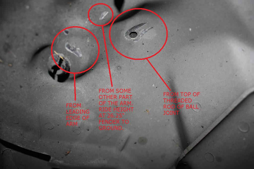

Another point I noticed after installation: The top of the threaded rod of the ball joint protrudes above the nut (the one that TQs to 120lb-ft) a good 3/8" or so after fully TQ'd. If this is shortened, that gains just that much more travel distance. I'll relay that on to Jeff.
But according to Hamsters pics, it doensn't look like that is what is hitting the fender. It looks like it's the actual arm.
Old Apr 1, 2009 | 02:19 PM
  #87
finagle69's Avatar
finagle69
Joined: May 2006
Posts: 2,929
From: Sacramento, CA
That's true, however, they're thinking of shortening the length of the arms, which will put it in the pocket it should travel into. At that time, then the screw length will be an issue. Just trying to think ahead to maximize the amount of suspension travel and minimize the use or number needed of the urethane washer bump stops.
Edit. Now that i think about it, mine hit both the leading edge of the arm and the top of the threaded rod... I'll find the pic I have of it.
Double Edit. removed
Triple Edit. I found the pic. See attached.
