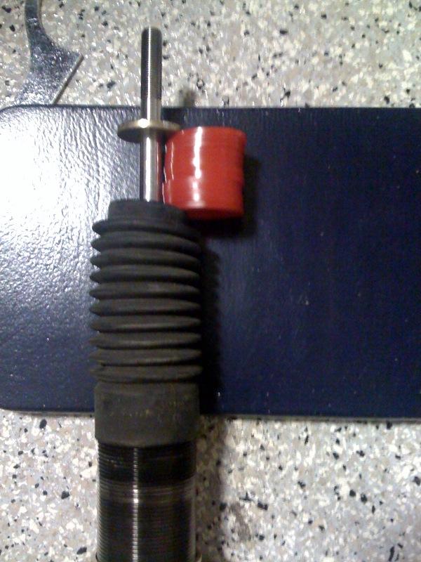

Update:
2 nights ago, I installed bumpstops onto my passenger side BC Coilovers.
Here is a quote from the email I sent to Jeff@SPC detailing how I came up with the amount required. Also attached is a picture of showing the number needed.
Jeff,
This may come as a surprise, but I found that 13, yes, 13 urethane washers were needed for the passenger side strut. I’ll explain how I came to this conclusion.
When I had the G37 arms on, I installed 4 washers on the driver side. I thought this was enough to mitigate contact, though I may have been wrong. After installing these, I jacked up the passenger side and slid the BC bump stop far down the shock tube. When I received the G35 arms, I installed them, then drove the car over a week and over 1200 miles, hitting metal to metal a few times. Last night, I tore down the passenger side suspension, removed the spring, and found the BC bump stop traveled up the shock tube, but was short of the metal sop by a good 2”. I grabbed a stack of washers and started loosely fitting them up. 12 washers fit just fine, but I was able to wedge 1 more washer in to make it really tight <see photo at end of email>. Then I went ahead and installed all 13 washers in a permanent fashion.
I feel confident that this amount of washers will end the frustration with hitting metal to metal. I will say that this most likely has more to do with BC Racing using poor R&D practices to find a better bump stop size for the G37 application. Granted, washers would be necessary due to the height increase that SPC imposed on the arms, but no more than about an inch worth. This, unfortunately, will likely only be applicable to those – like myself – who have BC Coilovers as their suspension. Other coilovers may have longer bump stops and might require fewer washers. Fortunately, I have enough washers to install 9 more on my driver side.

Originally Posted by finagle69
Update:
13?!? Good god. There has to be a better product. We need an official position by SPC on what they're going to do.
If you read it again, you'll see that I think it's a BC thing... I don't think BC fully R&D'd the product enought to truly dial in how much shock tube travel there should be and how large the bump stop should have been.
I'd be willing to bet that someone with some KWv3's would find that they may only need 4 or 5 washers to achieve the same thing...

I think you missed a key part of Finagle69's post that said: "I will say that this most likely has more to do with BC Racing using poor R&D practices to find a better bump stop size for the G37 application."
