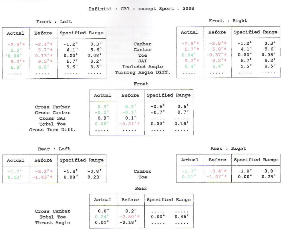

I have sent Jeff an email too, hoping to get a resolution. My camber kit has been lying in my room unopened, untouched for too long.. and I need to fix my negative camber.
Can someone take a look at my alignment sheet and tell me if the G35 arms will work? I am on KW and SPC rear camber kit. Thank you!

^You'd probably end up at the minimum of the specified range, so closer to the -1.2deg.
