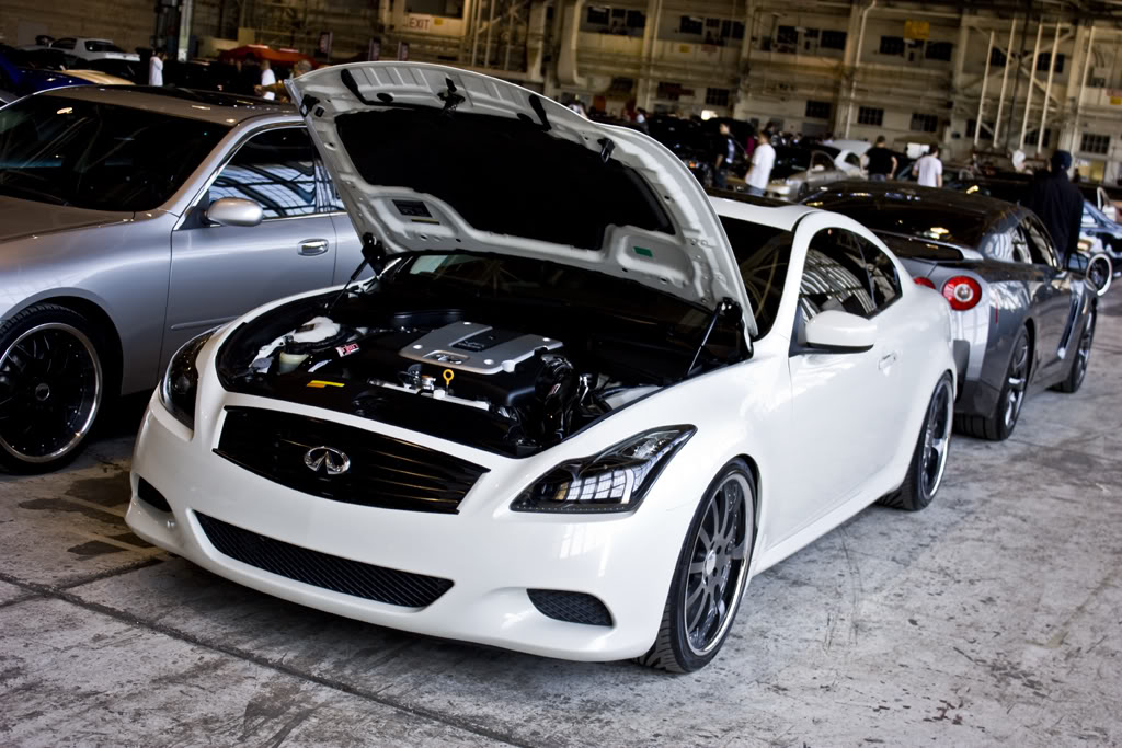

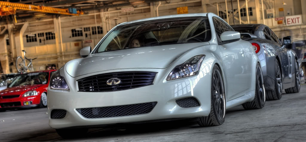

Sorry I haven't posted in here much lately. I was busy driving 650 miles for work on Thursday and Friday, then preparing for a local car show late Friday night with the show being about 75 miles away on Saturday.
Here are a couple of pics taken at the show that illustrate my camber at *near* maximum positive adjustment. (near meaning about a milimeter from max).

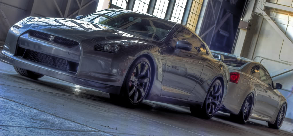

Here's one with the GTR in full just for fun.

Nice.. Looks good bro.

Looks good! Someone does not look happy that you took their picture.
HAHA, my GF was just waking up from sleeping in the car for an hour. she looks like, "is he taking a picture? is this gonna be on teh internetz?"

LOL, the funny thing is, I told her I'd be taking some pictures, and if she saw the camera, to stay still for the three pictures in succession. You'd figure if she knew, she'd put her game face on!

car looks good. didn't even notice your girl in the car even looking 3 seperate times until hampstersG pointed it out.
