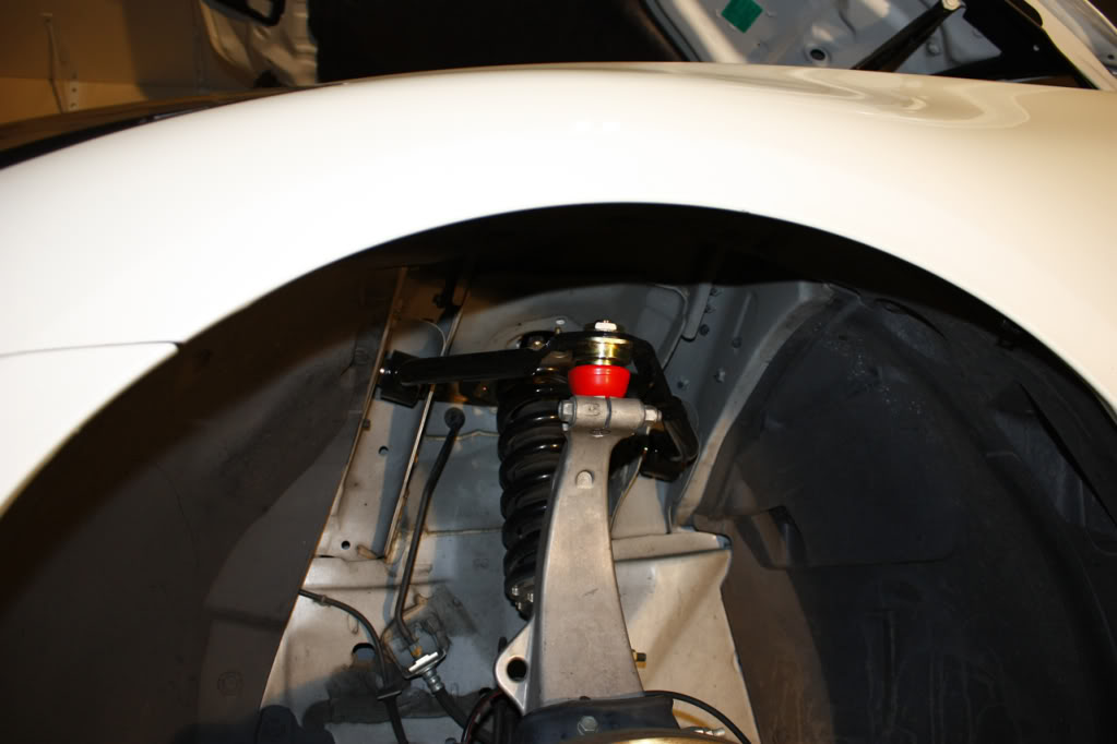

Old Mar 29, 2009 | 06:51 AM
  #23
Ivoidwarranties's Avatar
Ivoidwarranties
Joined: Nov 2008
Posts: 2,078
Likes: 29
From: Omaha
This is a picture from Finagle69's post. What part are we talking about here?
Well the suspension isnt loaded here, but if it were, the outermost part of the control arm (above the ball joint) slaps the fender well. I've got a pic on my phone, but I havent figured out how to send it to my email yet. I'll try to post it and you'll see the problem.
Old Mar 29, 2009 | 03:34 PM
  #28
HamstersG's Avatar
HamstersG
Joined: Sep 2008
Posts: 1,500
From: Northwest Virginia
First let me say I am getting too good at taking these in and out.
Based on some measurements that I took today, you lose about 1" of upward travel with the design of the SPC a-arm. That is just comparing the OEM and SPC arms side-by-side. You lose about another 1" of upward travel because the SPC arm does not go up into the fender recess like the OEM one does. So ballpark you lose about 2" of upward travel. Add a little over 1" for the Eibach drop and you are now losing 3+" of travel. And even more loss for those on coilovers.
Here are some pictures I took today that may help.
Here is the OEM arm at the highest point.
Here is the SPC arm at the highest point.
Here is where the fender hits the arm.
Here is where the arm hits the fender.
