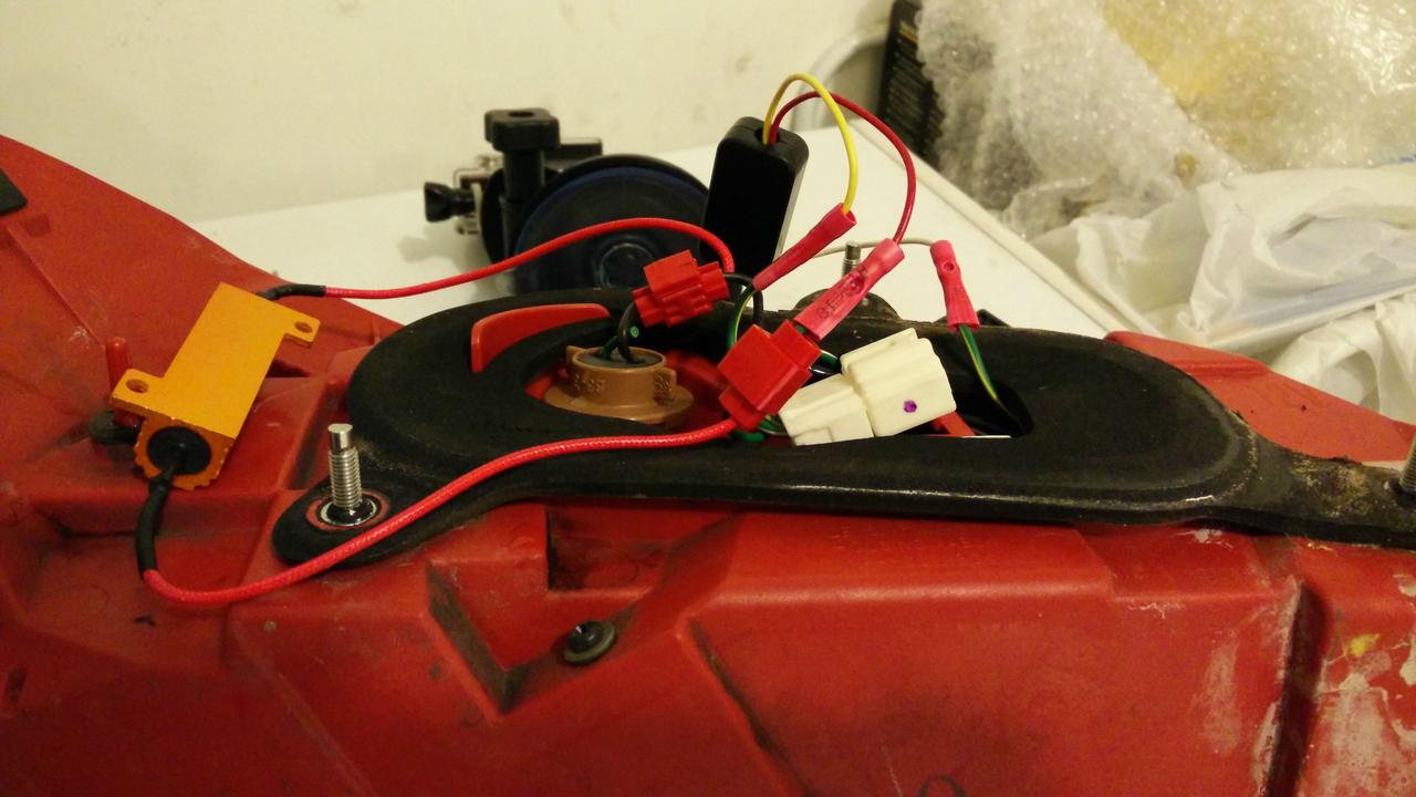

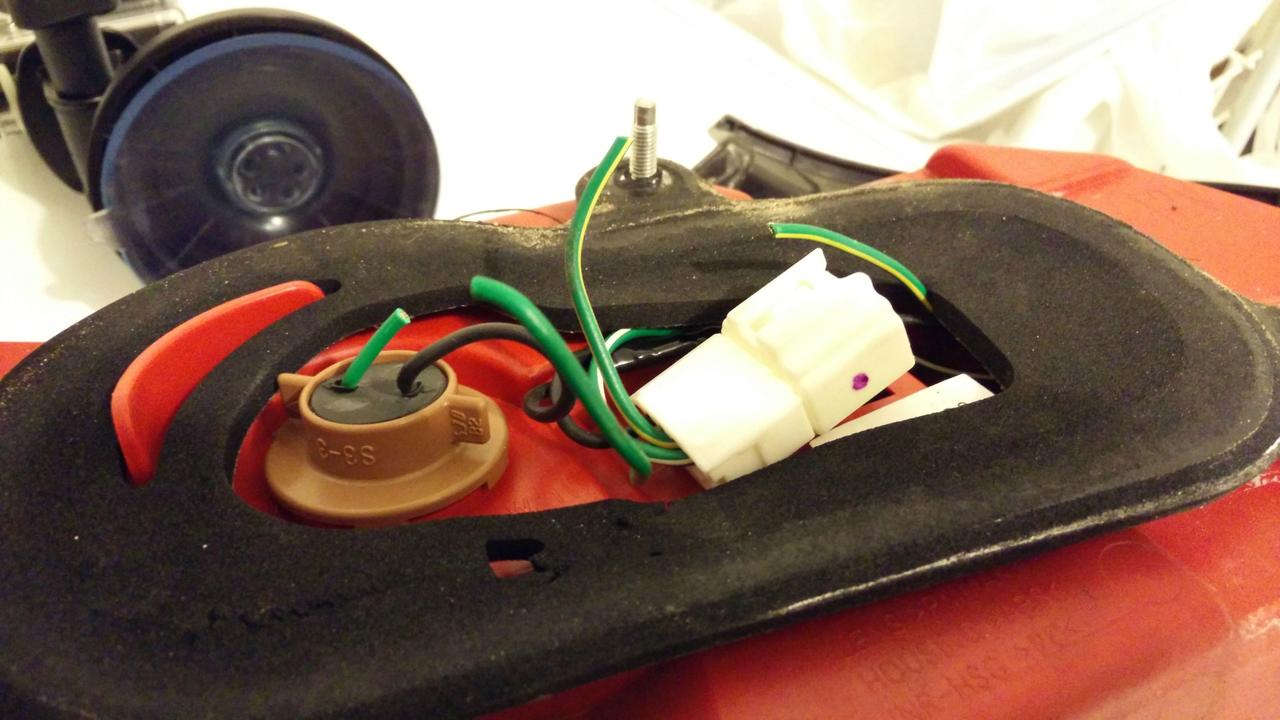

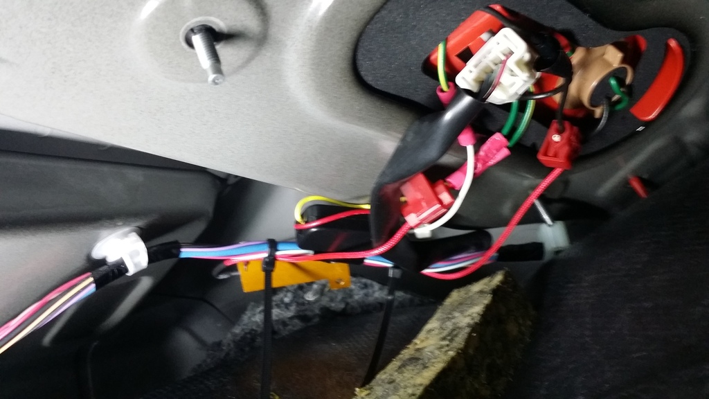

Ordered the DD tail as turn on Monday and got it today. Thanks Nick!
I ended up installing them directly to the taillights. Here are some pictures of the wires cut and the resistor to stop hyperblink.

It's a bit hard to see which wires go where in those pics. Can you help clarify what to cut and connect? Also what resister did you use? Link?

^ I cut the solid green and the green/yellow wire. The resistor goes on the turn signal power (solid green) and ground (black) wire.
I had some extra resistors from when I bought some new switchbacks that I used, if I didn't have them I would've just ordered them from Nick.

Got all the parts in today and completed the install.
I followed this guide to remove the tail lights.
https://www.myg37.com/forums/d-i-y-i...iler-pics.html
I then followed tonyHTX's instructions above. Keep in mind I have the exact model as tonyHTX 2008 G35S sedan. So the wiring colors may differ in later models.
