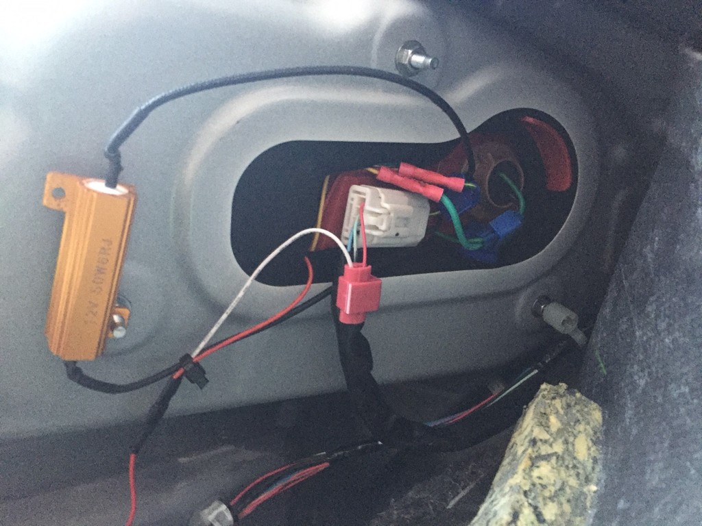

Installed my tail as turn diy kit as well. love this cheap mod! here's another picture of the wiring with a resistor in case anyone is still confused.

Any suggestions on where to mount the resistor?
Old Feb 5, 2016 | 12:42 PM
  #103
Diode Dynamics's Avatar
Diode Dynamics
iTrader: (11)
Joined: Jul 2011
Posts: 2,106
Likes: 142
From: St. Louis, Missouri
Preferably on a metal surface, away from soft plastics or rubber
They will generate heat when the turn signal is in use
Nick C.
