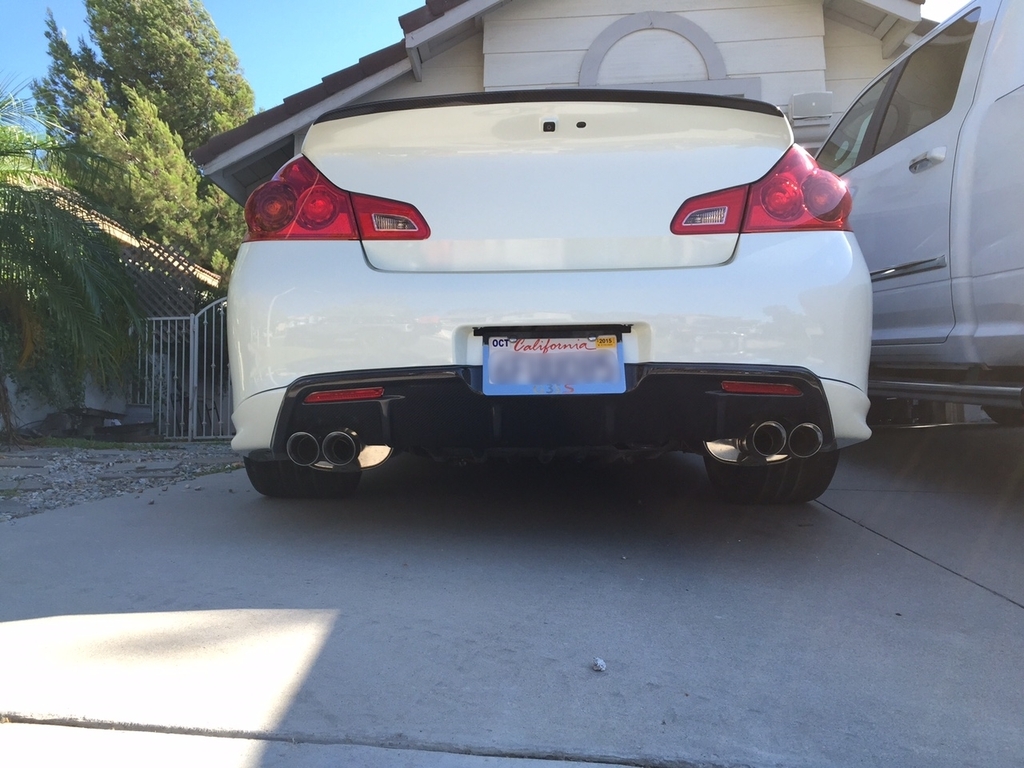

Old Aug 7, 2015 | 06:54 PM
  #58
2GoRNot2G's Avatar
2GoRNot2G
Joined: Dec 2008
Posts: 2,383
Likes: 416
Originally Posted by Diode Dynamics
Absolutely, please send us a PM to receive it
El Stig Garage can install it for you if you are looking for someone in CA
Thanks!
Nick C.
PM Sent.
Thanks for the recommendation, Nick, but I'll probably just do the install myself. I'm a pretty adept DIY'er, so it should be a pretty easy install. Plus, I have some new LED tails in my new rear diffuser that I still need to wire, so I can kill two birds with one stone.
