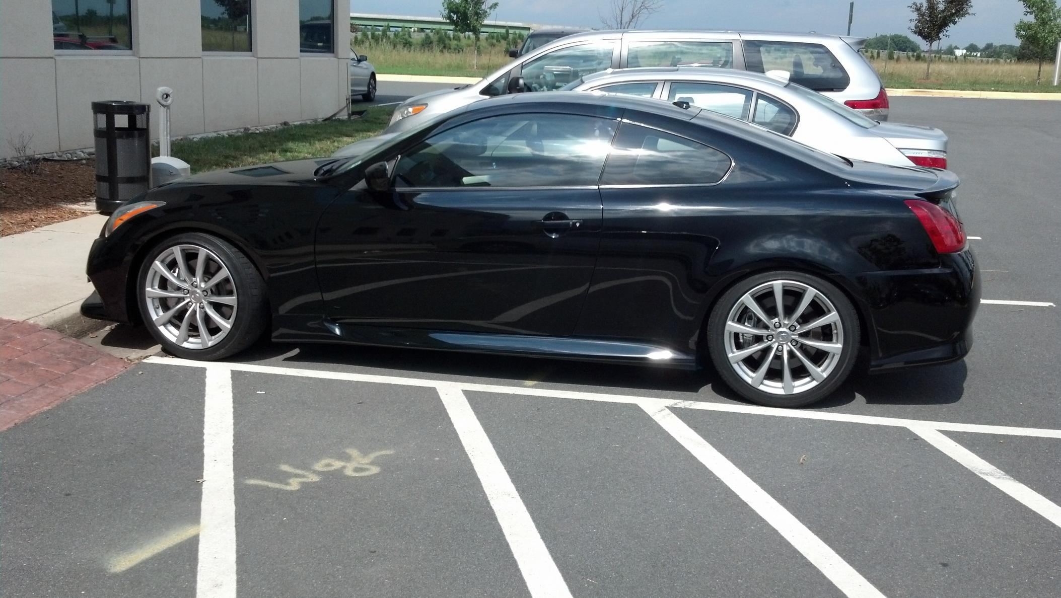

I'm thinking of going 245s and 275s as well. I think TVPostSound did the same deal with the set up your looking for at this thread.
https://www.myg37.com/forums/g37-cou...spacers-2.html
I'm thinking of getting wider tires, but I think with the drop that I have I might be SOL.
