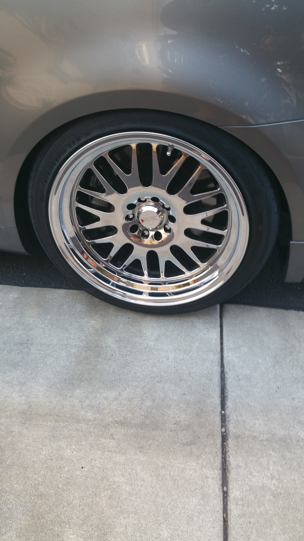

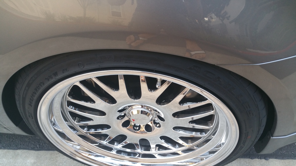

So i just swapped my rear stock springs on my G37s coupe for Tein s techs. Im also sitting on xxr 531s offset 19x11 and axhelies tires offset 245 45 19..... I noticed the drop was quite low and when I took the car for a drive i noticed i was rubbing pretty bad so I cut the fender lining and pushed it back that cleared up 90% of the rubbing. Now when i go into a hard turn on a ramp merging onto the highway it rubs pretty bad and when i go over a small bump the rubbing is pretty painful what are my options i was thinking just get fenders pulled or put the stock springs back on and save for tanabe coilovers

Have any pics? If the tires tuck inside the rear fender then you are probably rubbing on the rear fender bracket, you can trim this back w/ a Dremel tool.

Yea the tire is tucked under the fender here are a couple pics
<a href="http://s864.photobucket.com/user/Simran_Mann/media/Mobile%20Uploads/20150907_184145_zpsh8ihvywr.jpg.html" target="_blank"><img src="http://i864.photobucket.com/albums/ab208/Simran_Mann/Mobile%20Uploads/20150907_184145_zpsh8ihvywr.jpg" border="0" alt=" photo 20150907_184145_zpsh8ihvywr.jpg"/></a>
<a href="http://s864.photobucket.com/user/Simran_Mann/media/Mobile%20Uploads/20150907_184152_zpsdskrglx1.jpg.html" target="_blank"><img src="http://i864.photobucket.com/albums/ab208/Simran_Mann/Mobile%20Uploads/20150907_184152_zpsdskrglx1.jpg" border="0" alt=" photo 20150907_184152_zpsdskrglx1.jpg"/></a>
Yea the tire is tucked into the fender heres a couple pics

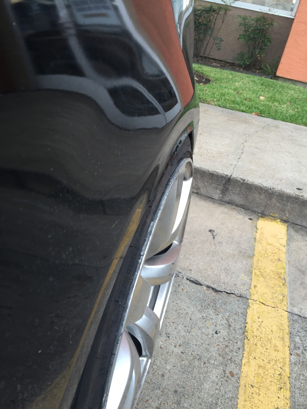

Yeah I heard the same thing too bro until the GTR wheels wouldn't fit and I had to roll them there was no options lol I'm on tein s tech no camber kit and stock struts. Name:  7FC58813-5250-4FC1-A41D-A90E1BC7CB19_zpst13xdgdb.jpg
The fitment was super tight but got it to work man. Rolling the fender did the job lol

If you haven't trimmed the bumper bracket I'd try that first, your fenders should already be rolled, but not 100% sure.

trim the bumper bracket and bend the fender and bumper connector, if that still doesn't help, you might wanna change the tires with thinner sidewall.
