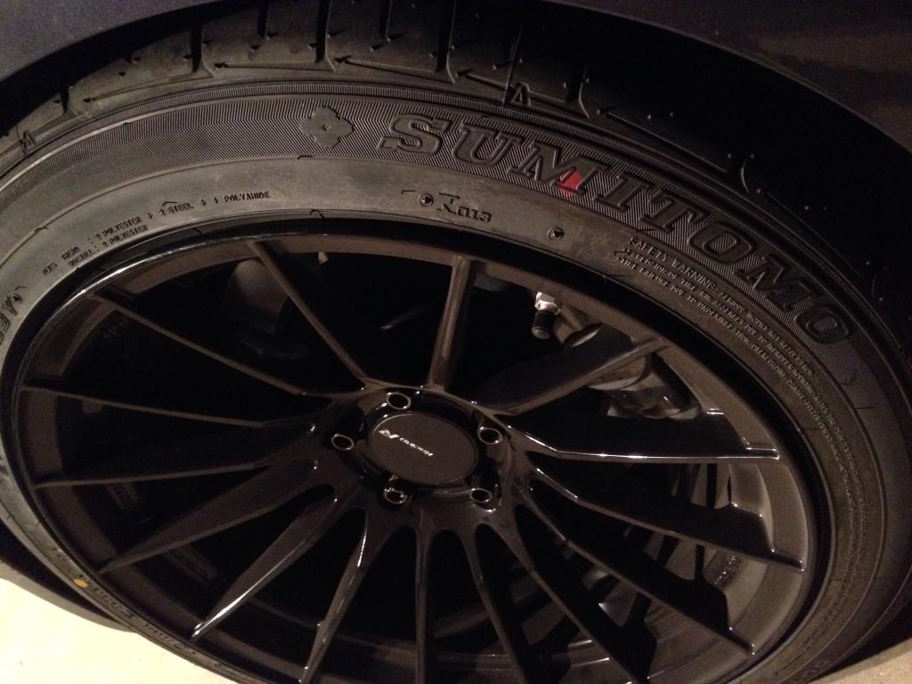

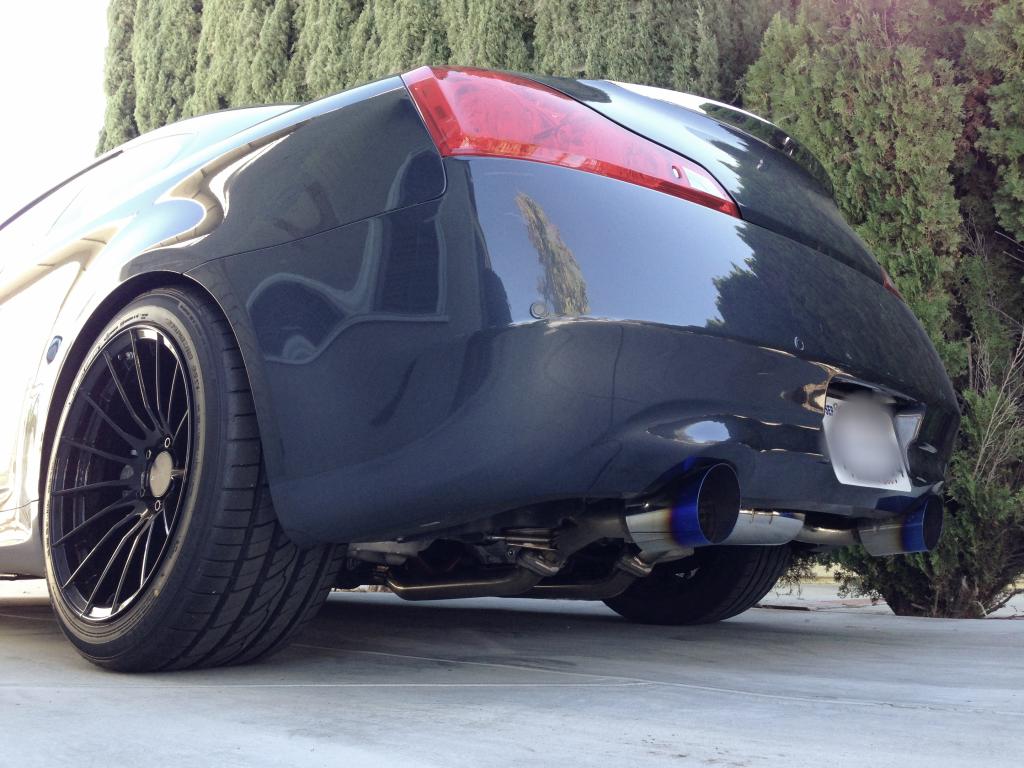

Enkei RS05RR
Front: 18 x 9.5 +22 | 245/45r18 HTRZIII
Rear: 18 x 10.5 +35 | 275/40r18 HTRZIII
Old Dec 8, 2014 | 01:47 AM
  #943
kdawg8526's Avatar
kdawg8526
Posts: 896
Likes: 46
From: Van. BC
nice did you need spacers to clear brakes im looking for some light weight wheels
Old Dec 8, 2014 | 02:51 AM
  #944
rays's Avatar
rays
Posts: 101
From: Los Angeles
Thanks kdawg, I didn't need any spacers. With these specs, there's more than 5mm clearance with the akebonos front and rear. I have the "R face" in the rears (most concave face) but had to run a M face (less concave) up front to clear the brakes. If you want the most concave face up front, you'll need to run a more aggressive offset or width.
You should consider these wheels if you want light wheels..RS05RR in this size weigh in around 19lbs
Old Dec 8, 2014 | 08:27 AM
  #945
Robert_K's Avatar
Robert_K
Joined: Oct 2006
Posts: 1,489
Likes: 126
From: Houston, Tx
Looks good but I would've started with a 285 or 295 on the 10.5 rear.
