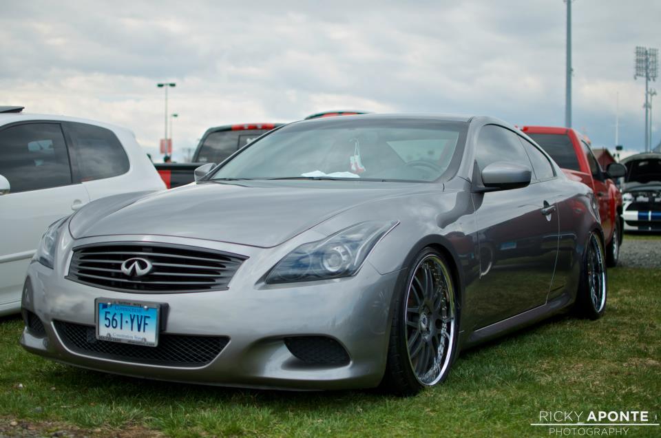

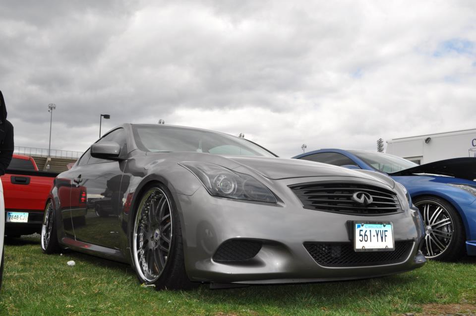

Not super aggressive/fat. +25 in the rear,i believe, but the 275 rears with that -5.2 rear camber sure makes it look damn aggressive
Car looks good but need more tire!
