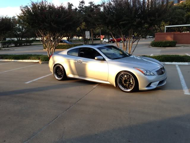

Originally Posted by Robert_K
Still working out some fuel issues. However took it out of the shop for a exterior detail and photo shoot. Below is a teaser...
I really like it. Is that the Varis kit on it?
Old Aug 14, 2012 | 10:09 PM
  #123
Robert_K's Avatar
Robert_K
Joined: Oct 2006
Posts: 1,489
Likes: 126
From: Houston, Tx
It's a mixture of parts;
~AeroSync Nismo front fascia w/ CF duct
~Seibon CF Hood
~Nismo sides
~CraftSquare Mirrors
~Seibon CF Rear Lip (Custom painted)

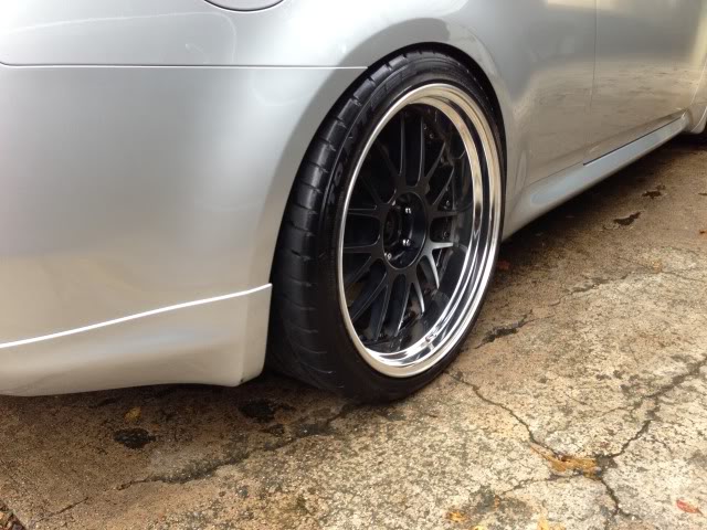

Bringing this one back to life!!!
245/35/20 +25
285/30/20 +18
Size:  66.2 KBName:  IMG_0200.jpg
Old Oct 25, 2012 | 03:03 AM
  #125
kdawg8526's Avatar
kdawg8526
Posts: 896
Likes: 46
From: Van. BC
low offsets with wide tires = win
20x10 in back?
Old Oct 25, 2012 | 06:03 AM
  #126
Robert_K's Avatar
Robert_K
Joined: Oct 2006
Posts: 1,489
Likes: 126
From: Houston, Tx
Looks great!!!
Old Oct 25, 2012 | 09:28 AM
  #127
TheGanglyGoon's Avatar
TheGanglyGoon
Joined: Apr 2012
Posts: 754
Likes: 42
From: Dallas, Tx
20x10 in back?
20 x 10.5!!!
Old Oct 25, 2012 | 11:11 AM
  #128
kdawg8526's Avatar
kdawg8526
Posts: 896
Likes: 46
From: Van. BC
nice!!!!

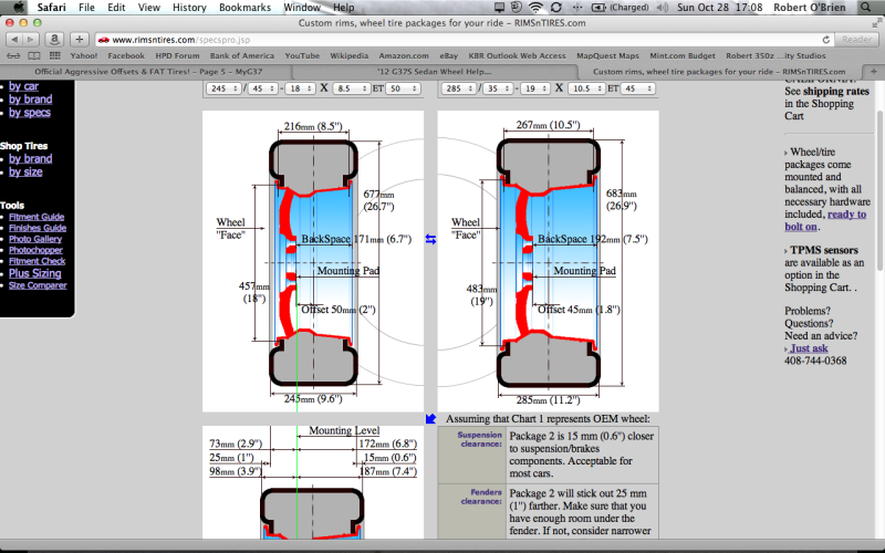

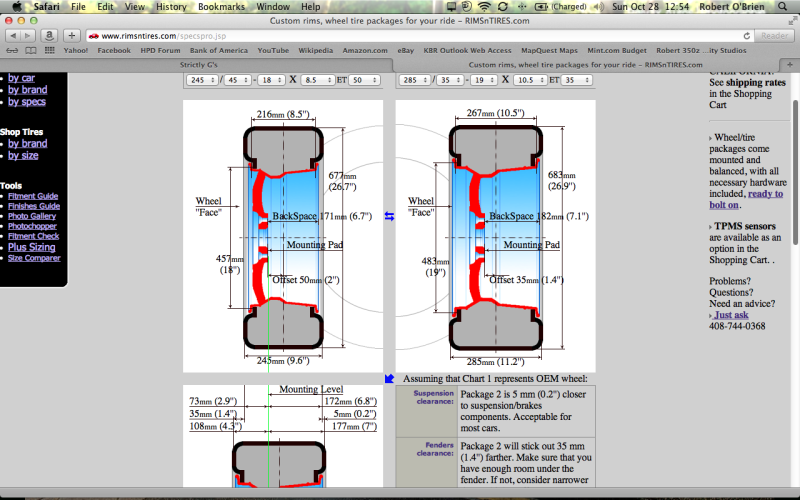

So I'm back looking at sizing for my 2012 S sedan. This is what I came up with;
19x9.5 +35 255/40
19x10.5 +35 285/35
However I'm questioning the rear fitment. Seem most sedan owners have done a 19(20)x10.5 +45 fitment.
Whatcha'll think?
Old Oct 28, 2012 | 12:02 PM
  #130
kdawg8526's Avatar
kdawg8526
Posts: 896
Likes: 46
From: Van. BC
it should fit but u might need a lil negative camber
Old Oct 28, 2012 | 12:45 PM
  #131
Robert_K's Avatar
Robert_K
Joined: Oct 2006
Posts: 1,489
Likes: 126
From: Houston, Tx
I prefer a square alignment so negative camber is not going to happen. I like SoundMike's set-up but, I want to run a 9.5" front. And you can see the 10.5" +35 on his last picture below.
Originally Posted by soundmike
245/35/20
8.5 +24
285/30/20
10.5 +45
I know you said 3 pics, but here's another shot with the original rears at +35. Could've fit with more camber.
Old Oct 28, 2012 | 05:05 PM
  #132
TeRRoRiFiC35's Avatar
TeRRoRiFiC35
Posts: 1,024
From: Jersey Shore....
19x9.5 +35 255/40
19x10.5 +35 285/35
Whatcha'll think?
That rear is going to be aggressive. I ran 19x9.5 +32 in the rear and those were aggressive with stretched tires. It wouldnt fit with square tires.

Old Oct 29, 2012 | 04:56 AM
  #134
Robert_K's Avatar
Robert_K
Joined: Oct 2006
Posts: 1,489
Likes: 126
From: Houston, Tx
I think a +45 is a "perfect" fitment for the G37 sedan. A +40 or +35 might not look so great. I'm gonna stick with the 19x10.5 +45 (285/35) rear. Now to lock in the front offset for the 19x9.5 (255/40).
