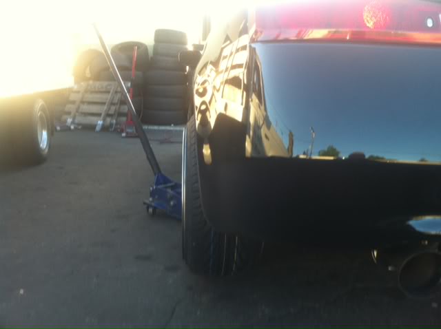

my new stretch, 245/35/20 on a 10.5, spacers coming next

Old Jun 23, 2011 | 03:28 PM
  #640
Weiboy718's Avatar
Weiboy718
iTrader: (10)
Joined: May 2007
Posts: 4,967
From: Homo Capital!
Watch it goes kaboom!
Just kidding haha.
Old Jun 23, 2011 | 03:31 PM
  #641
Doggy's Avatar
Doggy
Joined: Jul 2010
Posts: 4,354
From: Sf valley
Dont scare me wei!

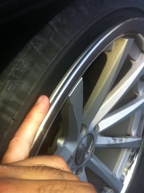

now this is poke and stretch

Old Jun 23, 2011 | 04:50 PM
  #644
fairladyz34's Avatar
fairladyz34
Joined: Oct 2010
Posts: 1,360
From: Central NJ
indeed it is!
Old Jun 23, 2011 | 05:02 PM
  #645
GraphiteG37S's Avatar
GraphiteG37S
iTrader: (29)
Posts: 7,107
Likes: 19
From: Simi 805 - SoCal
Doggy, clean your dirty @ss wheels and shave your knuckles!
