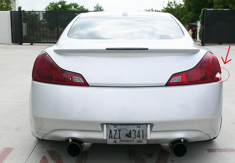

Damage to rear brake light.

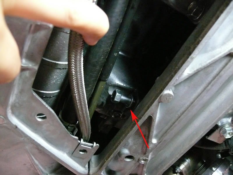

Bolt left loose.

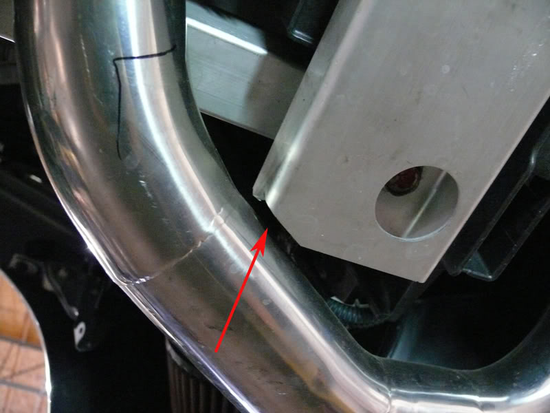

Bracket left unsecured.

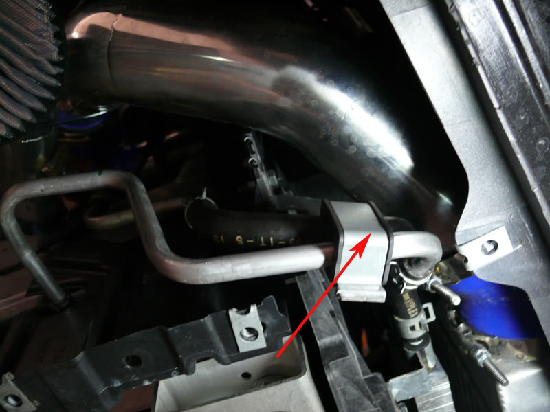

Power steering lines hitting intercooler piping.

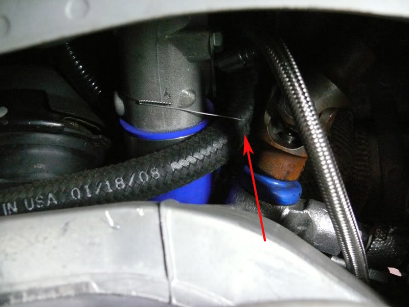

Thin wire cutting into oil return line.

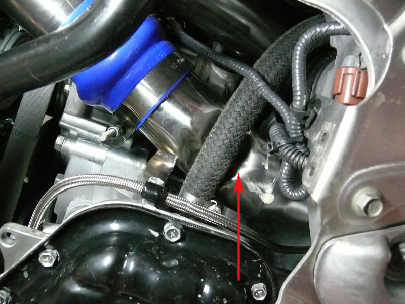

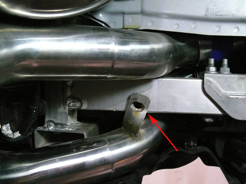

Wrong piece of intercooler piping used. Bracket cut off instead of using correct piece of piping.

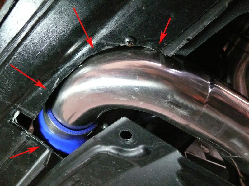

Plastic undertray cut to fit piping. Plastics left loose and unsecured.
Sub-frame cut to clearance piping.

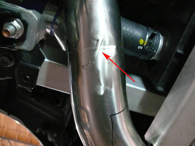

Piping crushed to clearance oil return line.

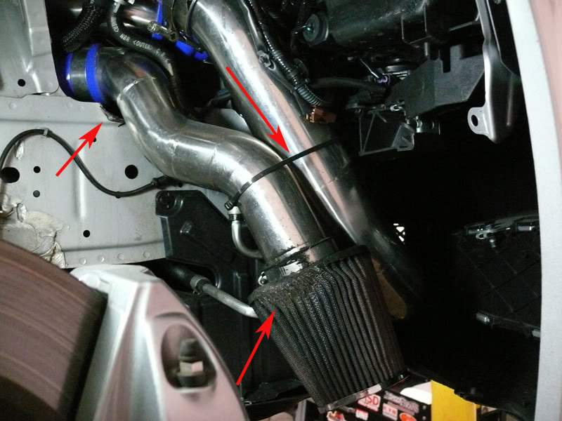

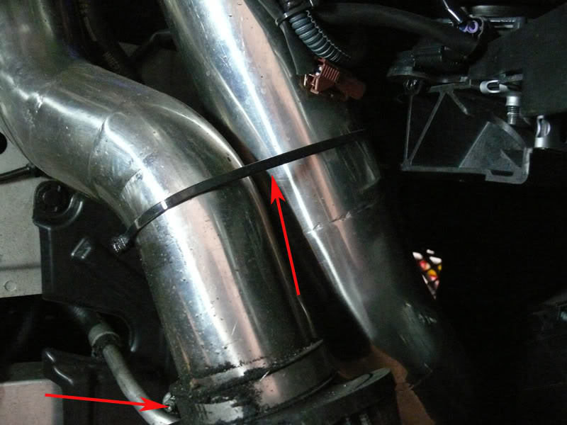

Intake and intercooler piping zip tied together. Debris on intake filter and connection.
More of same zip tied piping and debris.

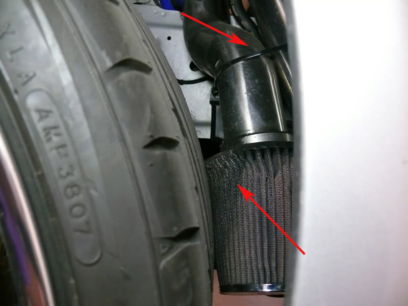

Reason for debris on intake. Tire was rubbing intake due to improper installation of kit.

I installed the same GTM Twin Turbo kit in the back of my yard, with the car on jacks. I am by no means a car mechanic and I've only done small DIY projects. But the turbo install was pretty straightforward with the instructions provided by GTM.
With that said, how could a professional auto performance shop butcher the install this badly?

i cant believe they left unsecured bolts and the air filter rubbing the tire?
i could imagine the rattling your car makes on the road.
i feel sorry for u, i hope u get those issues resolved.
