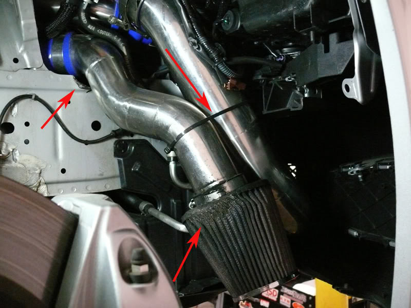

But, the motor is secondary, IMHO, to the incredibly shoddy work done in this build. The pictures. Wow. Do people realize that eventually that filter would have either been ripped off or worn through by the tire and EVERY BIT of road debris, rocks, pebbles, etc. would have been direct injected into the intake?!

^ that's what I was thinking about the location of filters being in the wheel wells. What kind of design is that? Or is that a decision at the time of install? From a business perspective this case should have been handled better so it doesn't end up in places like here. Pictures don't lie.

It's really the only place for the filters. Not too many other options. I think APS started that trend with their TT kit.

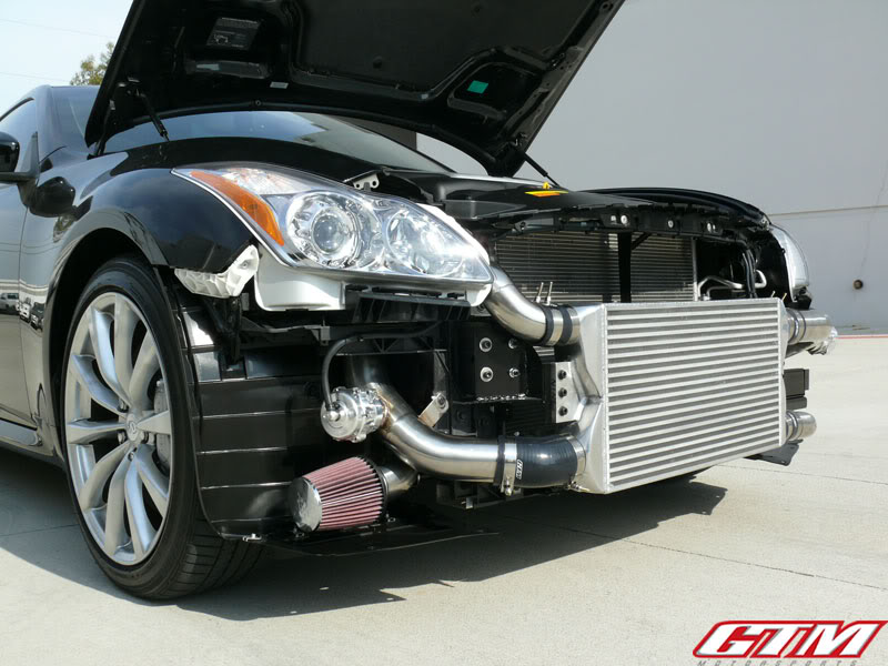

The filter is mislocated. This is evidently the driver's side. Maybe the wrong piping was used? Big difference between this:
and this:
Old Apr 10, 2010 | 11:51 AM
  #45
TTZ2G's Avatar
TTZ2G
Joined: Mar 2010
Posts: 177
From: Orlando
^^^ yes, THAT filter is moslocated. Both sides should be behind the liner.
