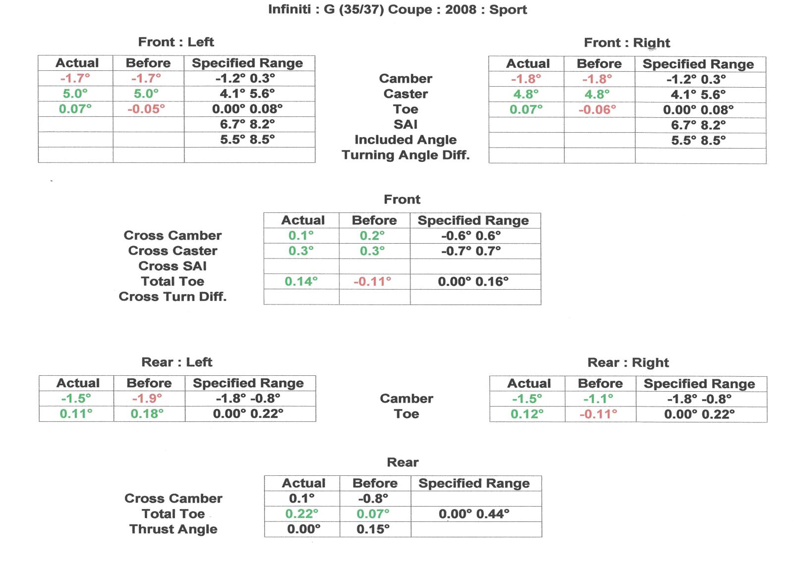

See attached pic for alignment specs. They did it in about an hour and checked the springs too.

Hmm...I gotta be honest, those specs don't look too good. It barely looks like they did anything to your car. If you look up alignment results from some of the other people who bought the Pro Kit they were able to bring theirs much more in line with factory specs. Heck, for some of those numbers, I'd think they're almost within measurement noise of the alignment rack.
Did they let you watch them do it?
Old Jun 10, 2011 | 03:38 PM
bocifus715's Avatar
bocifus715
Posts: 61
the only thing that's out of spec is the front camber and thats factory preset so the only way to fix that would be camber arms. I was looking at alignment specs from other people and mines only a few tenths of a degree difference.
everything else was pretty close to begin with so only very minor adjustments were needed.
