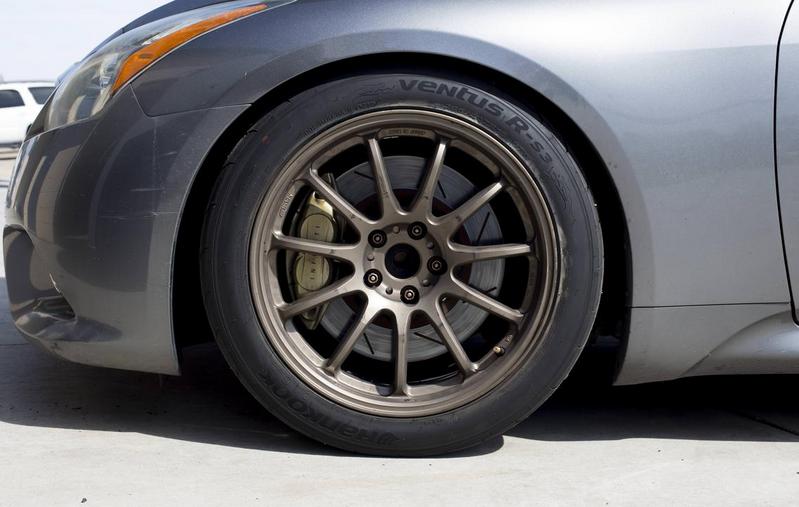

So a double post/quick update on the Z1 subframe collars (and I suppose the urethane diff bushing as well) from a quick session on the track.
Did 5 20 minute runs at Buttonwillow Raceway this weekend, and from what I can further tell from pushing the car on the track, the rear end does feel a TINY bit more settled through some of the rougher sections as well as when you hop curbs. I haven't made any other changes to my suspension nor alignment settings since the last time I was here sometime last year.
However, as previously stated (and similar to the results on the street), the main difference you will really feel will be in transitional throttle response - I could get on the power much sooner and with much quicker reaction times than I could before, even with the automatic. Obviously, the auto lags. But manually shifting it, and knowing when to apply power makes the best use of those two mods.
That being said, my brake calipers are now gold due to heat. It's pretty sweet.
Welcome to the gold caliper club.
