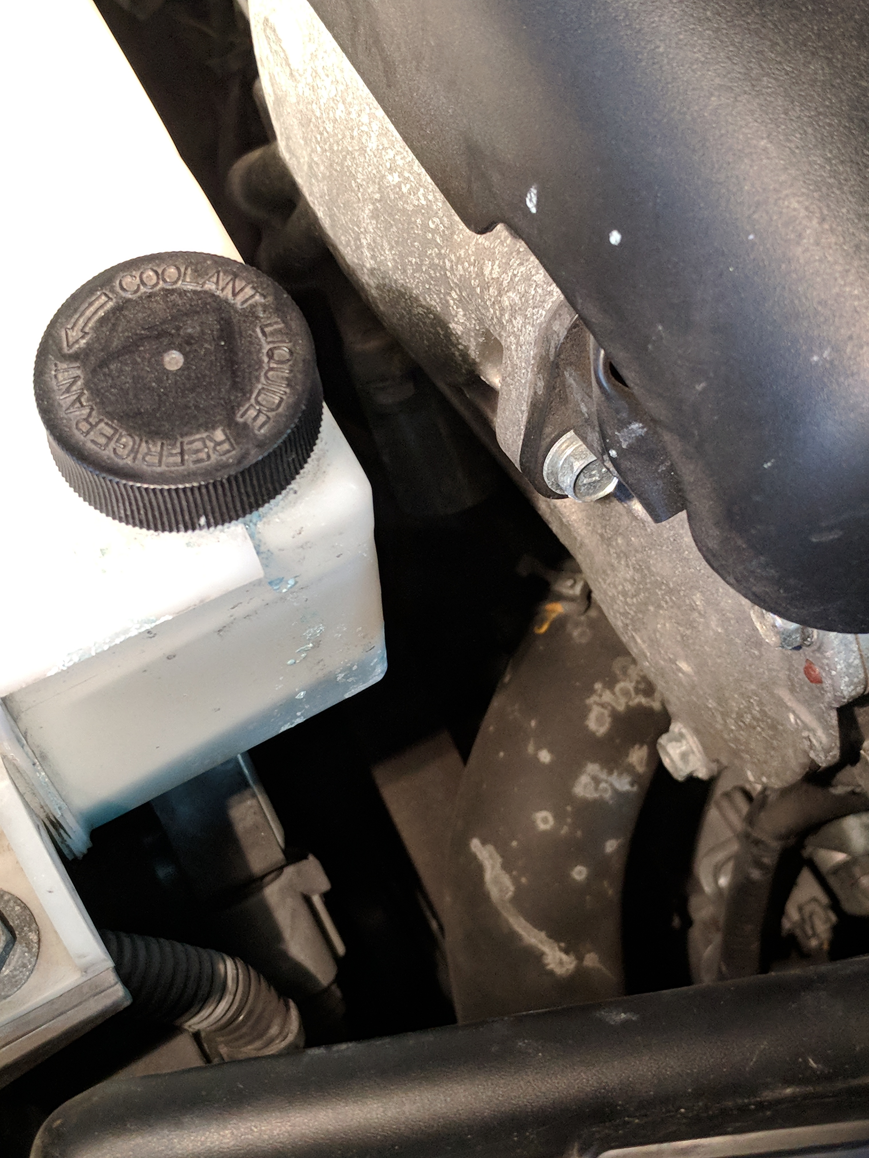

While the coolant system pressure was good as evidenced by your temps, it appears the cap should be replaced. I have no idea what rubber is used so I would just cough up the bucks necessary to replace it. Make sure you're not overfilling the expansion tank, too.
I haven't checked your build thread so I don't know if you have an oil cooler. The valve train is oil-cooled exclusively. Well, except for the head-valve contact area...
The cap is perfectly fine, but it is hard plastic on hard plastic with no seal from the factory so I was figuring a rubber seal would probably fix the issue on track. That seemed like the easiest fix, but I wasn't sure if anyone else had a similar issue. The expansion tank is not overfilled, but it appears to be sloshing around too much on track for the stock cap.
I do have an oil cooler.
Originally Posted by FlashGuy
Do you drive with your oil cooler uncovered? In lower temps, it could be over-cooled. I had mine blocked in the winter and saw temps between 167 and 178 in normal driving. Now that it's "summer" (88 today), temps are getting up to 200 covered. Will be taking off the blocking plate this weekend and will report back.
For the coolant overflow, I get that from time to time. It just seeps past the cap. I think on the 12+ 370Z they switched over to a pressurized overflow system with the same cap as the rad to prevent this. Was thinking about going that route when I upgrade the rad.
Glad to hear I am not the only one who leaks coolant from the overflow tank. I was trying to find pictures of the newer Z coolant overflow tank. It does look like a pressurized system now with an entirely different coolant overflow tank. Is there a cap that would work for my overflow tank without changing the entire cooling system or would I probably be ok just adding a rubber washer under the cap?
I do not cover the oil cooler as it has a thermostat to handle the wide range of temps we get here in WI.

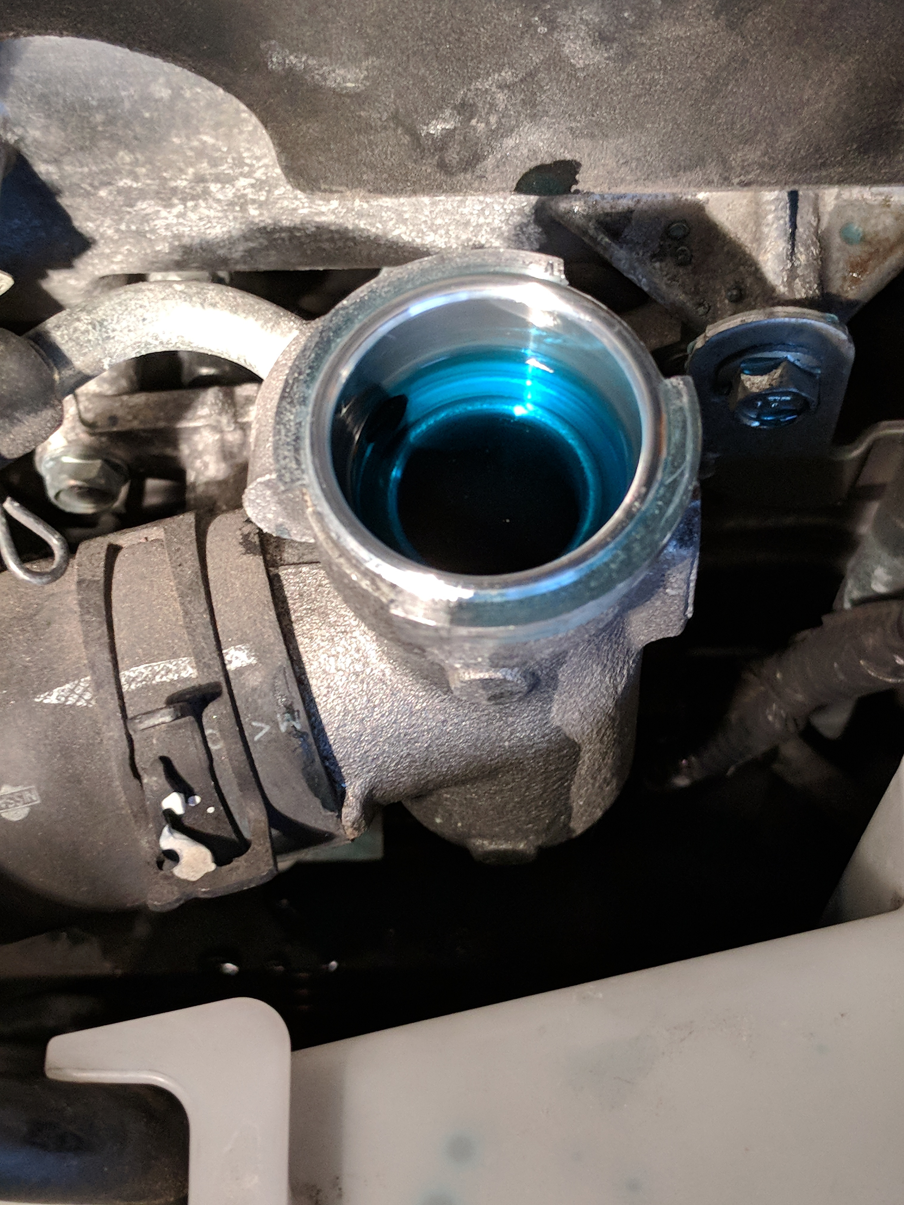

I wouldn't worry about the coolant, I get the same but it's never enough to drop the fluid level in the system: see attached photos.
