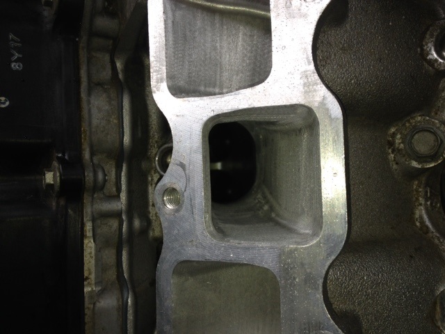

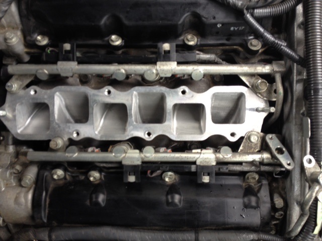

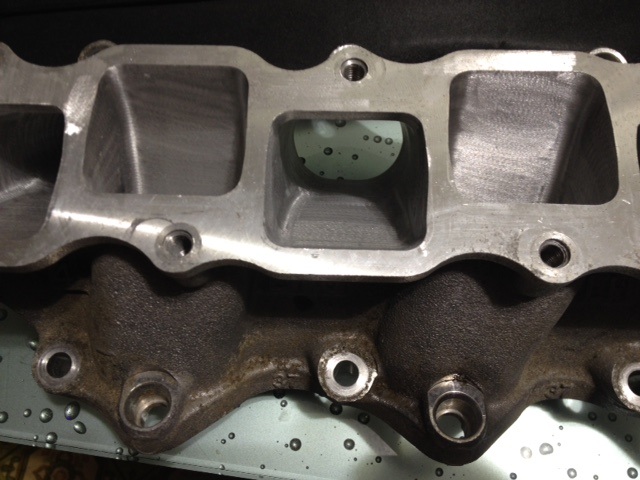

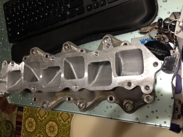

Got the lower from Scott and man it looks great! Installed yesterday and should have some driving notes this week. No dyno this weekend, Will have to be on the 13th. ;/

That looks great! Do you have any idea of how much material was taken off?

Idk if I'm aloud to say here cause I'm not a vender (all transactions were done on another forum admins) but I removed an *** load! His two halves with the casting marks were crazy off! Along with 100% removal of both bumps in each runner it was quite a lot. I could of removed more however but without the heads and upper it's hard to do or I could remove to much and cause a lip at the heads. Also you don't want to remove to much in the middle, which you could, because you'll have a small opening coming off the upper mani, have it open real big, then neck back down going into the heads. I'm not sure an hour glass shape would help flow.
