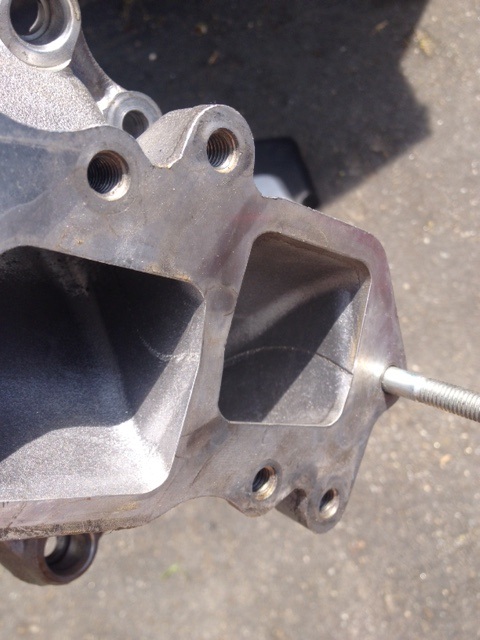

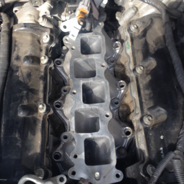

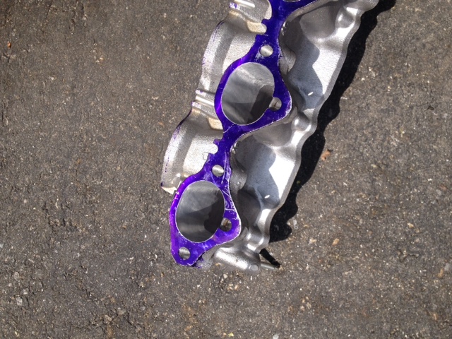

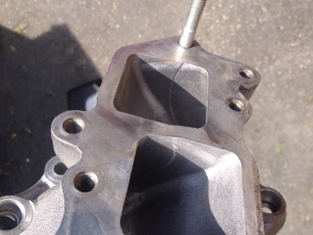

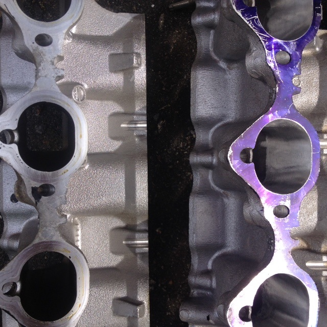

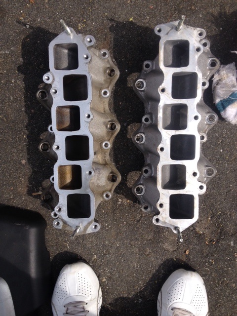

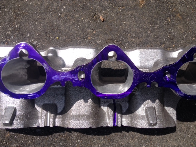

So I went and picked up my ported lower from Grantie State tuning. I wasn't really happy with the job they left lips and a grove in every runner :/, The casting marks, they tried to tell me the lip would make zero difference. I cleaned them up anyways when I got home and the install went perfect, The hardest part for my was the fuel rail attachment to the regulator stock fitment is very snug and almost zero wiggle room. I got some drive time on it last night really didn't get on it too hard( Wife was with me) But theres something there just not sure what or how much yet the upper mid ranges feels really good tho I should have more this week.
on to the pics, First pic is the lip they left in every runner last one is after I cleaned it up( smoothed it out)

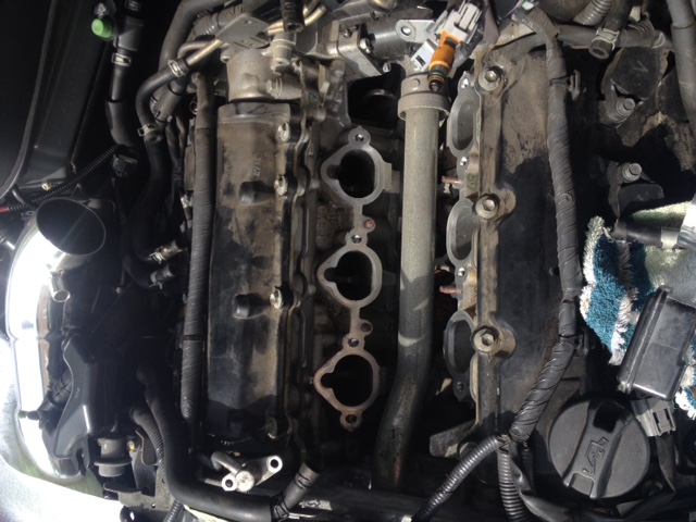

More pics, last on the finished install
Attached Thumbnails Up coming intake manifold testing.-ported-side-runner.jpg   Up coming intake manifold testing.-tear-down.jpg   Up coming intake manifold testing.-porte-lower-done.jpg

So with some drive time behind the wheel I can say this is worth it ! There is definitely something there the exhaust note has changed , More burble, car builds up quicker and more( Seat feel) and top end really feels more of a swell ( If I’m saying that right) it feels like a level off like its flying? LOL. I also made 2 runs before I lost the DAMN OBDII plug for my UPREV and the cars lean up top, 13’s. So the there is more flow as I was around 12.1-12.3 before I swapped over the ported lower. I have a dyno set for June 6th at 9am so we’ll see. But if you can get this done I’d say do it.
