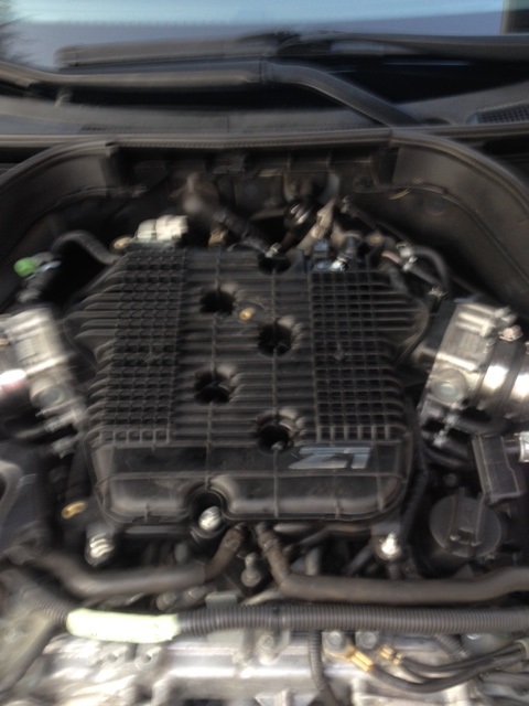

Finally got my Z1 mani today and installed it before I went to the gym heck only takes about an hour to flip it around !

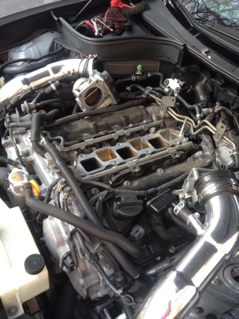

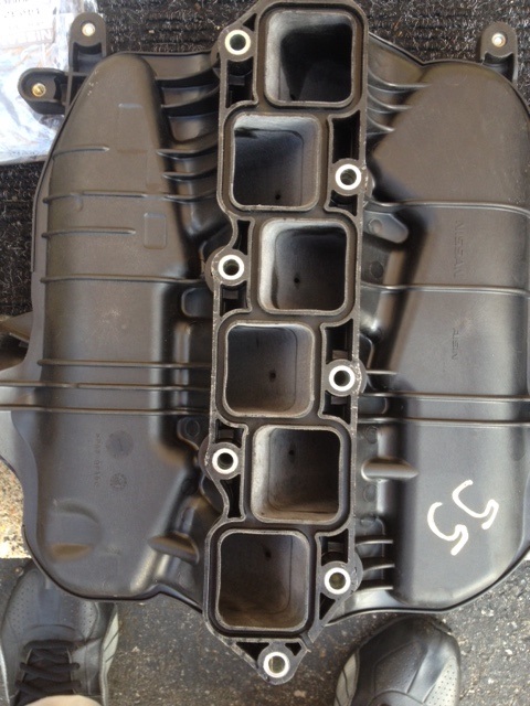

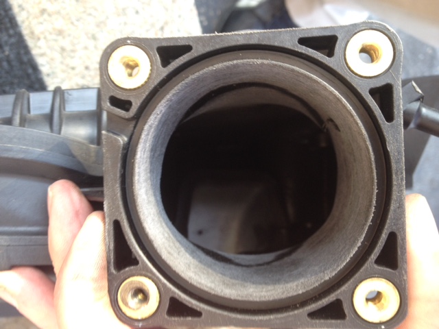

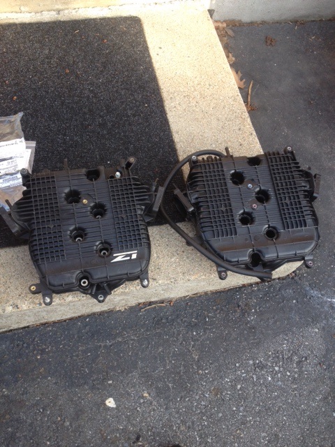

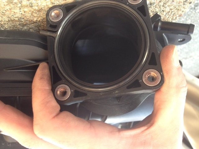

Very good, They feel almost the same except for above 6200, Z1 pulls more but we all know that, the dyno will tell in 3 days . On to the pics

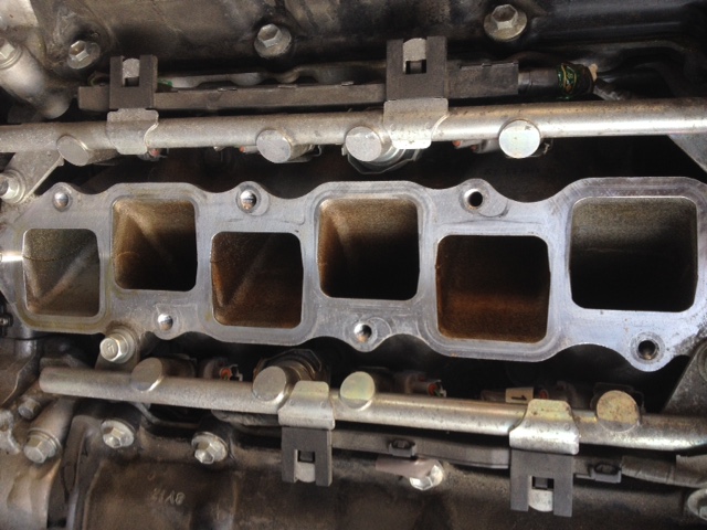

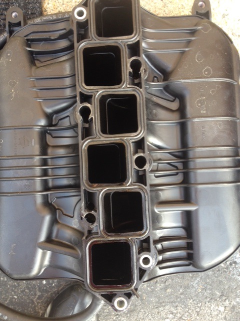

Few more, Does everyones lowers look this? I have two really clean ports and the others with very little oil. I guess this would be clean
