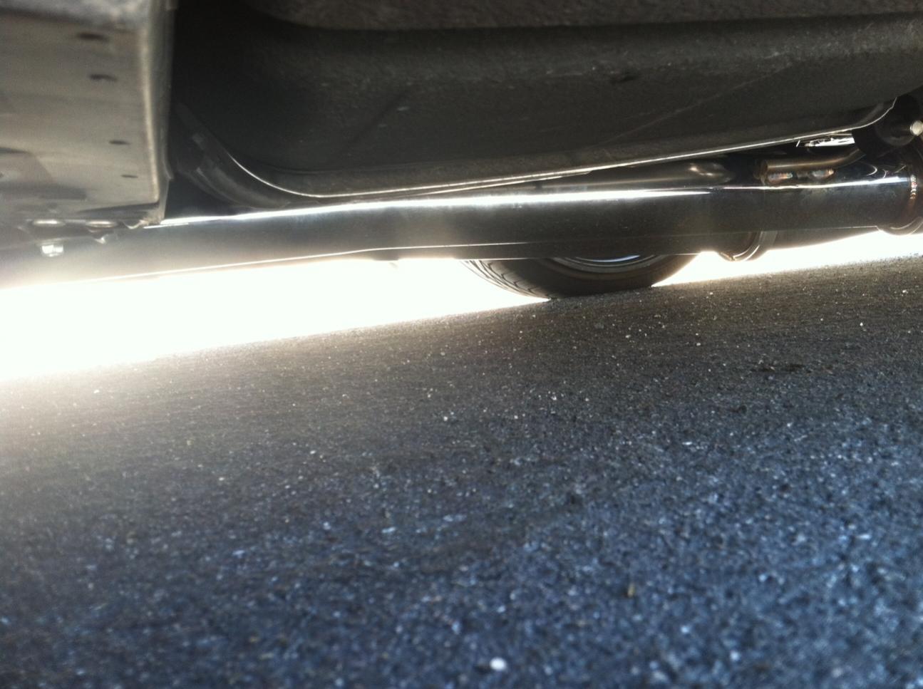

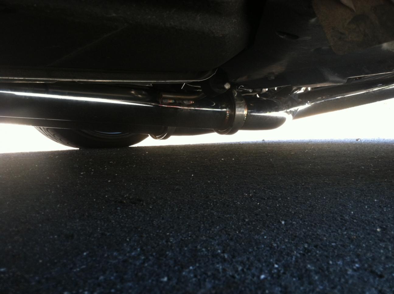

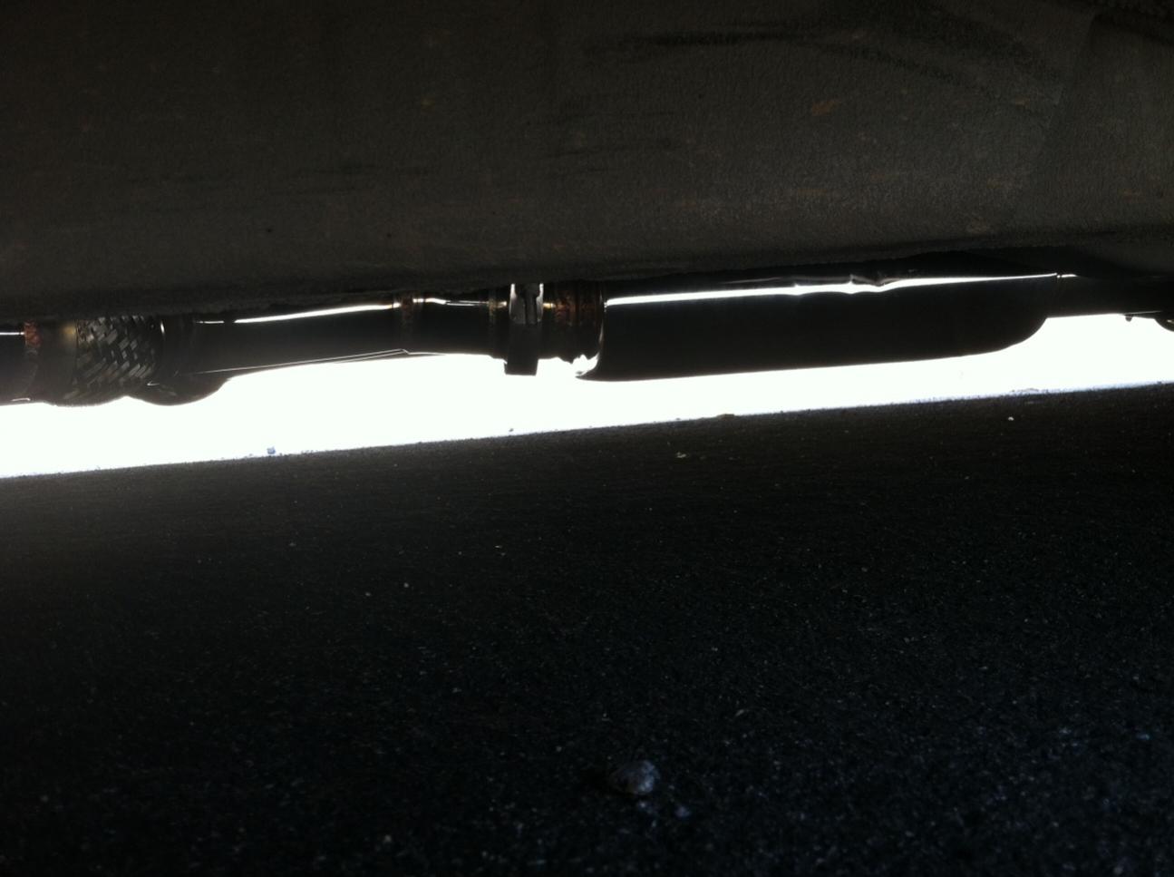

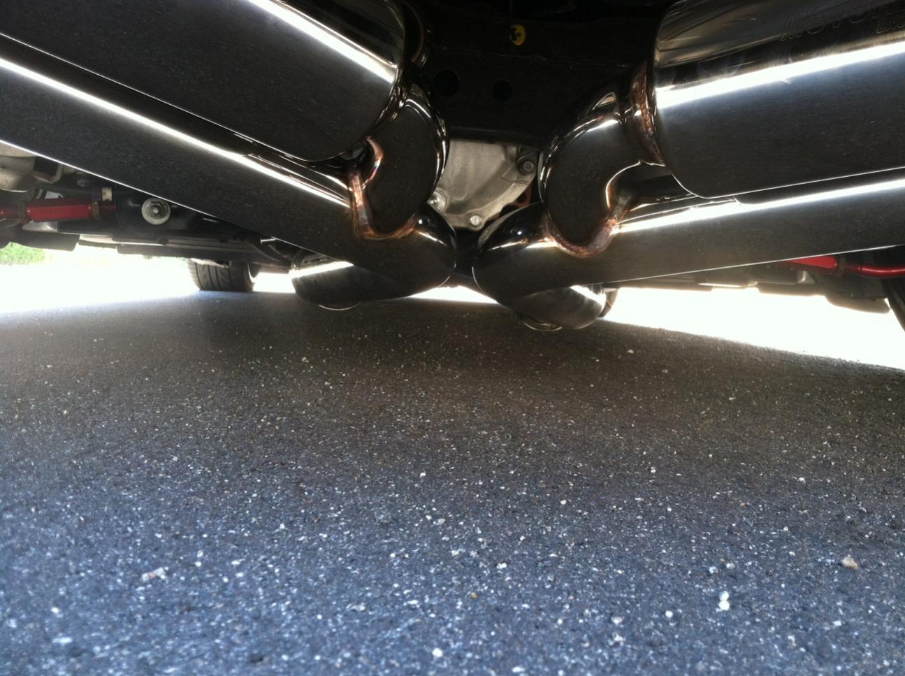

dopetime's Avatar
dopetime
Posts: 535
From: AZ
MadMaxx:
when you say the center muffler should be angled up relative to the resonator box meaning that it sits lower than the XYZ section then correct? if so then I have it the right way.
Attached pics for reference.
Attached Thumbnails New Motordyne Shockwave E370-photo-1-1-.jpg   New Motordyne Shockwave E370-photo-2-1-.jpg   New Motordyne Shockwave E370-photo-3.jpg   New Motordyne Shockwave E370-photo-4.jpg

MaDMaXX's Avatar
MaDMaXX
Posts: 63
From: Oregon from England
I *think* from your pics, that it's the right way, let me try and explain it a little better.
If you look at the resonator from the side, the single pipe side of it should be angled upwards.
Looking at your pics, i can't quite tell where your rear section is, but i would imagine that if your rear diffuser is lower, you're going to struggle aligning the tips, you mentioned the spacers, i assume they're all mounted ok on the rear exhaust hangars? you should be able to see them even when the brackets are fitted.
The lowest point is the vband joining the mid pipes to the axle backs, how much room have you got above that?
Also remember that this is at the point of the 'axle', so it's not going to have anything get closer to it from the ground unless your start traversing weird ground.
