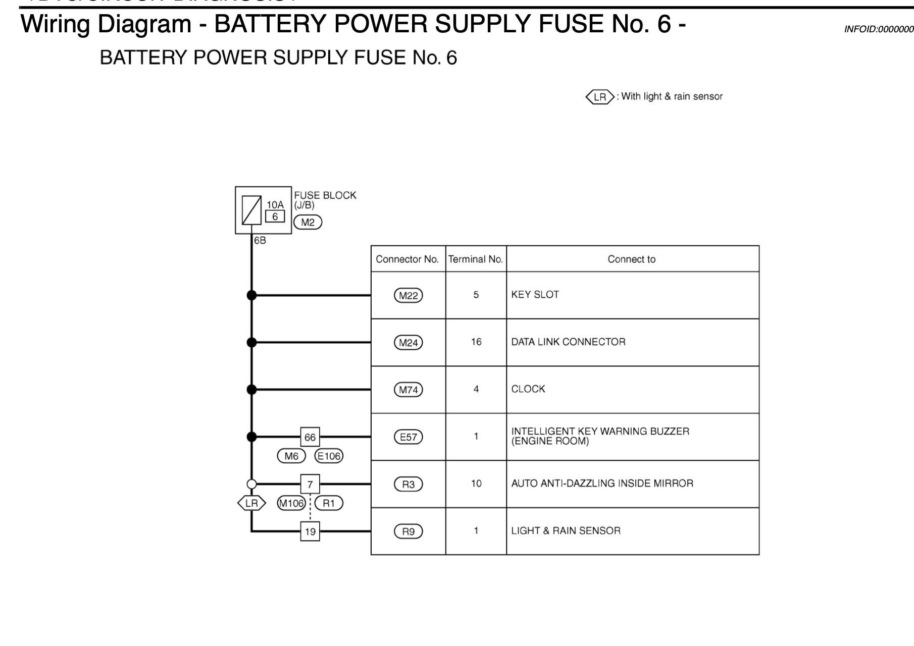

Woah there, sometimes the answer actually is the simplest one.
Check fuse #6 in the fusebox near the driver's left leg.

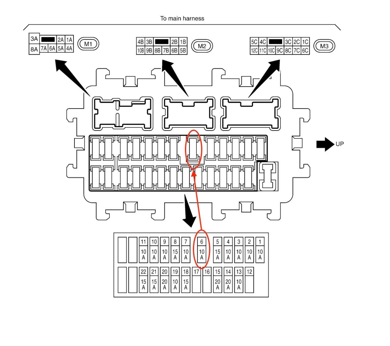

Hi all, thanks for your feedback and suggestions.
I went to take a look at the fuse box and mine looks like this (see below).
The fuse #6 would /should be located where this white plastic piece is - I don't see a 10A fuse althought I also didn't pull it out cause I went to take a quick look and didn't have the necessary tools (thought a fuse puller would be in there but no luck). I'll have to go back with some pliers tomorrow.
Shall I pull this bad boy out?

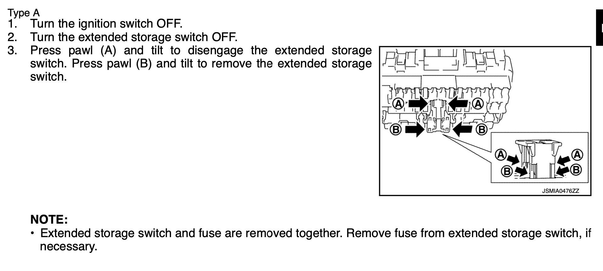

Yes indeed, that white thing you're looking at there is the "extended storage switch" used for shipping or longterm storage. Pulling that white piece outwards pulls your #10 fuse, but holds it in place so that you can just push it back in. So the first thing to check is whether that piece is pushed in to it's normal operating position.
If it is ... then to check the fuse you need to remove it. Instructions below. Note it also says you can leave the white piece off once you've removed it for easier access to that fuse.
