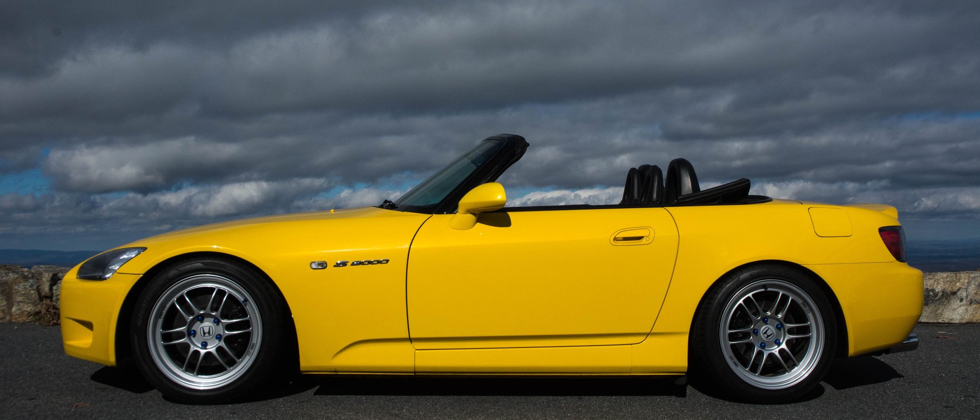

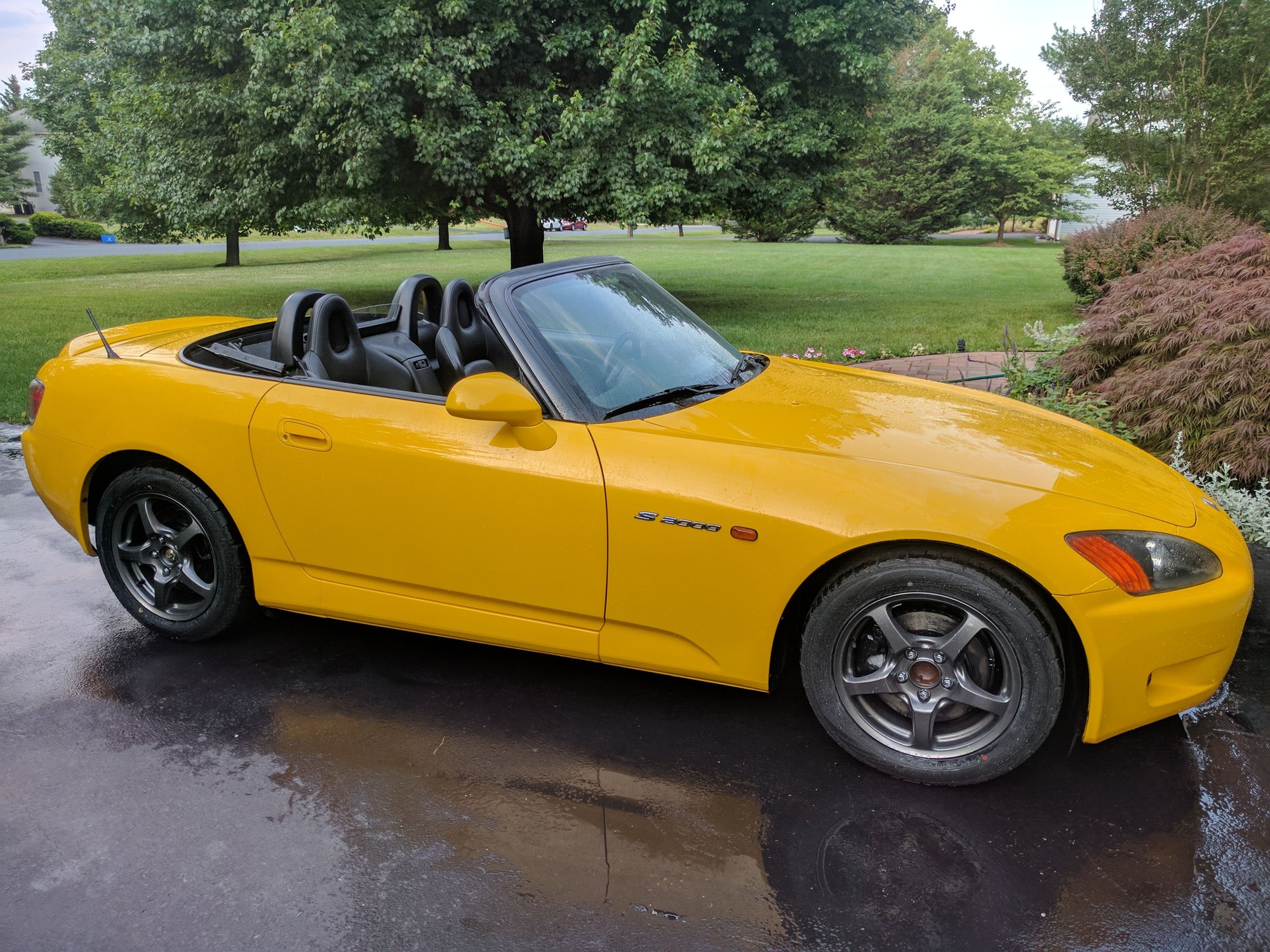

That actually looks really good, but for some reason the S2k they just look way too tiny.
This is what i have now
