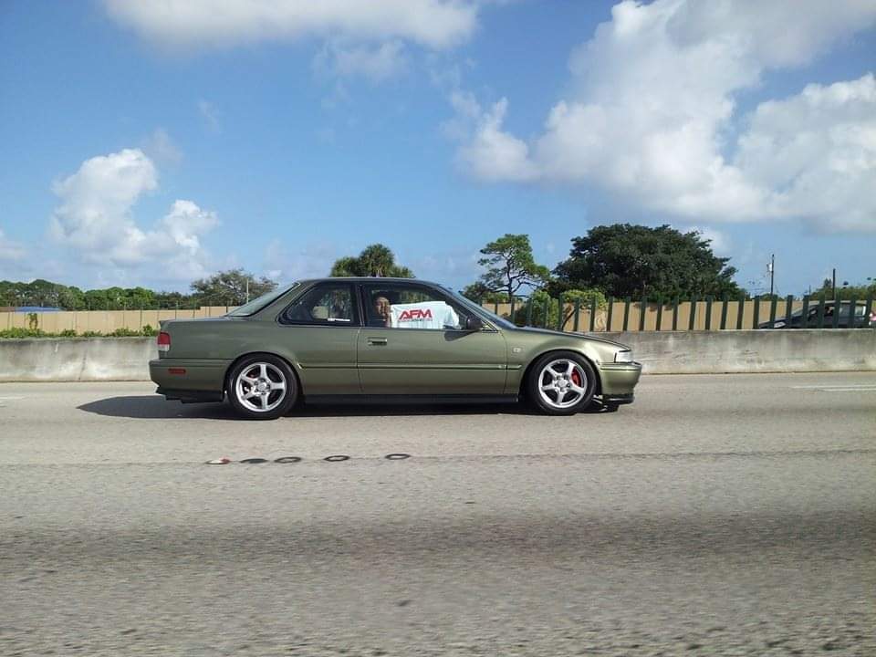

I rocked the **** out of the stock AP1s. Here's my old accord rocking all rear AP1. The front was fun to fit
