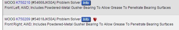

I would purchase some new sway bar end links (stablizer bar link on ROCK AUTO) and get those installed. After new links are on then go get your tires balanced and aligned. I attached a screen shot of the links for your car on rock auto . com
good luck.
