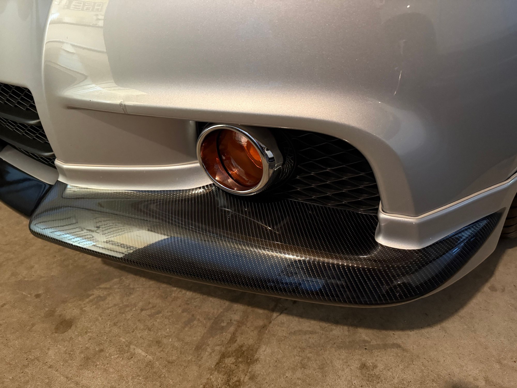

everyone needs a good interior guy. Electrostatic applied felt with adhesive.
new carbon fiber PPF looks like real CF. Huge upgrade from the previous vinyl. Picture doesn’t do it justice

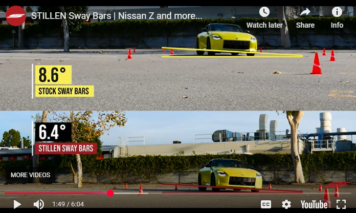

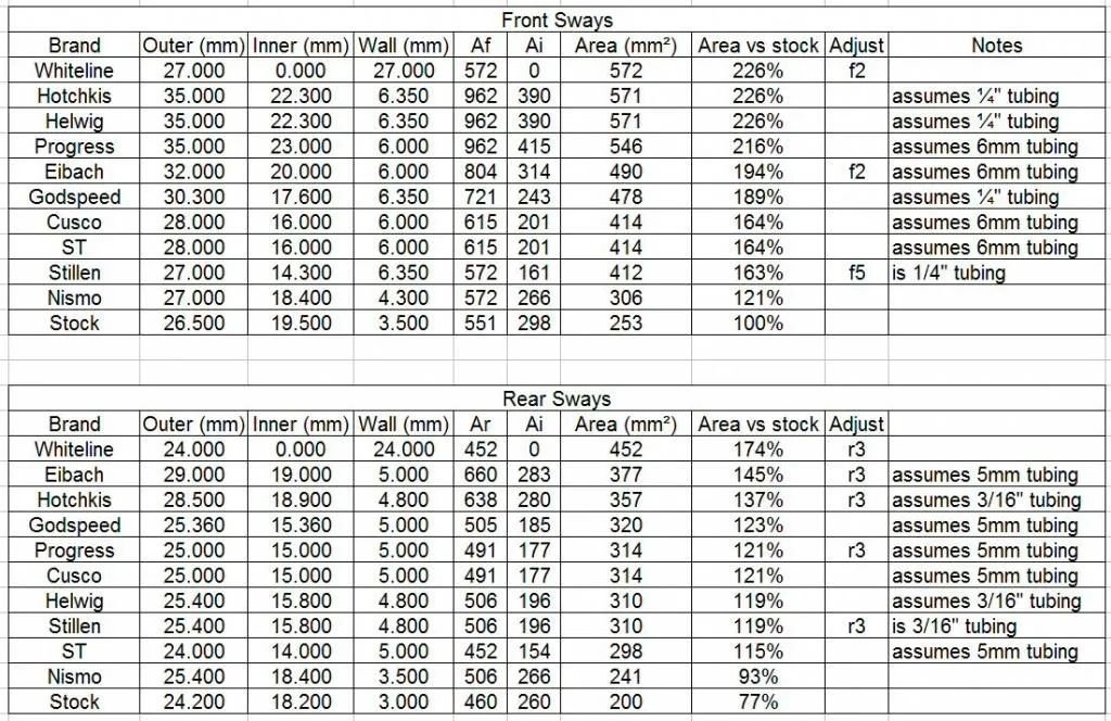

I'm still not convinced that bigger is necessarily better when it comes to sway bars. I understand that one can use increased area over stock to dial in much more oversteer and have zero body roll, but is the ability to push the rear of your car out easily and not distribute the load to the tires on the L/R what's being measured as the performance gain? On a DD, what are the tradeoffs of not being able to transfer some of the roll from side to side?
I found some interesting tidbits on the topic in Stillen's blog here: https://www.blog.stillen.com/stillen...ide-sway-bars/
Assuming that RWD of the following FM platforms use the same diameter front and rear sway bars: RWD Sport Coupe and Sedan & RWD 370Z, then look at the diameter used on the much more aggressive 370Z Nismo. It seems Stillen took the Nismo formula, and added some level of adjustability to it.
Reference: http://www.the370z.com/brakes-suspension/82876-sway-bar-diameters.html
Reference: Sway Bar Diameters - Nissan 370Z Forum
Also, on the other end of the equation at the Hotchkis site, they note the following about their very popular setup for our cars: https://www.hotchkis.net/product/200...-sway-bar-set/
Specs:
Front Sway Bar 35mm (1-3/8 in.) Hollow
+230% Stiffer than Stock G37
+205% Stiffer than stock G37S (maybe they forgot Sedan vs. Coupe?)
+230% Stiffer than stock G37S (See above, or, did they mean G35S since they included it in the rear comparison below)
200% seems like alot - full go cart level traction? What do we lose? Strike a pothole and feel like a wisdom tooth has been dislodged?
Rear Sway Bar 28.5mm (1.125 in.) Hollow
3 Way Adjustable
+130 +185 260% Stiffer than Stock G37
+15 40% 75% Stiffer than stock G37S <--Seems like a good set of options
+60 100% 155% Stiffer than stock G35S
Anyway, I have always been happy with the handling of my car, but I am lowered on sport suspension, spaced and have my alignment dialed in through trial and error with the stickiest tires I can afford. There is some roll I guess, but I have to push the car hard to notice it. Understeer feels almost neutral, but slightly closer to understeer vs oversteer, which is probably more of what I am used to compared to the GT Mustangs of late 1990s that could easily send you into a tail spin.
Is the goal to get this angle as close to 0 in order to maximize the grounded tire patch in a turn?
Seems that there is alot of Physics at work here and I'm not confident there is a one size fits all. Would love to hear from someone that understands the tradeoffs for a DD that is constantly dodging Marianas trench sized potholes.
