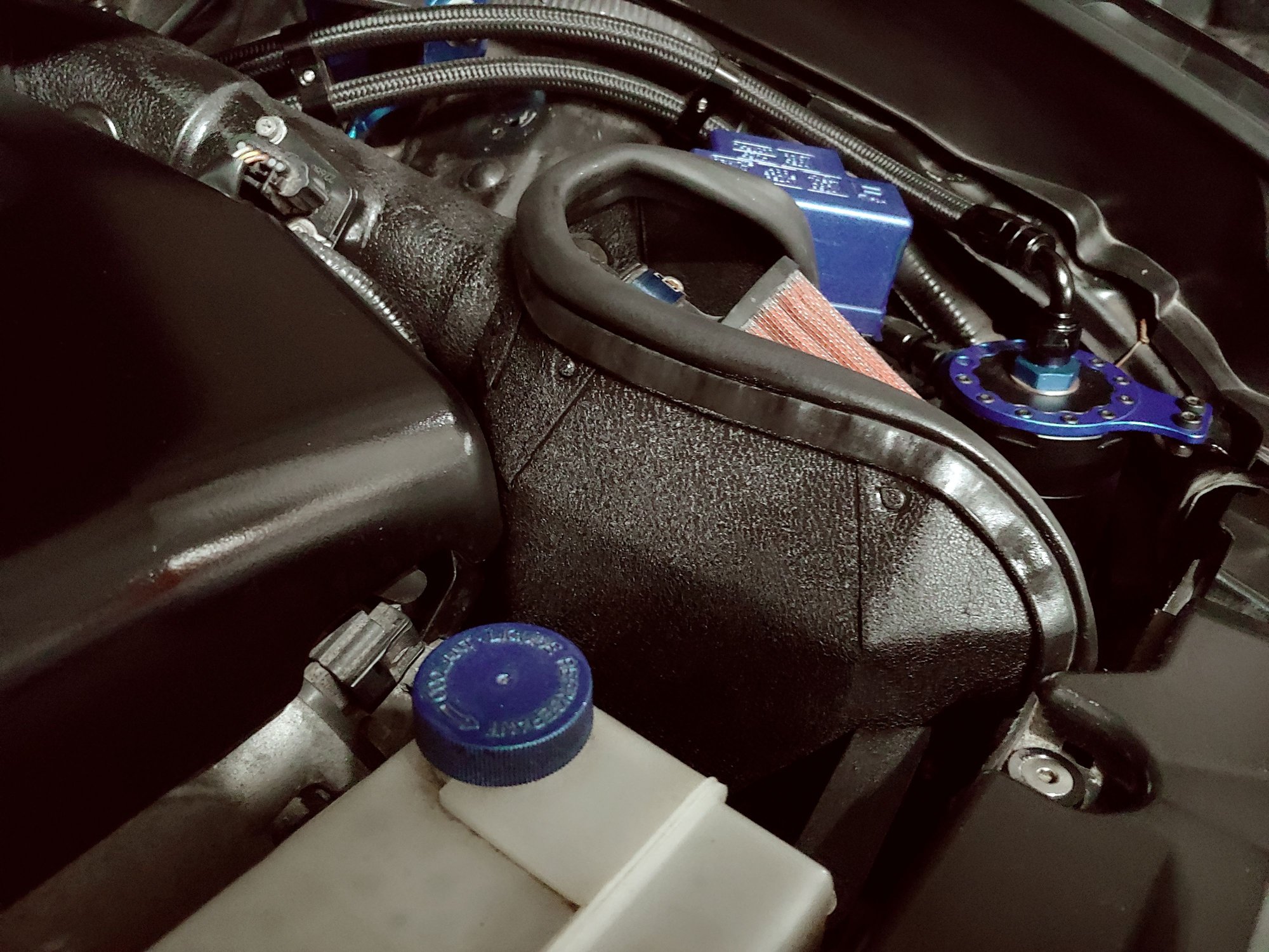

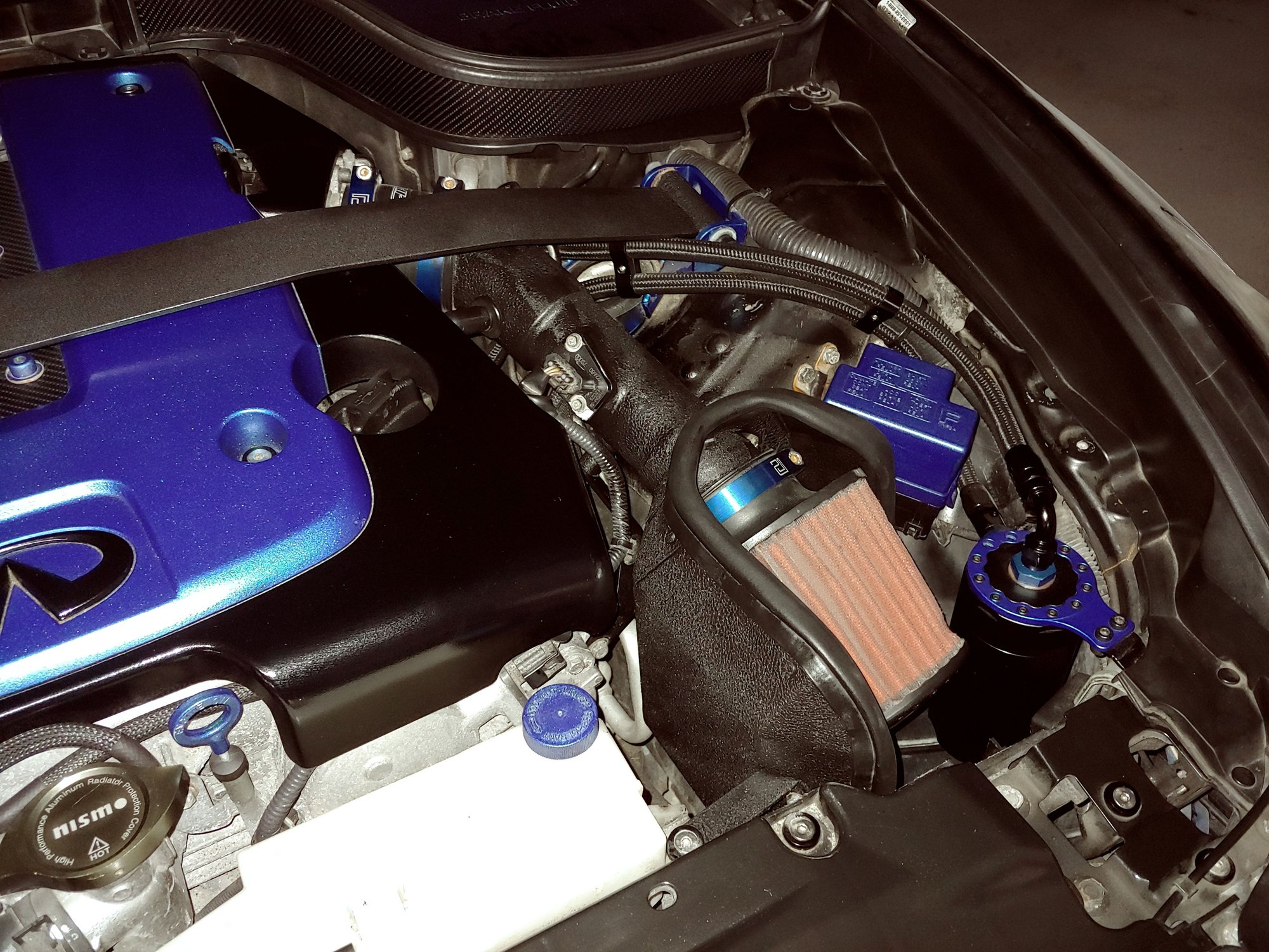

Got a better shot of the wrinkle finish. My DIY airboxes almost look aftermarket lol.

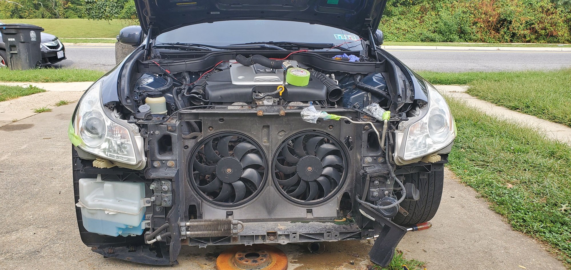

Slowly tearing the front end down so I can access the thermostat bolts that the previous owner totally effed up smh
What's your solution going to be?
Either get it welded by a buddy of mines (if he's skilled enough to do it) or jb weld or marieweld some studs in the holes and use nuts to secure the thermostat and some black rtv. Was thinking helicoil but the holes are really effed up so that's not an option. Someone also suggested to drill the holes deeper and then tap new threads and use longer bolts but I don't l know how deep I can go with doing irreparable damage.
If that fails I'll grab a new engine and install it myself over the next few weeks. I've done it before and it's pretty simple but just time consuming and my schedule doesn't really allow for that much free time unfortunately.
Sorry man. Keep us posted. Sending g good juju

For the thermostat bolt woes - if they're wallowed out enough that helicoils won't work, then see if you can have someone tig up the holes. You can drill and retap the added material. Or, go to larger bolts (and therefore larger helicoils) - if clearance is an issue go with allen-head bolts.
