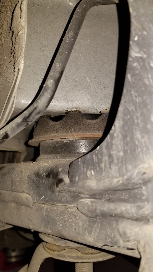

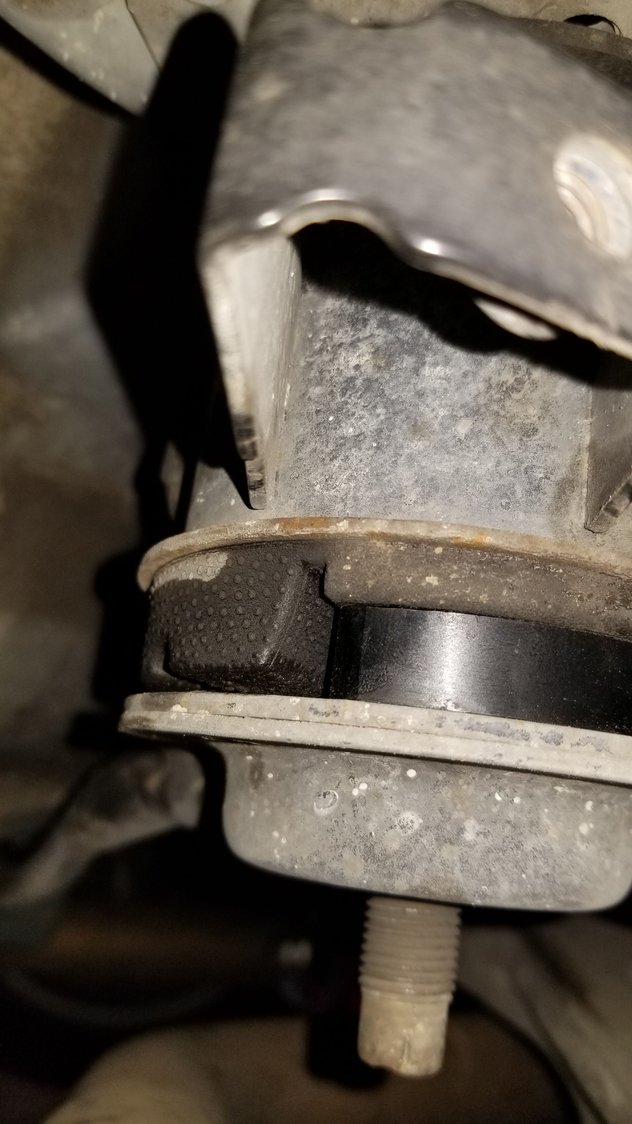

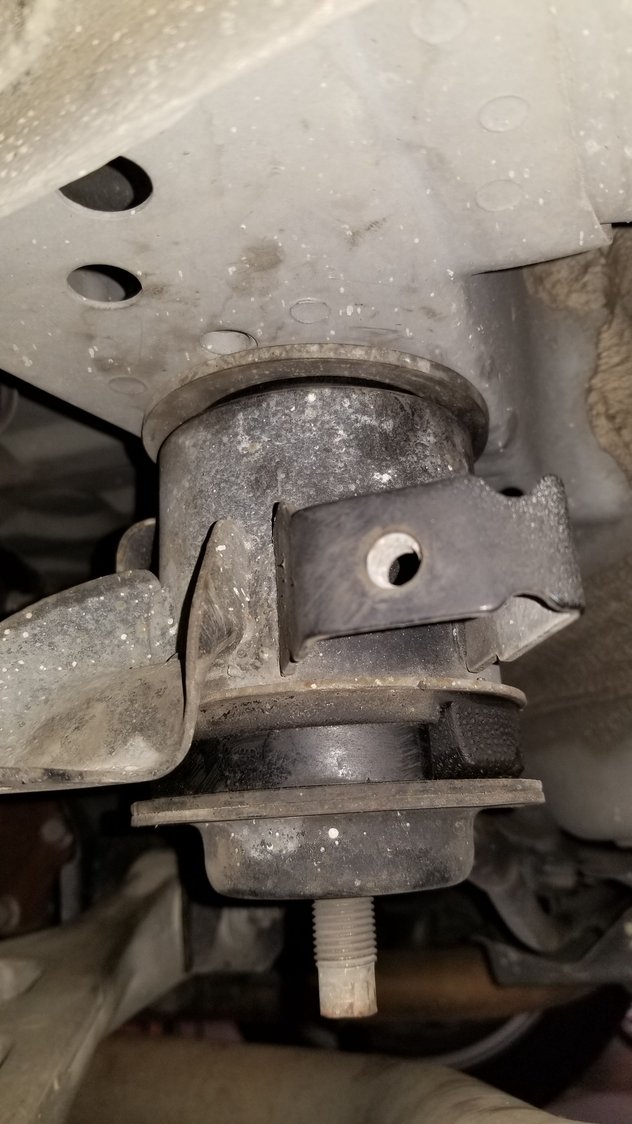

Originally Posted by projectpanda13
Question: Does the rear top collar protrude above the rubber bushing a bit, unlike the front collar? I thought it odd that the front collar sat flush with the rubber bushing and my top rears did not.
I had a lot of trouble with my rear bottom collar. I had to use jack and tube to get enough force to push it in.
Took these pictures for you

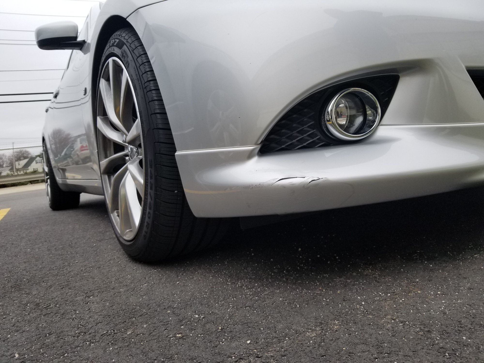

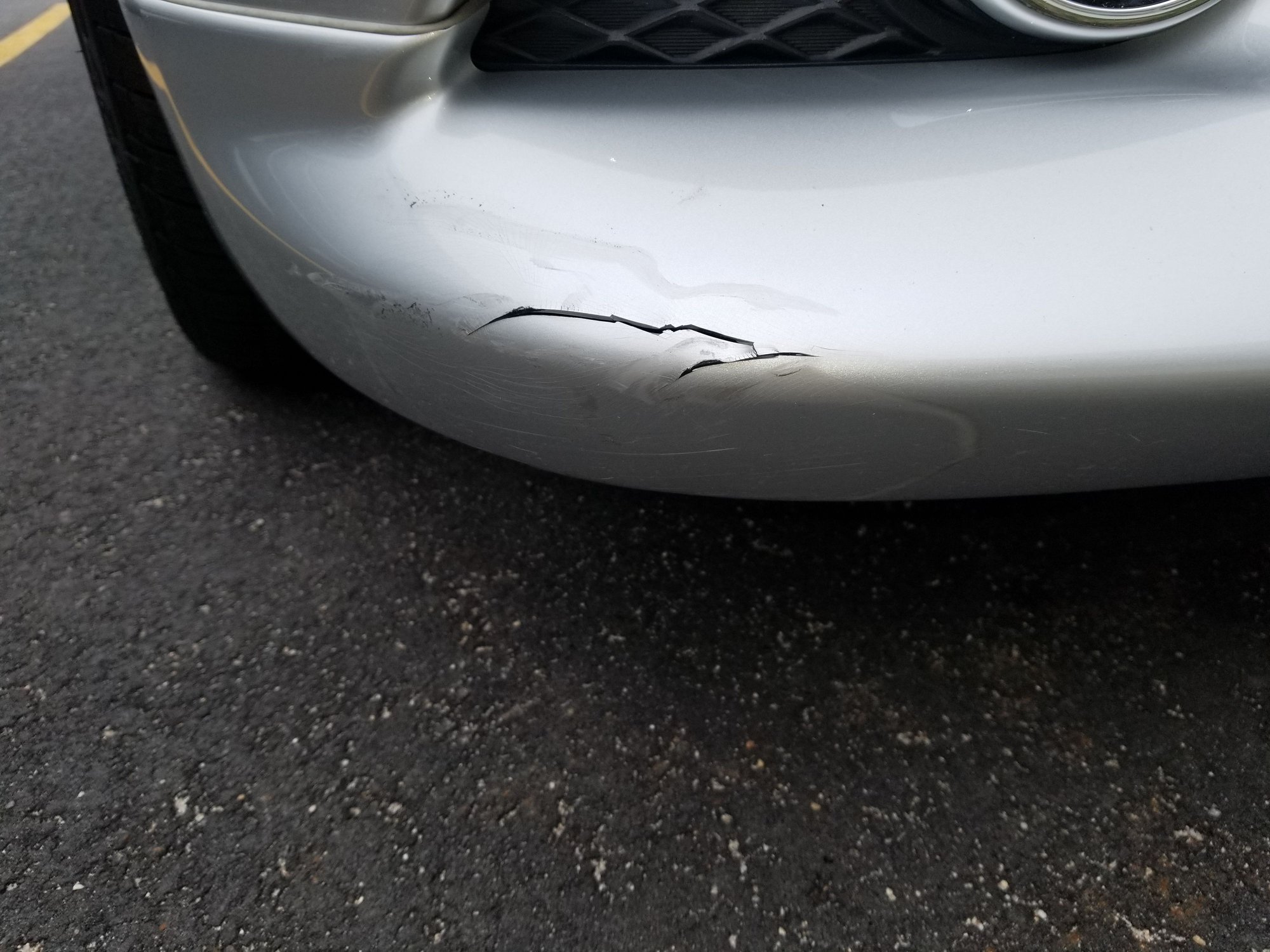

I did this today
Being I don't really have a scratch on this car yet... I've already ordered a replacement.
Putting this on was a breeze.
Anyone know what a pain removing the lip will be because of the double stick tape?

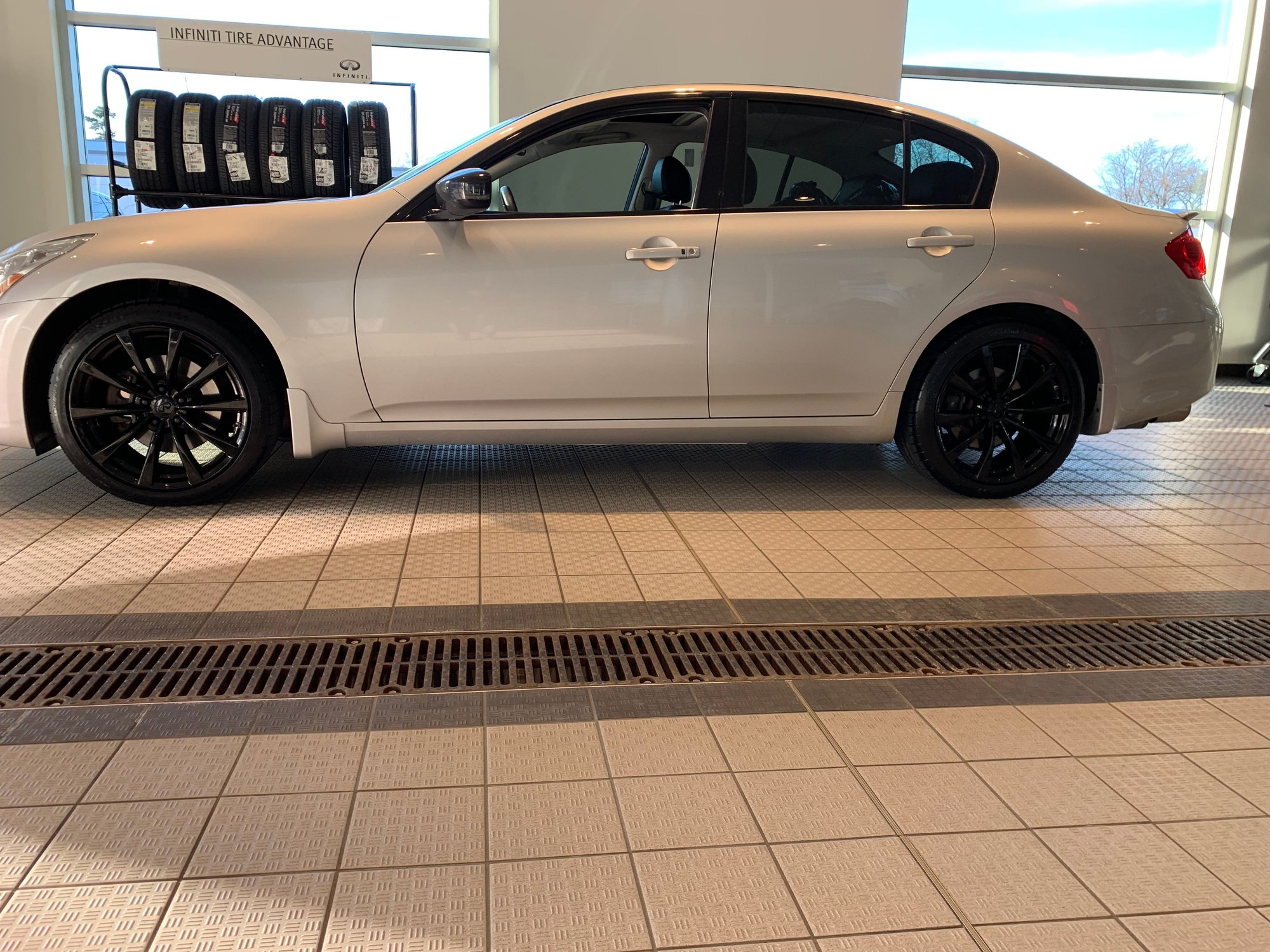

Got my coupe wheels installed with pilot super sports 245/40/19 all around and mud guards installed.
Swifts are next to take care of that wheel gap.

Ugh! Sorry about the damaged lip. Easiest way to remove it is with some fishing line (dental floss may work too). Heating it up slightly with a heat gun or hair dryer will also help speed up the process.

Excellent idea...fishing line. I expect there will be a lot of goo gone and picking off the tape afterwards.
Thanks for the feedback.
Got a free slightly damaged lip if anyone wants it. Like new otherwise.
