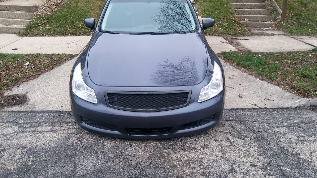

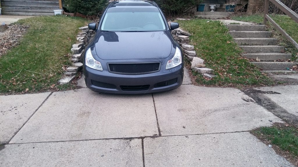

Rear fender will be cut with flares.
Just curious, but why did you choose such large diameter tires? The OEM "Sport Package" Bridgestone tires are 26.7" for the rear and 27" for the front, but the sizes you chose are around 28.7". That's around 2" larger in diameter over the OEM tires!
Well, there are a few reasons. A) I'm going to be running 3" Titanium Exhaust and I don't want to ruin it. B) I originally wanted 265/35/20 and 315/30/20 but that combo was hard to find in the brand tires I wanted. C) The pot holes around here are unreal. D) this is my drive way with only 1~" less clearance with NO lip.
IDK. I guess we'll have to see how they look. Maybe I'll regret it.

Just fair warning... Just as Slartibart mentioned, your stability/traction control (and possibly ABS too) are probably going to go nuts with tire diameters that far off from the OEM size. I was previously running 305/35R20's, which are about 28.4" diameter, and I couldn't keep my traction control from constantly intervening. It was so bad that I added a switch to the center control so I could completely disable it. I eventually switched to 305/30R20's, which at 27.2" are still slightly larger diameter than OEM, but I haven't had any issues since. It can be a little tricky when changing tire sizes on vehicles with modern electronics... But, who knows, maybe you'll get lucky and won't have any issues.
I can also almost guarantee that the front tires are going to rub like crazy. I'm not so much worried about the 275mm width (I'm running 265's without any rubbing), but that combined with a tire that is almost 2" larger in diameter your going to have very little clearance in your front fender wells when turned at full lock.

The front CF fenders are wider but it's probably half an inch at most, and really only due to the fact it doesn't have the lip along the fender.
You've convinced me. I honestly didn't think it would be such a big deal but now that I see them in person they do look a little nuts. Would be another thing if I wasn't lowered or something. I will exchange or sell them.
