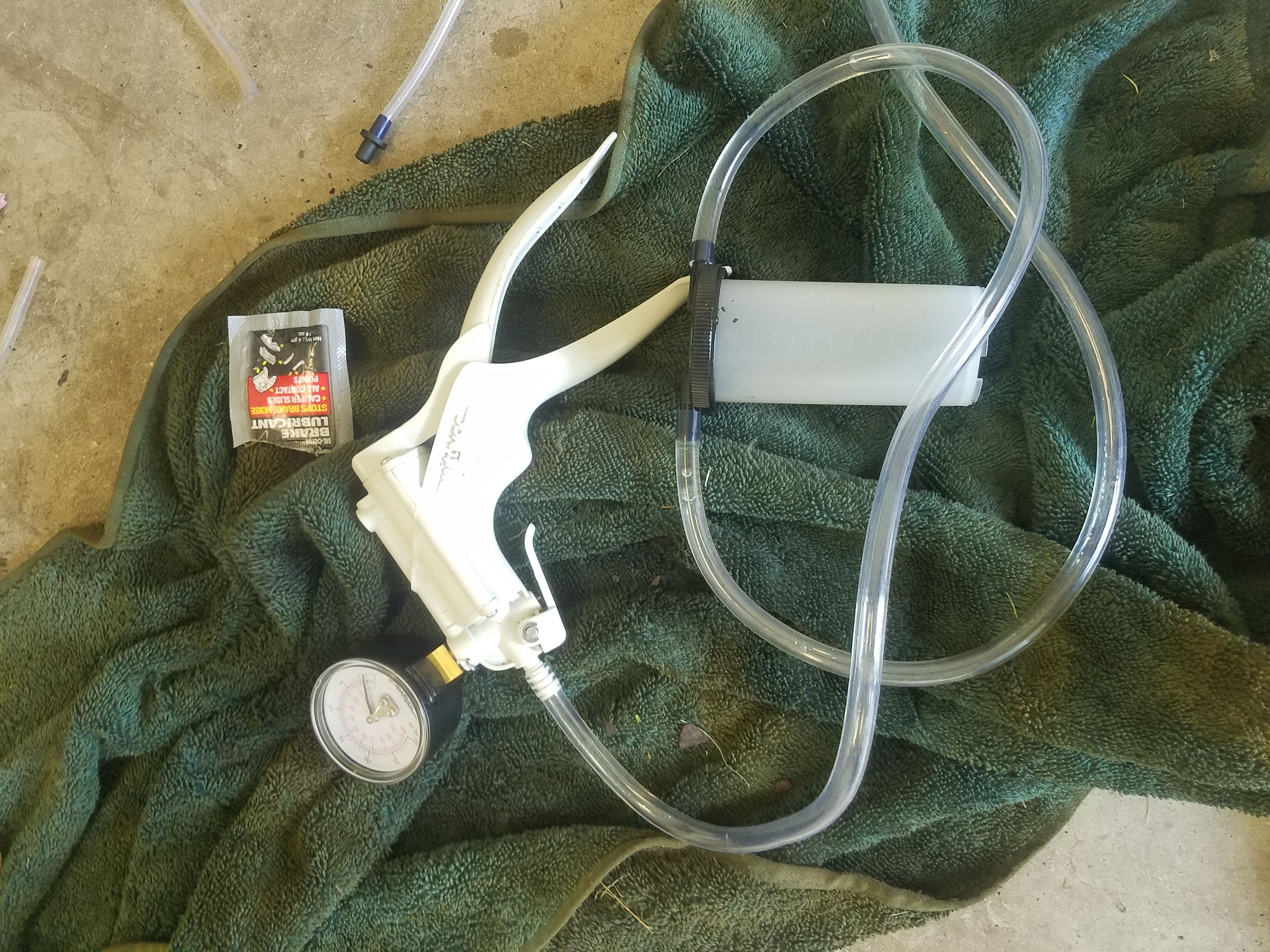

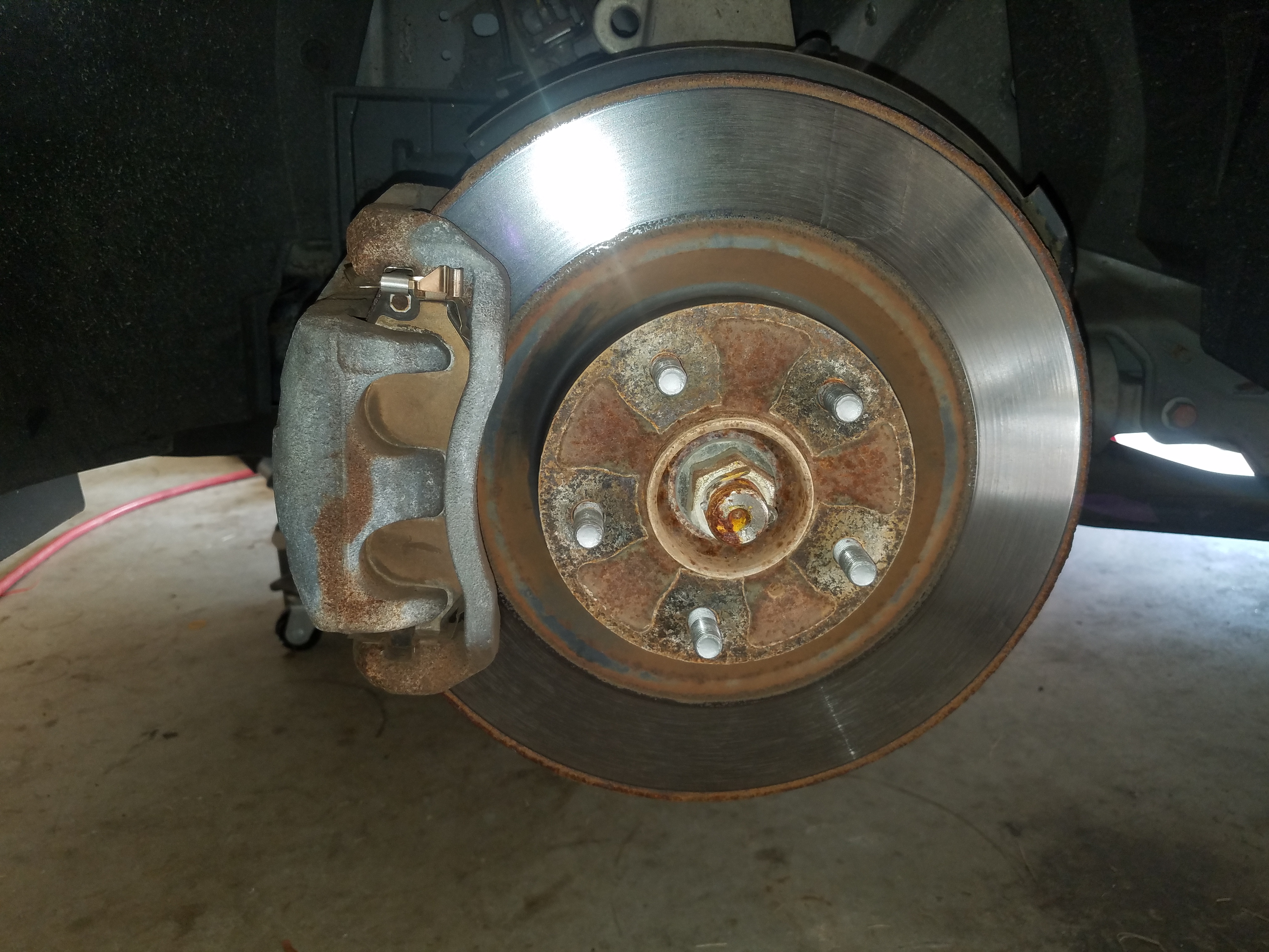

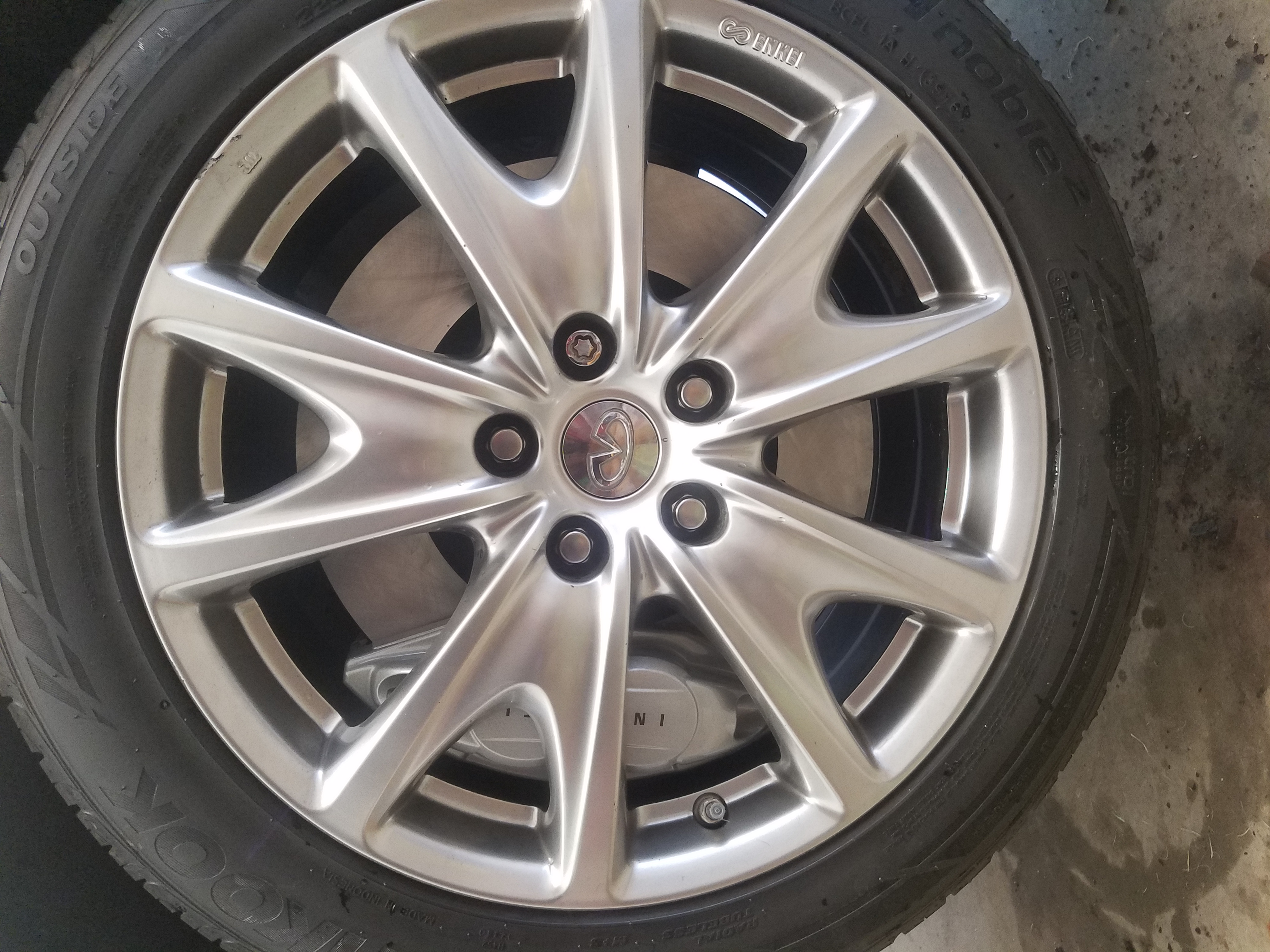

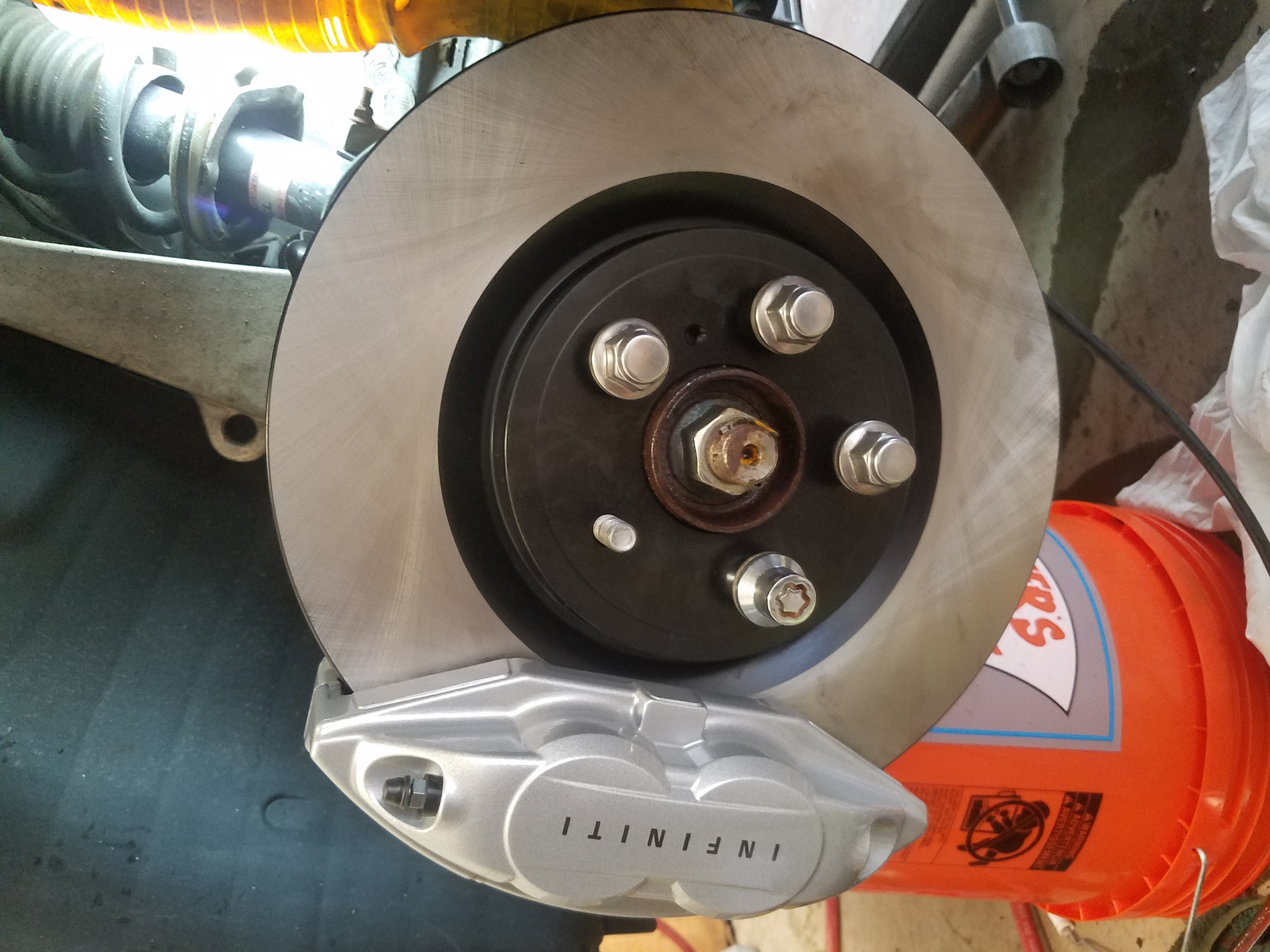

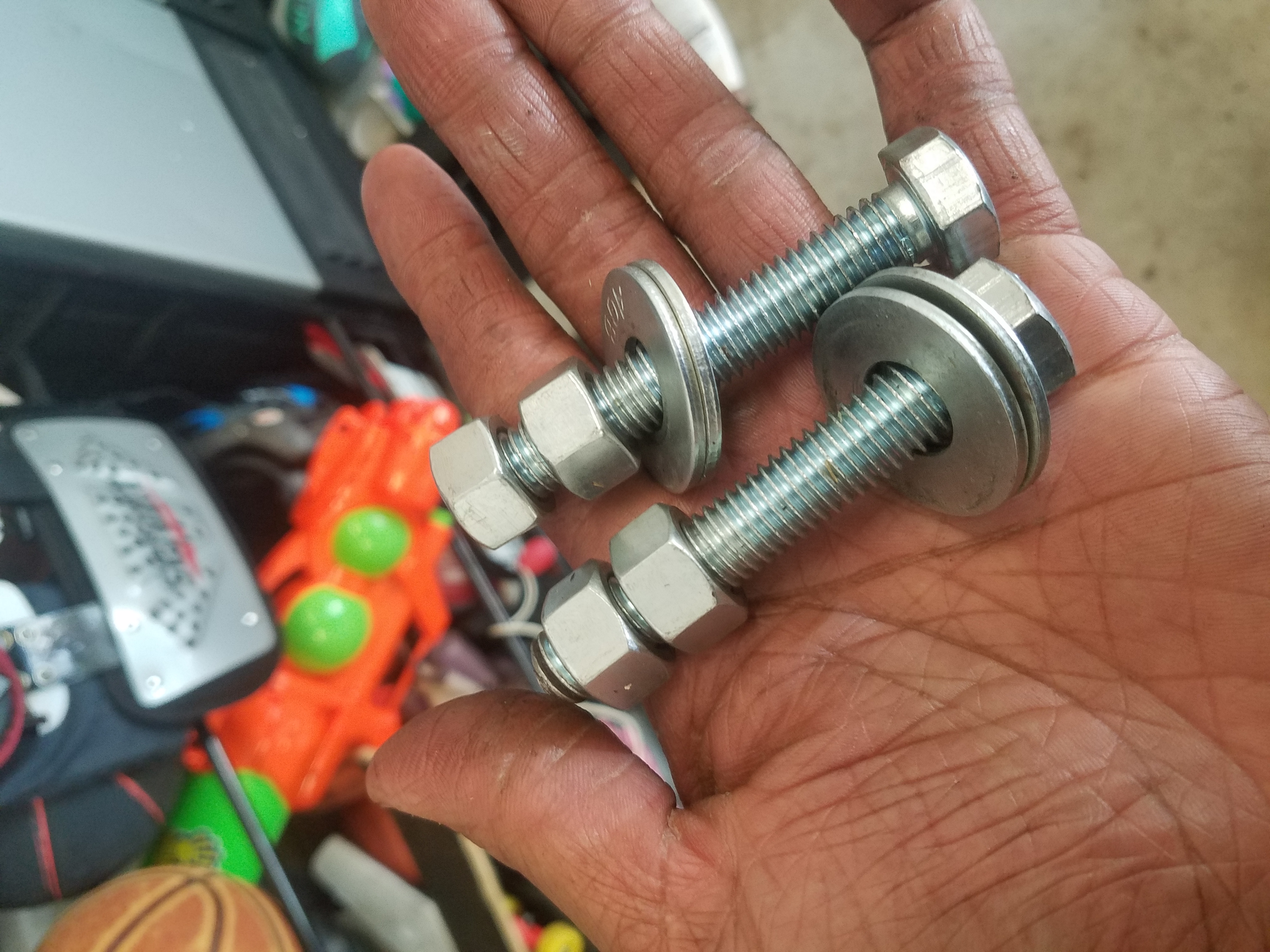

Phase 1 complete
First off I'd like to thank this site and YouTube for making this easy. Finally got the fronts on. I'm on a budget so I'll do the rears this fall or so. It was actually pretty easy, but I did have trouble getting the rusted, fused rotors off. But of course, YouTube to the rescue.
This worked like a champ without trying to beat the crap out of the rotor. The brake bleeder I got from Harbor Freight worked well also, when I finally got an airtight seal. It came with a lot of attachments I didn't need but maybe I'll use them one day. Sorry about the pics, they flipped on me.

Nice update, halfway there!^^^^

Has anyone investigated if the Akebono brakes use a different master cylinder? All those pistons might use more fluid than the standard brakes and proportioning might differ, too. Which could make piecemeal upgrades problematic.

There are two non-sport master cylinders -- D6010JK30A and D6010JK02D. The sport master cylinder is D6010JK02A. I have no idea what the differences are.

I tried to research this back when I was installing my Wilwood set, the biasing is the same but using the non-sport MC will result in a bit more pedal travel, I believe the braking performance was very similar however. I think it was from one of the Z sites that provided that info, but it's been a few years since I did that so ??? Also not sure what the differences are between the two different non-sport MCs. Possible that one is for the non-sport coupe, and another for the non-sport sedan since the front calipers are different for those sets (but they both use the same rear calipers).

I would assume the sport brake master cylinder to use a somewhat larger piston since there is more fluid to move and the larger piston would reduce pedal travel to some degree.
For those who don't know, for a given slave cylinder diameter, the smaller the master cylinder diameter the easier it is to move the slave though at expense of longer travel of the master.
