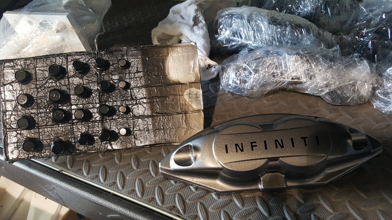

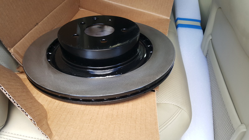

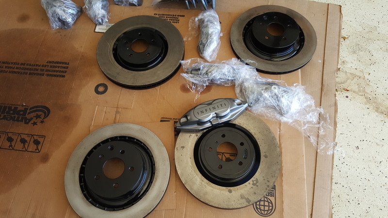

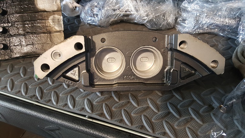

Caliper's look great! Thinking of having mine redone in Candy Apple Red to match the rest of my new suspension parts. Just curious, but did you pull the calipers apart yourself and then rebuild them afterwards?
Took them apart cleaned and re-did them, then re-assembled. Had the rotors done as well.

You're going to want to paint about 3/8 inch onto the surface of the rotor as well or you'll get a ring of rust where the brake pad doesn't hit the rotor.
I made the same mistake.
Relatively easy fix even if you have already installed them. I just sanded off the rust and applied some caliper paint with a small brush.

Interesting. Good to know. I'll have to keep that in mind and plan for that next time I am working on the sedan. Thanks for the heads up.
